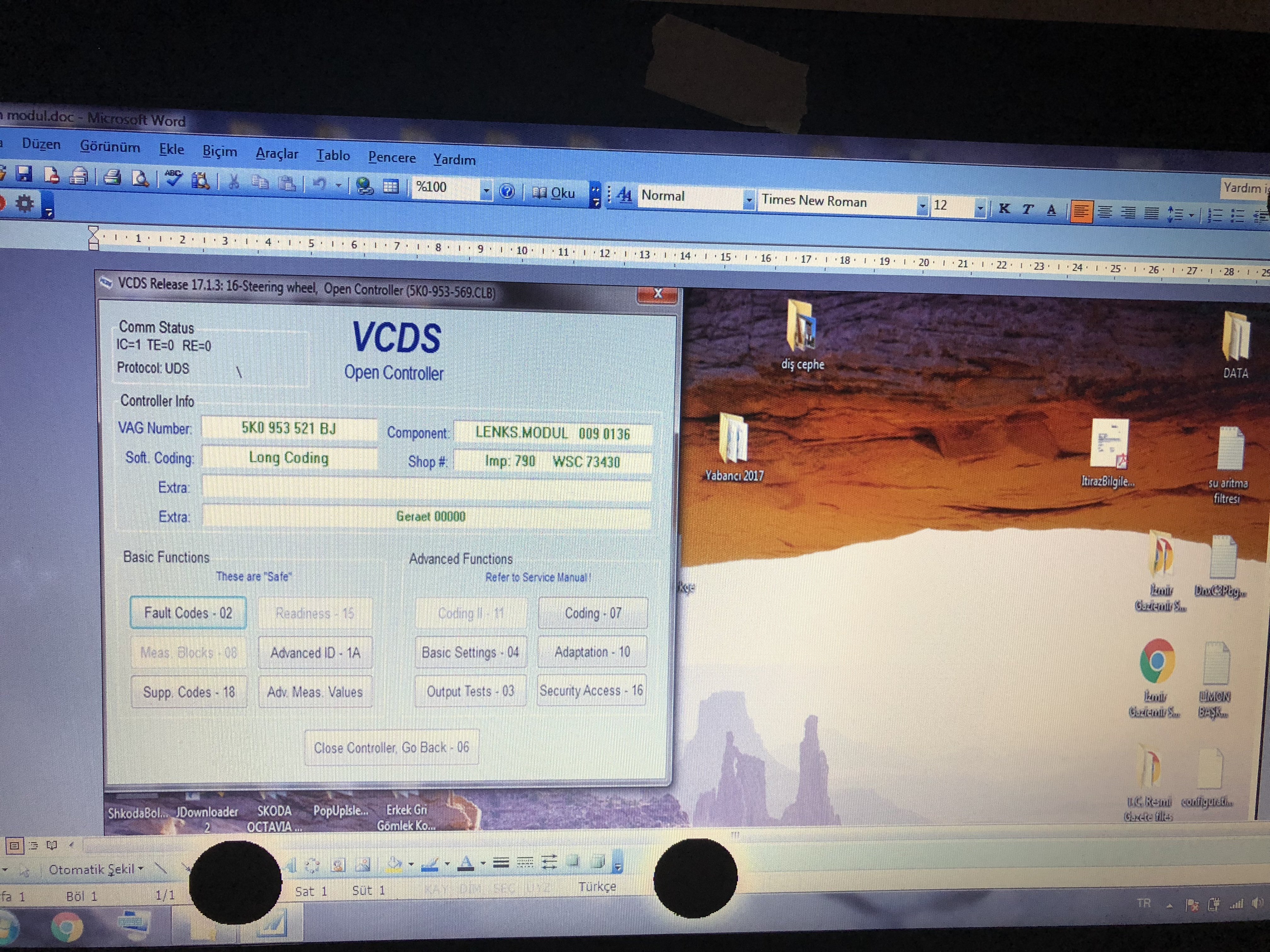

Hi. I m joing this forums a new. İ was buying 2011 model 1.6 tdi ambiante octavia a5. My engine number is Tmbct21z2b2046966 . My steering whell module part number is 5K0 953 569. But i dont understand how is assembling cruise controller. İ dont know which part number cruise controller and i dont know, i must remove steering whell module or i musn’t. How am I assembling cruise controller. Thanks everything. Have a good day

Thanks for everything. But i dont understand. My first topic, i was writing steering wheel part number: 5K0 953 569. This part number is true or false? İ dont understand
That is the part number of the steering wheel control module
It's software version 5K0 953 521 BJ probably running on hardware version 5K0 953 569 C just like the thread I posted.
For example your say my module is 5k0 953 569 C. I am searching http://wiki.ross-tech.com/wiki/index.php/Steering_Wheel_Control_Module_Versions this web site and this module cruise control function is on. İf i will change my signal controller to new cruise controller ( P/N: 1K0953513A), will my cruise control open? Or i dont know, what is my steering module number ? Use vcds. Thanks everything
A VCDS autoscan shows both software and hardware versions.
I don't think that stalk 1K0 953 513 A is compatible with your steering controller, it'll be for older cars. Instead, you probably need 5K0 953 502 N 9B9 as mentioned in the thread I posted...
You may also need to add a wire if I remember correctly.
I believe the correct part number for the cruise control kit is either 3T0 035 623 or 3T0 035 623 A. It will also come with instructions: http://vwgolfr32.co.uk/3T0035623A.pdf

I was searching true part number. i found it. My retrofit part number is 3T0 035 623 A or 5K0 953 502 M. Skoda is using 3T0 035 623 A number. Vw, audi, seat are using 5K0 953 502 M. Thank you everything.
