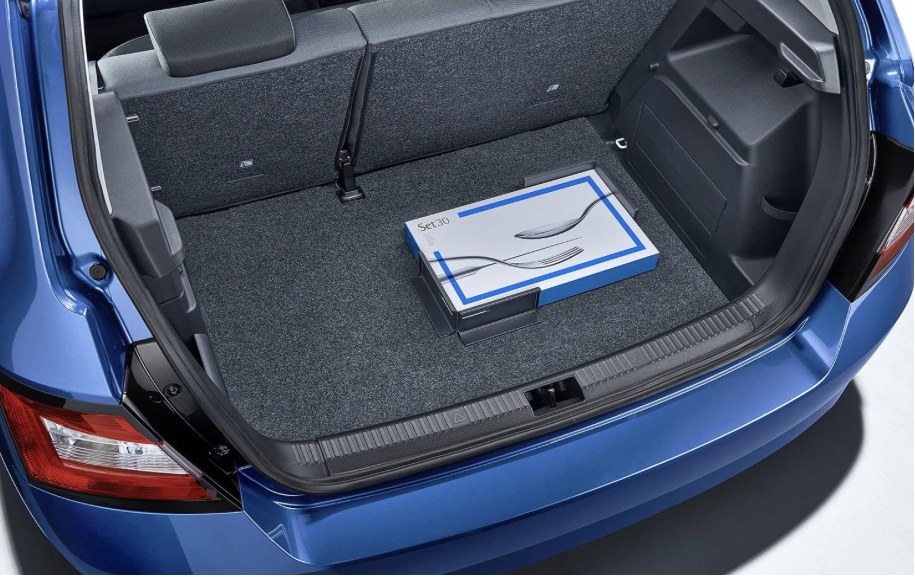

The “cargo elements” are flat plastic strips, hinged in the middle, with velcro along one long edge.  They can be folded to make two “corners”, so you can, for example, put them at the corners of a box in the boot, and stop it sliding around.

As above the cargo elements are handy for stopping things sliding around in the boot.
Those velcro Ls are yet another super-cool little function from Skoda! Not for me though as I use a boot mat.

Those cargo elements are the one thing that's stopping me from buying a boot mat, I find them extremely useful.
The Skoda boot mat is doubled sided plastic one side carpet on other side to which these elements stick.
