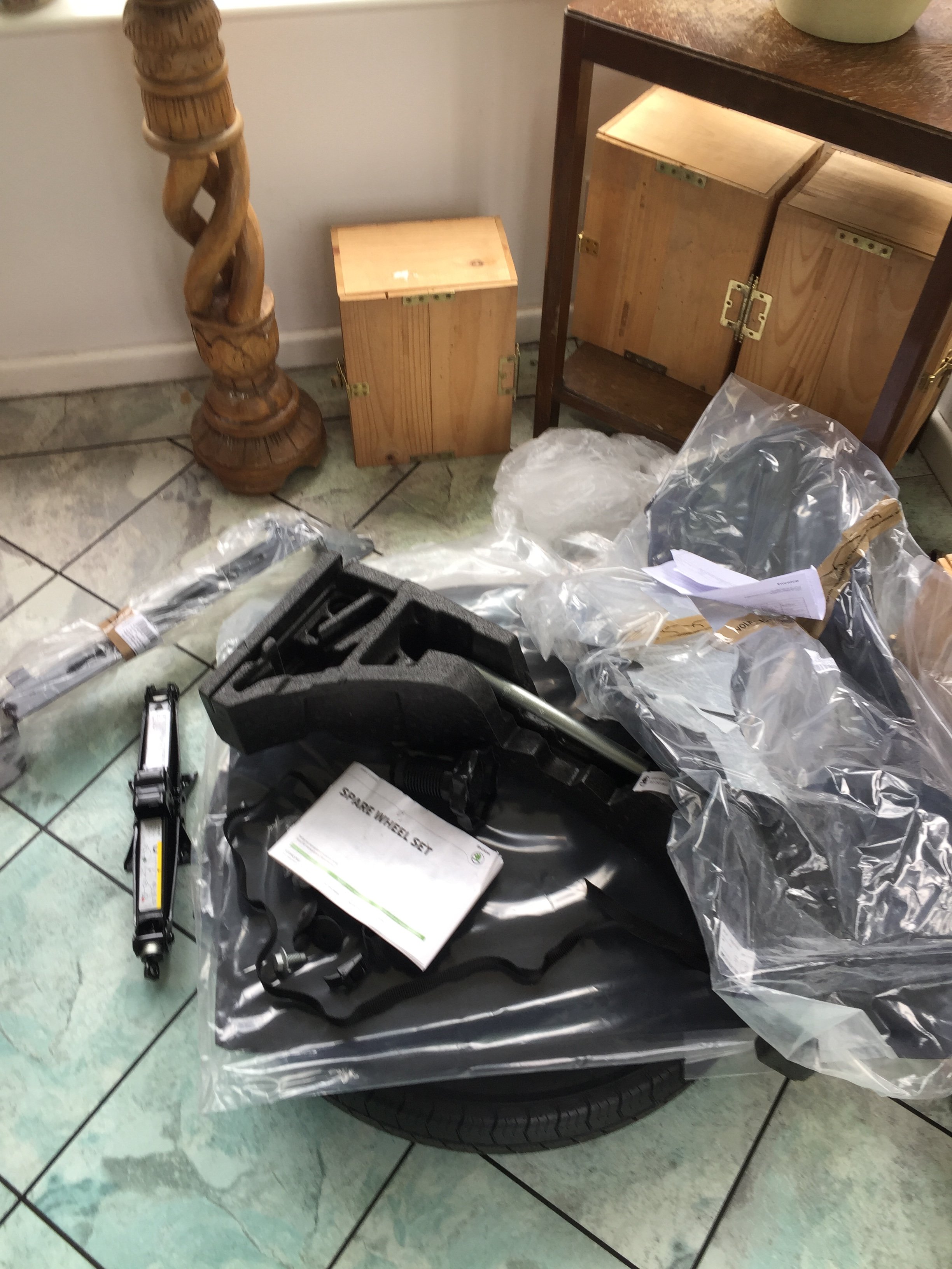

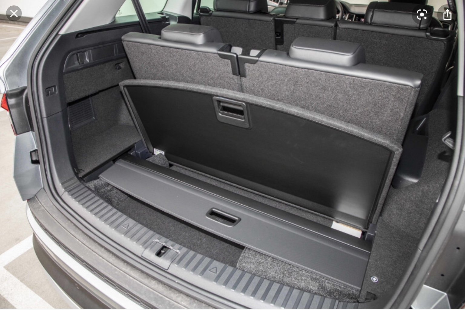

Yes you can get a spare wheel kit for the 7 seater. It was only around £100 when I picked it as an option but is more expensive as an aftermarket kit. The 3rd row seats lift up on little gas struts and the wheel fits under there and the tools, jack etc fit under the reversible  false floor section.

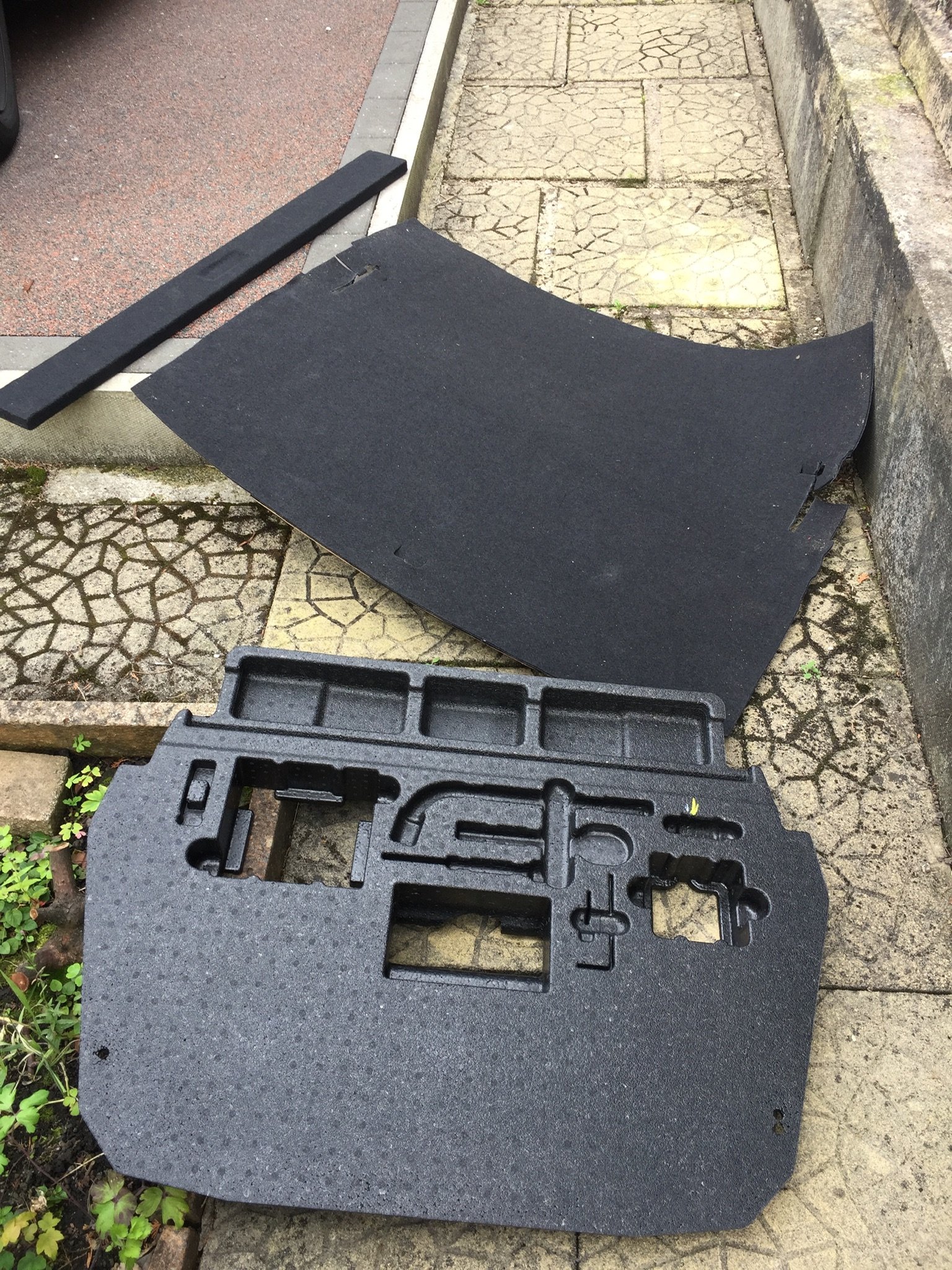

Fitted the space saver wheel today, pretty straight forward really.
I’m not sure what to with the redundant bits though. 🤔

Is that step between the folded 3rd row and the lip permanent or can the section of false floor that slots in their normally still be used to give a flat load space?
Could you share any more pictures or a quick write up?
thank you!
thank you!
There should be a double sided section ( rubber/ plastic on one side carpet on other) that fits in there.
As Kenny says, I took the photo before I fitted the final double sided section (the big bit sticking up in Kenny’s picture) that makes the whole floor flat.

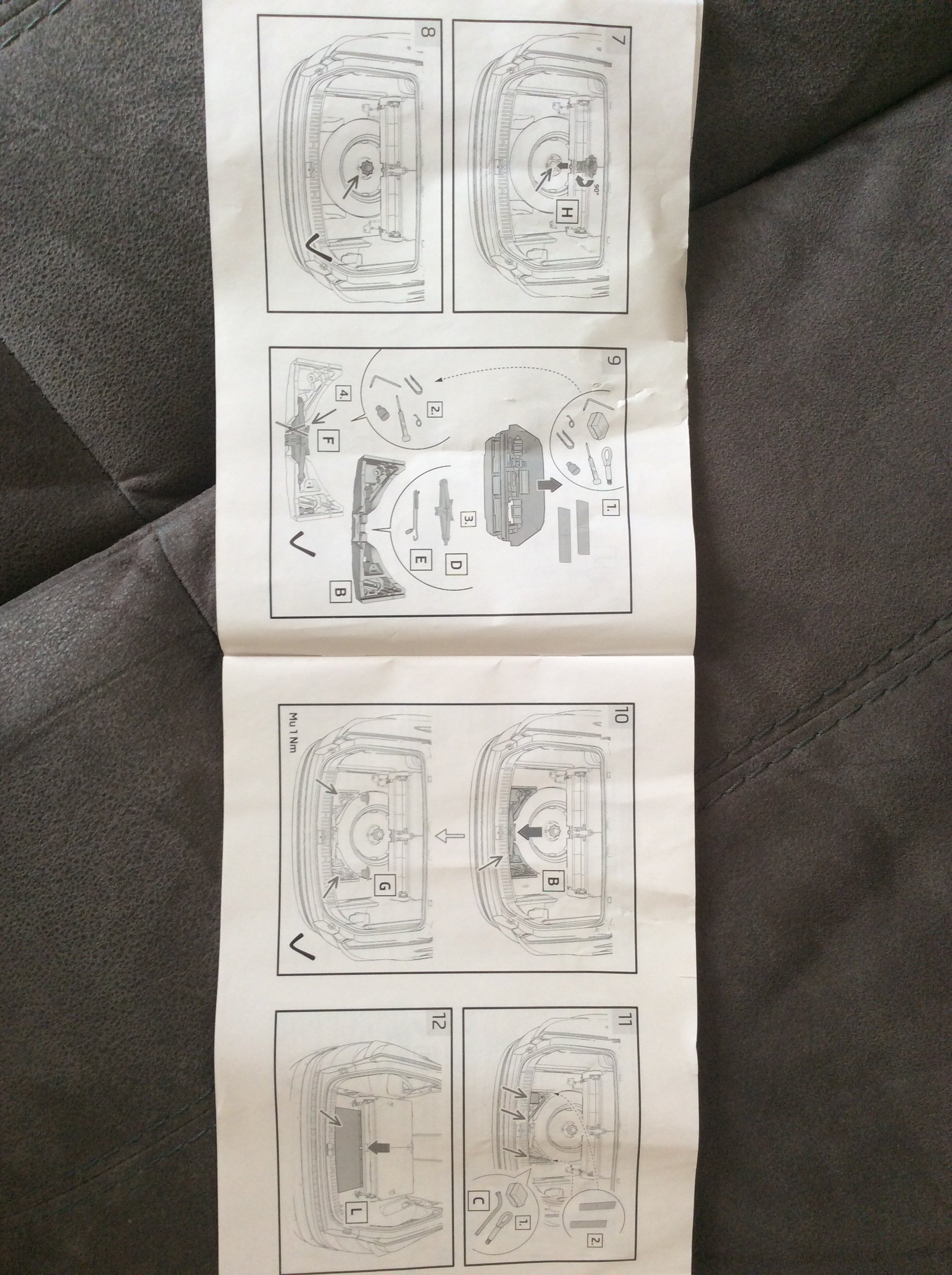

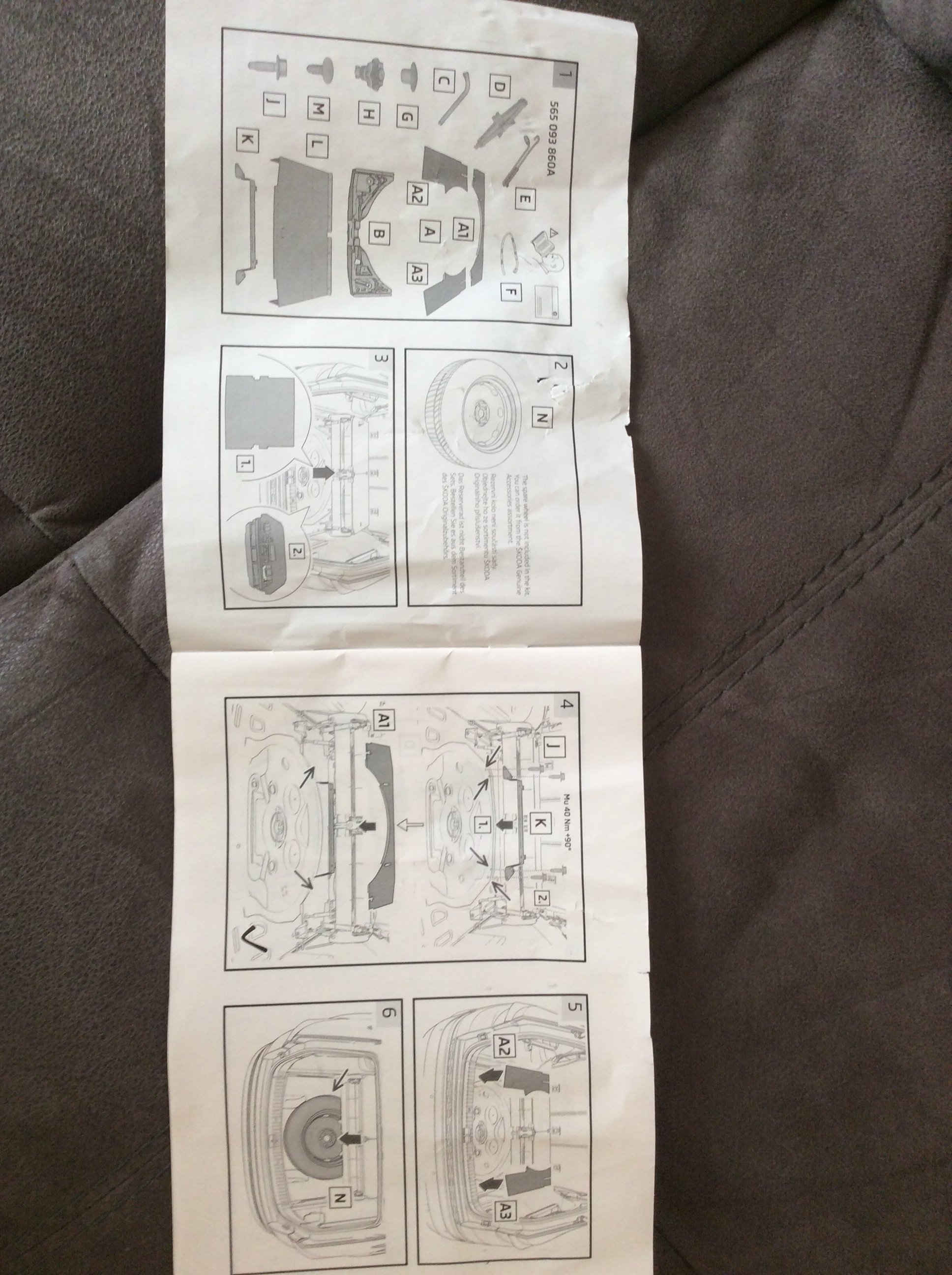

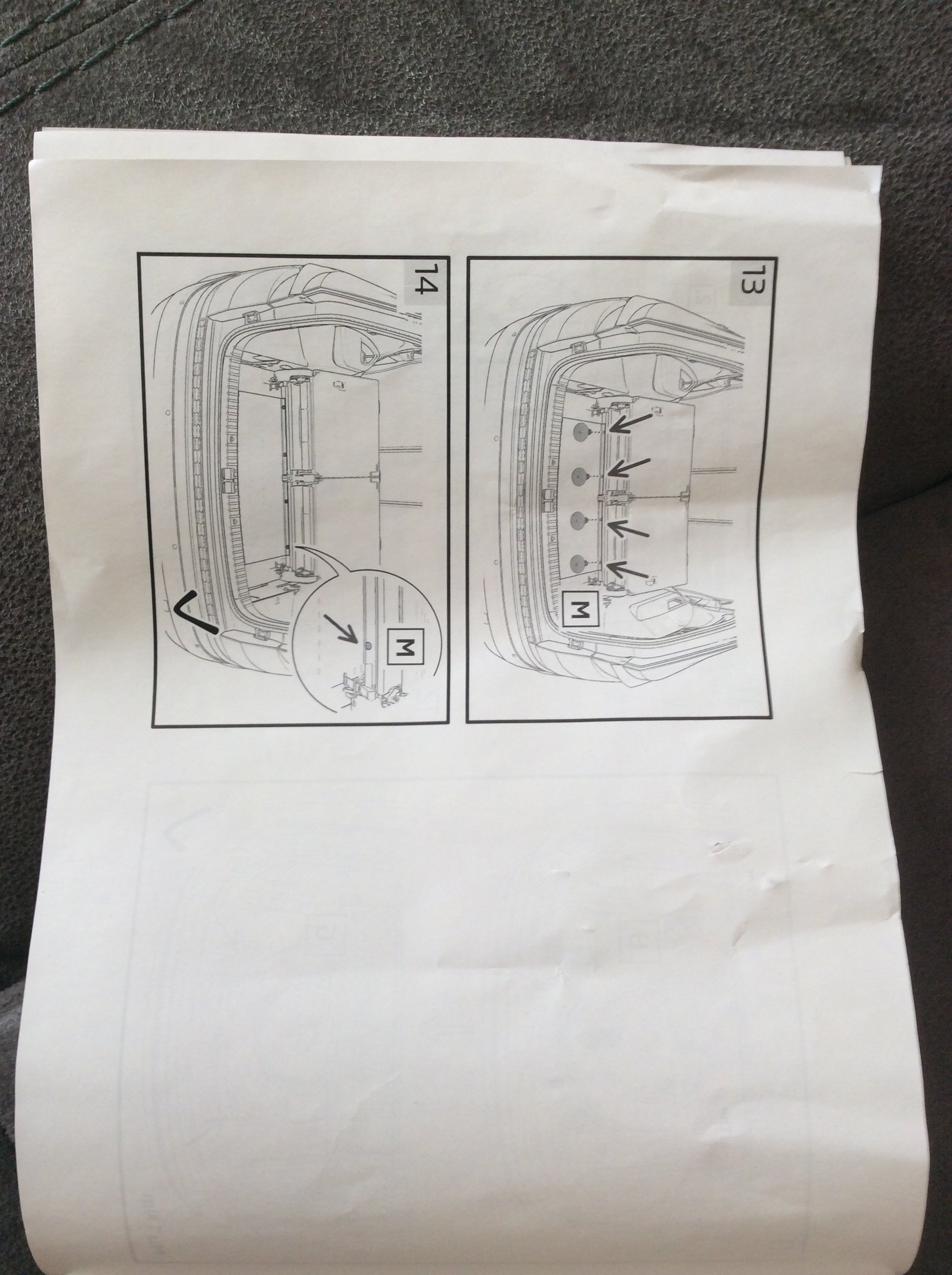

I think I still have the instructions in my garage, I’ll take a photo of them if I have.
Cheers, I assume the double sided section is the one that is original to the car?
Yes 👍
Cool. Got one ordered and it's being delivered tomorrow!
Here you go.
