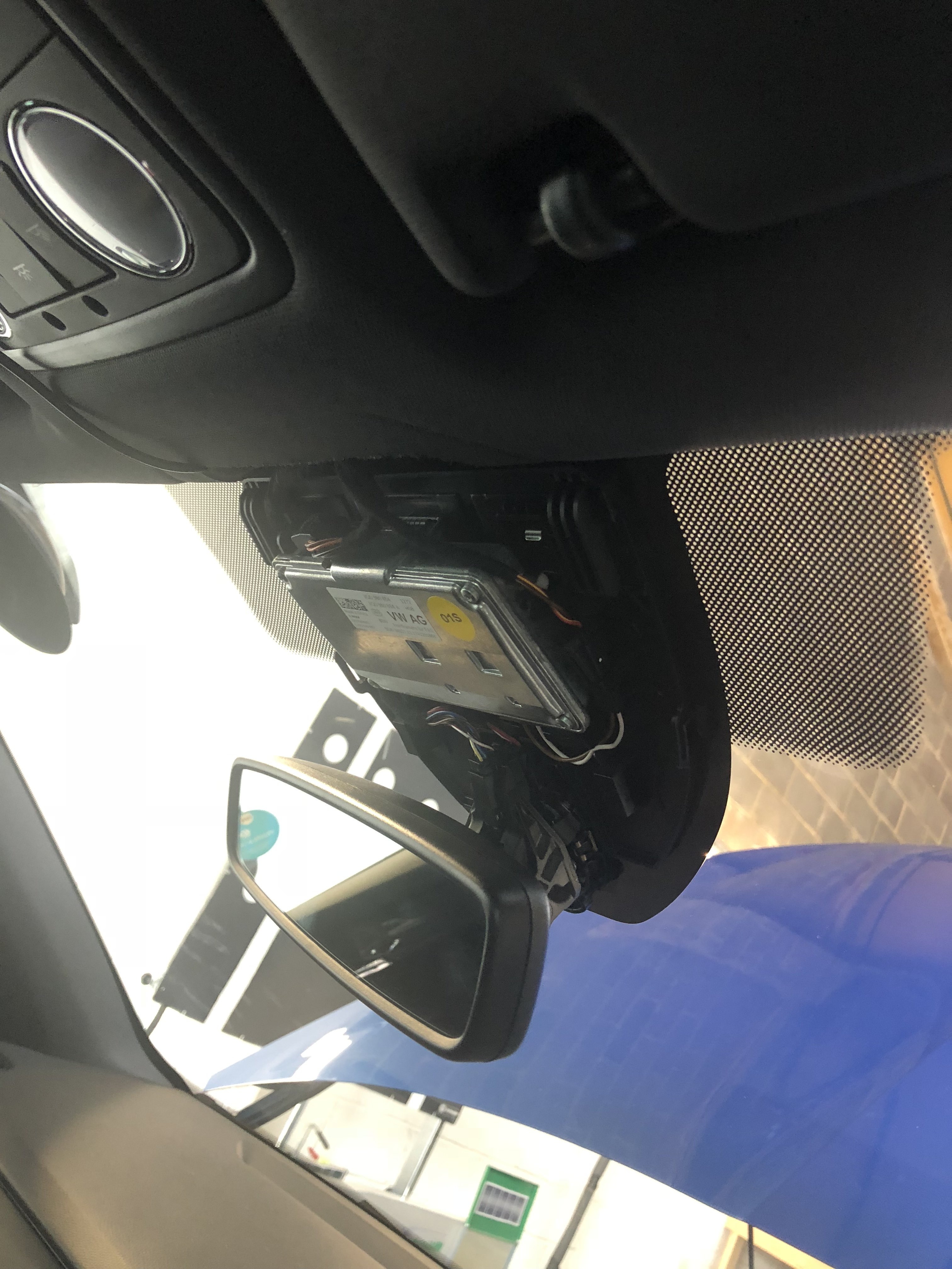

Having the Windscreen replaced in the vRS today at Autoglass Nottingham. Here are a few pics of the insides!
https://imgur.com/gallery/a80YdYz
Edited by KevC_Derby
Link to imgur added and photos removed as exceeded 10mb.
Home now and excellent service from Autoglass. Fitted a Skoda branded St Gobain screen and all calibrated and tested in under 90 minutes.
One more photo showing the installation behind the Interior Mirror before the trim was reinstalled.
Brilliant Kev. Very much appreciated. The camera looks different from my 15 model. Do you have rain sensing wipers, headlight assist and or lane assist? I wonder if just light sensor for rearview mirror and auto-headlights.
Are the brackets metal springs around plastic lugs stuck to the screen?

Yes, I have rain sensing wipers, HBA and Lane departure.

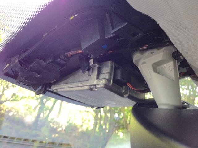

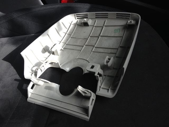

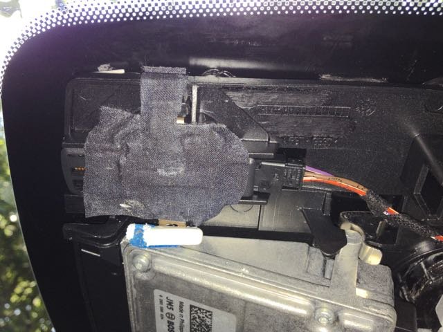

Their technician Tim was absolutely brilliant. I asked him to remove the trim to show me the problem. He quickly found the sensor had two metal spring clips which would quite readily ping off the plastic bracket. The plastic bracket is glued to the inside of the windscreen and can be ordered/replaced so a change of windscreen is not needed. The plastic brackets are on back order so for now the sensor was reattached and very adhesive cloth tape over the top to help keep it attached.  The plastic bracket does also hold the 'lane assist' camera so it will need recalibrating if changed (£200+ ?).
To remove the trim behind the rearview mirror you prise off the small inner panel above the mirror stem and then the main section easily slides down the windscreen. Removing the small panel is hard. There are two locating pegs up towards the windscreen but either side you needs to push a blade into the gap to push clip out (see photos). I think thats the method.
In the end it was all resolved within an hour by a good pragmatic technician - worth his weight in gold.
4 photos attached - as you can see the sensor is now covered by adhesive cloth tape and plastic wedge.
