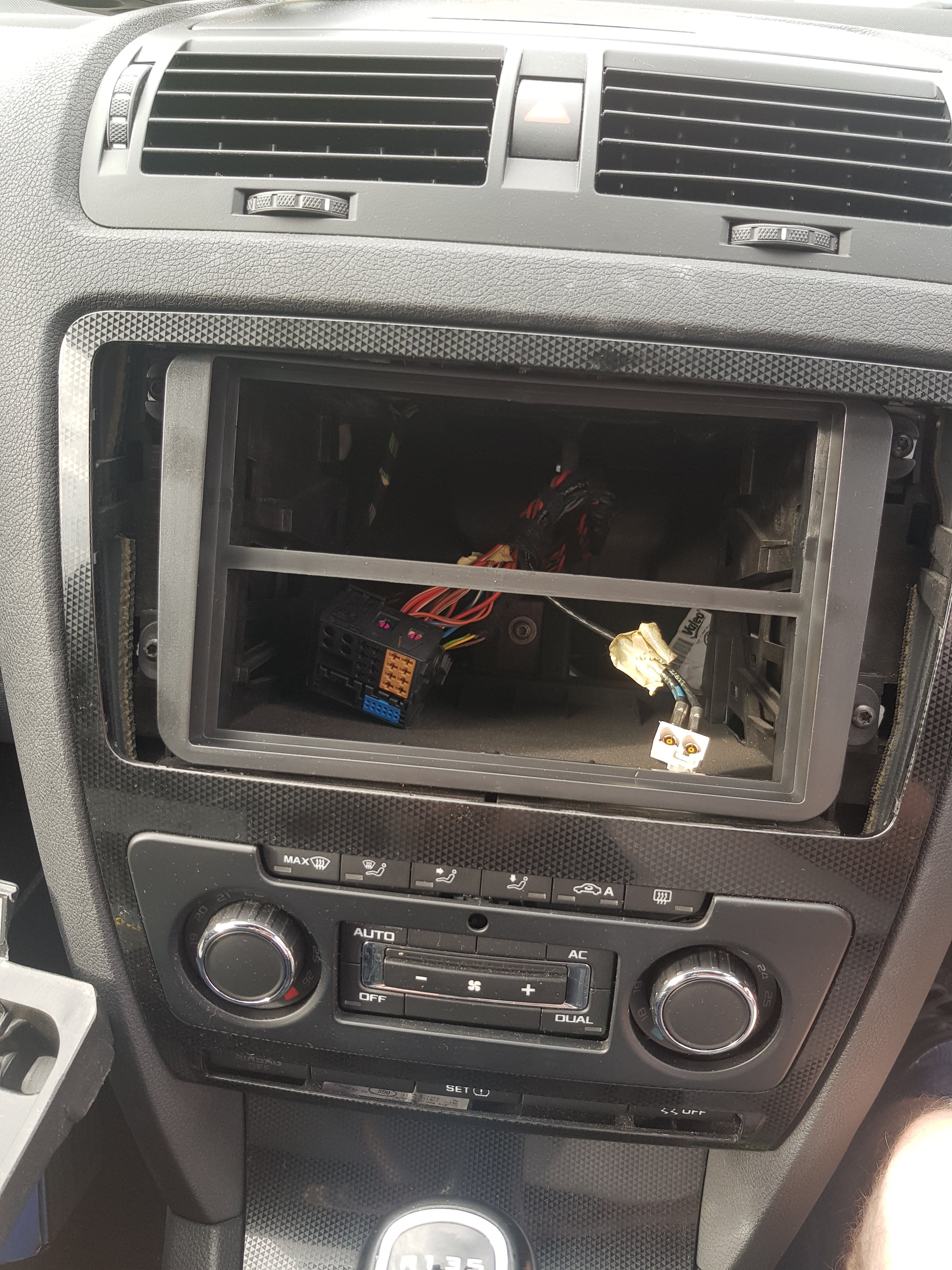

Hi I have a 2012 Octavia vrs and just bought the single din fascia from Halfords but once fitted I'm left with maybe an inch gap either side where the plastic trim doesn't cover or have they gave me the wrong fascia

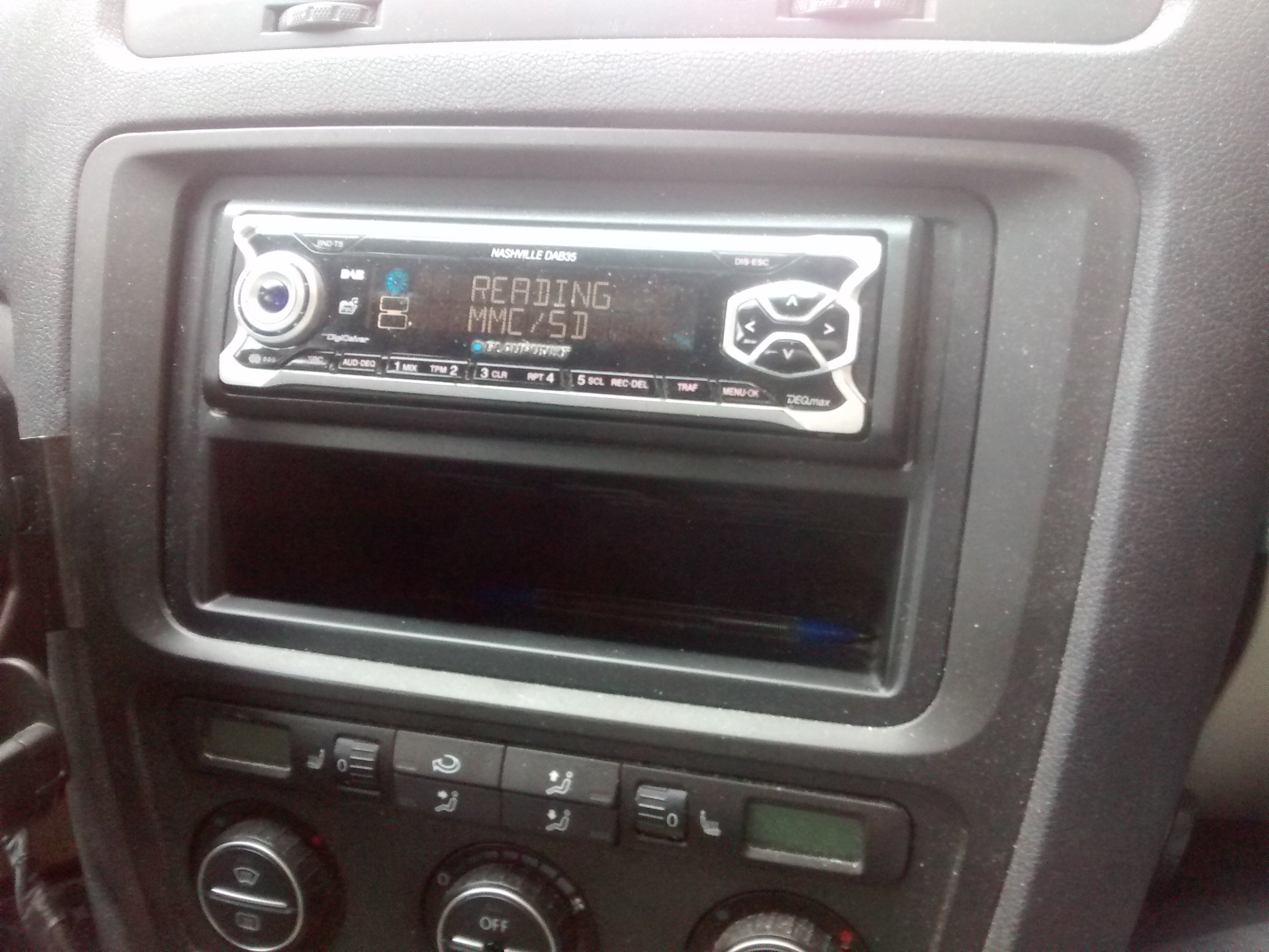

Doesn't look right, as this is what a proper kit should look like

Looks like the one you bought fits the Columbus sized surround, so you could either buy the Columbus surround or a different single DIN adapter - something like this: (just a guess)

IIRC this is what I bought for mine, not a perfect fit but close enough. You may need to find a quadlock adaptor and single din cage. I bought mine as a kit which I think cost me just under £30 at the time and had everything I needed (Was a Connects2 kit).

Managed to get one to fit needed the one for a pfl model for some strange reason, now just need to figure out how to get radio to turn off when I remove the key
