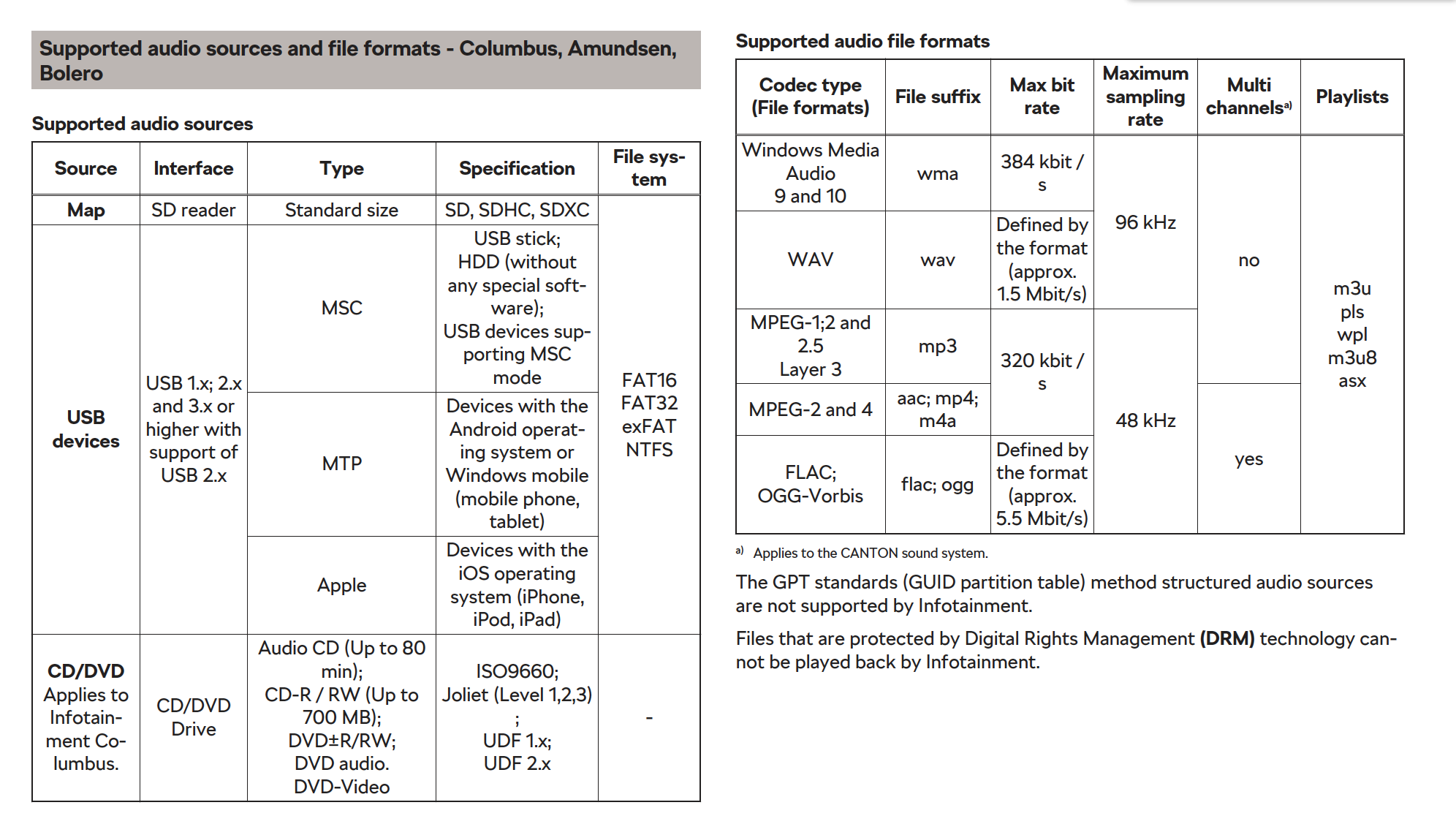

according to the online manual these are the types of files you can play, it mentions FLAC but I've not heard about it before maybe this will help you536156870_ScreenShot2018-08-12at19_48_04.thumb.png.59ecf2742dfd28cc31ffd764fca46b29.png
Yes....should play...but doesn't.  The dealer tried the showroom Karoq Edition but also had no success.
