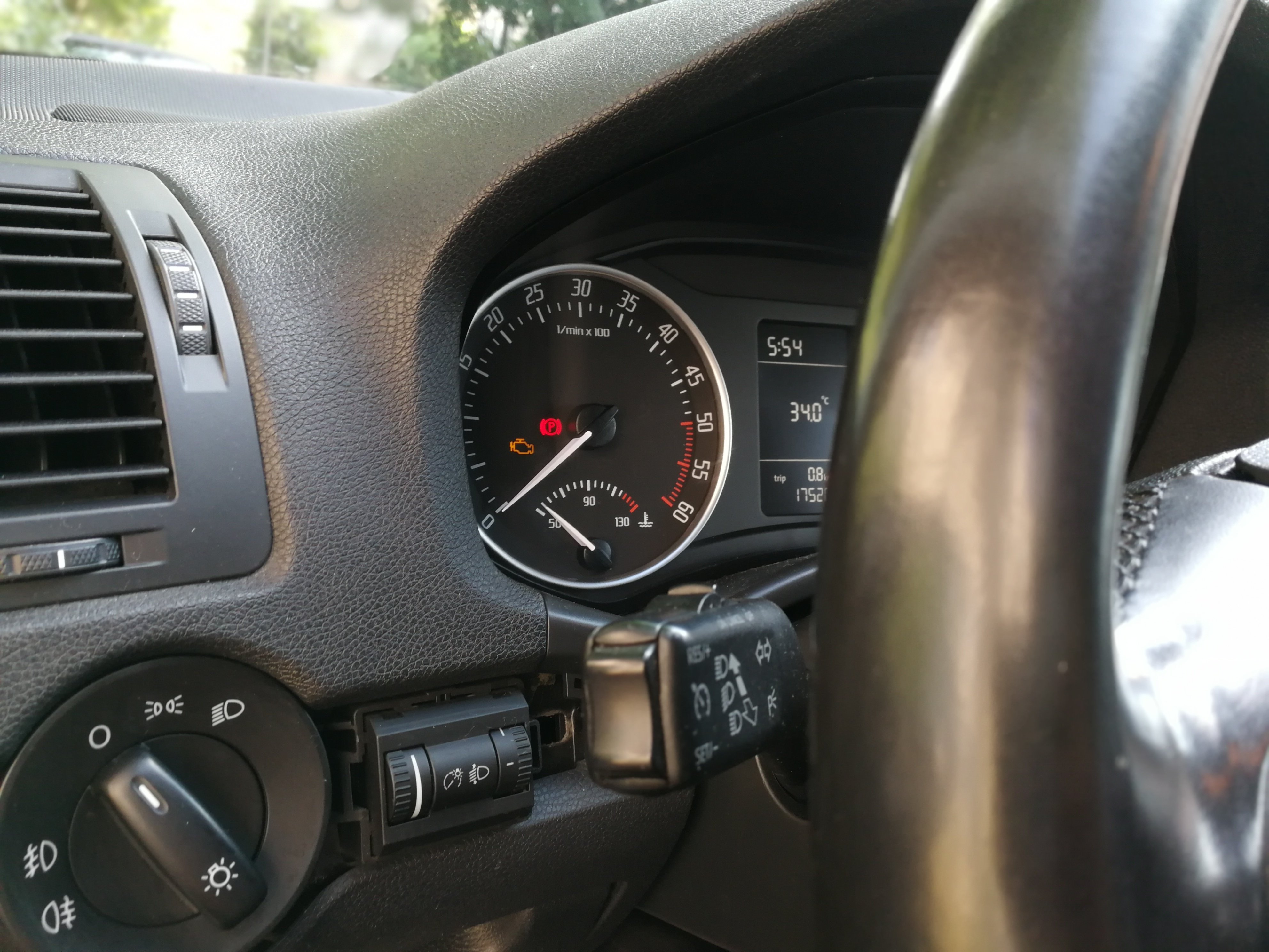

Button on the lapms is working, for setting trip mileage, hour etc. Button for the tempomat is also working, yet i am not able to scroll trough the menu of the bord computer like below.
Any ideea what to check, fuses are OK, no issues on tester.
1st thing is to confirm which spec instrument cluster you have. The one shown is called the maxidot and was a cost option on most cars. Can you post a picture of your instrument cluster?
No

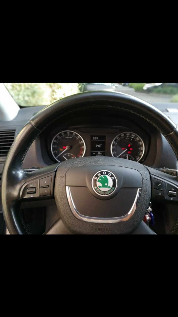

Your instrument cluster is not a maxidot like in the video that you have posted and it looks like your car has been retro fitted with a multi-function steering wheel. This will not operate the standard trip computer that you have. You need a wiper stalk with the switch in the end to allow you to scroll through the different read outs.

OK, looking through the spec list from the link above it appears that your steering wheel is factory fit and you have the standard trip computer. Does the thumb wheel on the right scroll through the trip computer options?

i have no ideea if somebody replaced the clocks. the scroll button on the right part of the steering wheel does nothing
I have fiddled with the buttons on the right. Apparently the phone button works as i managed to connect the smartphone to the blootooth and also was able to end a call. Nothing appeared on the clocks unfortunately, like the pin to pair the skoda and the phone or anything.

There is no investigation needed...
You haven't got a maxidot cluster fitted so the buttons on the right hand side won't work with it and it cannot display the menus you showed earlier.
The only fix is to replace the cluster with a maxidot cluster and have the immobiliser and mileage matched by an autolocksmith.
