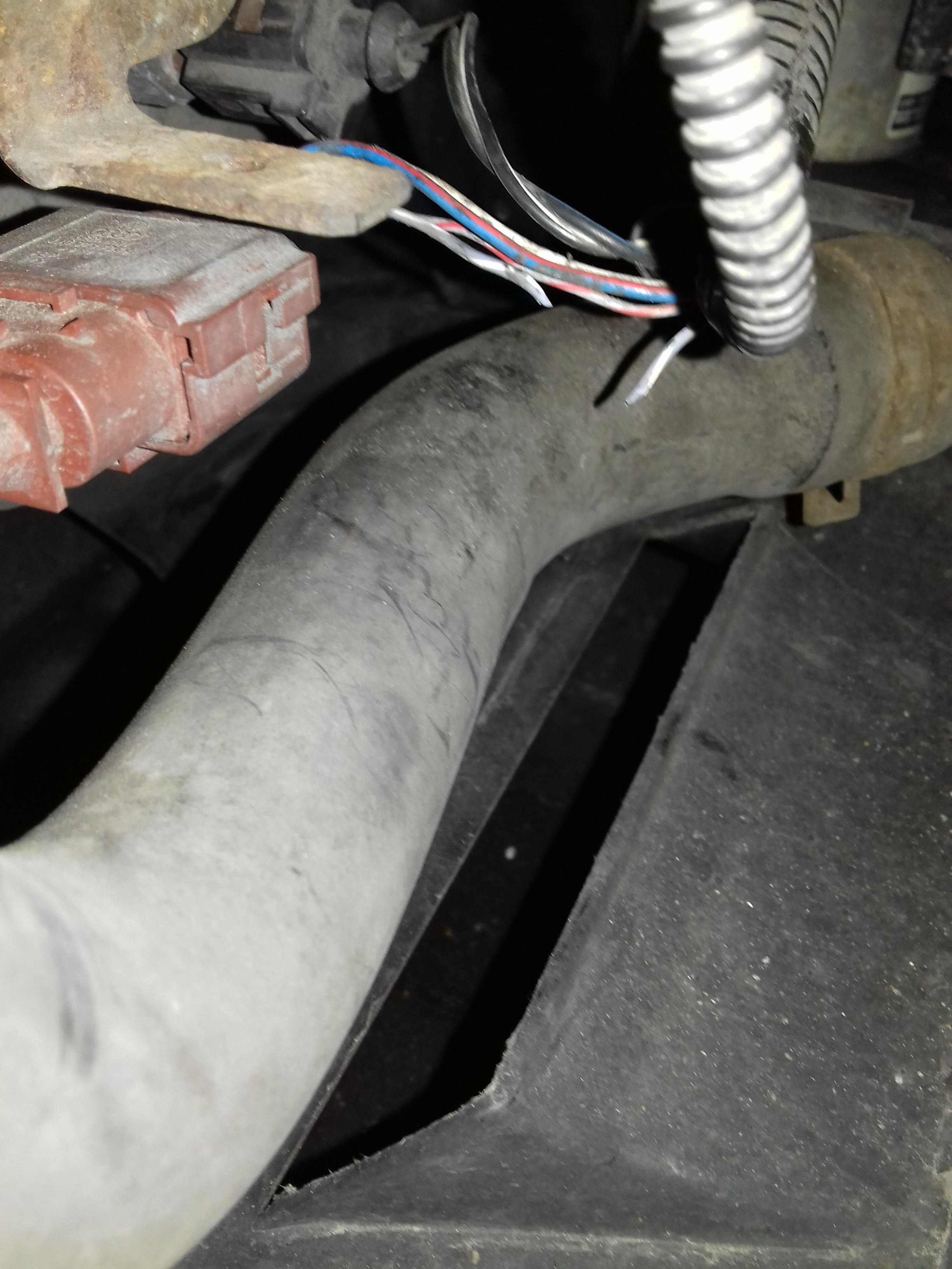

I finally got it sorted!
I had a broken wire on the connector that the post cat o2 sensor plugs in to. It was well hidden!  See picture attached after I unearthed it hidden amonst a few winds of electrical tape.
I managed to strip both ends, wind them together and tape it up. EML has now disappeared hurrah!
