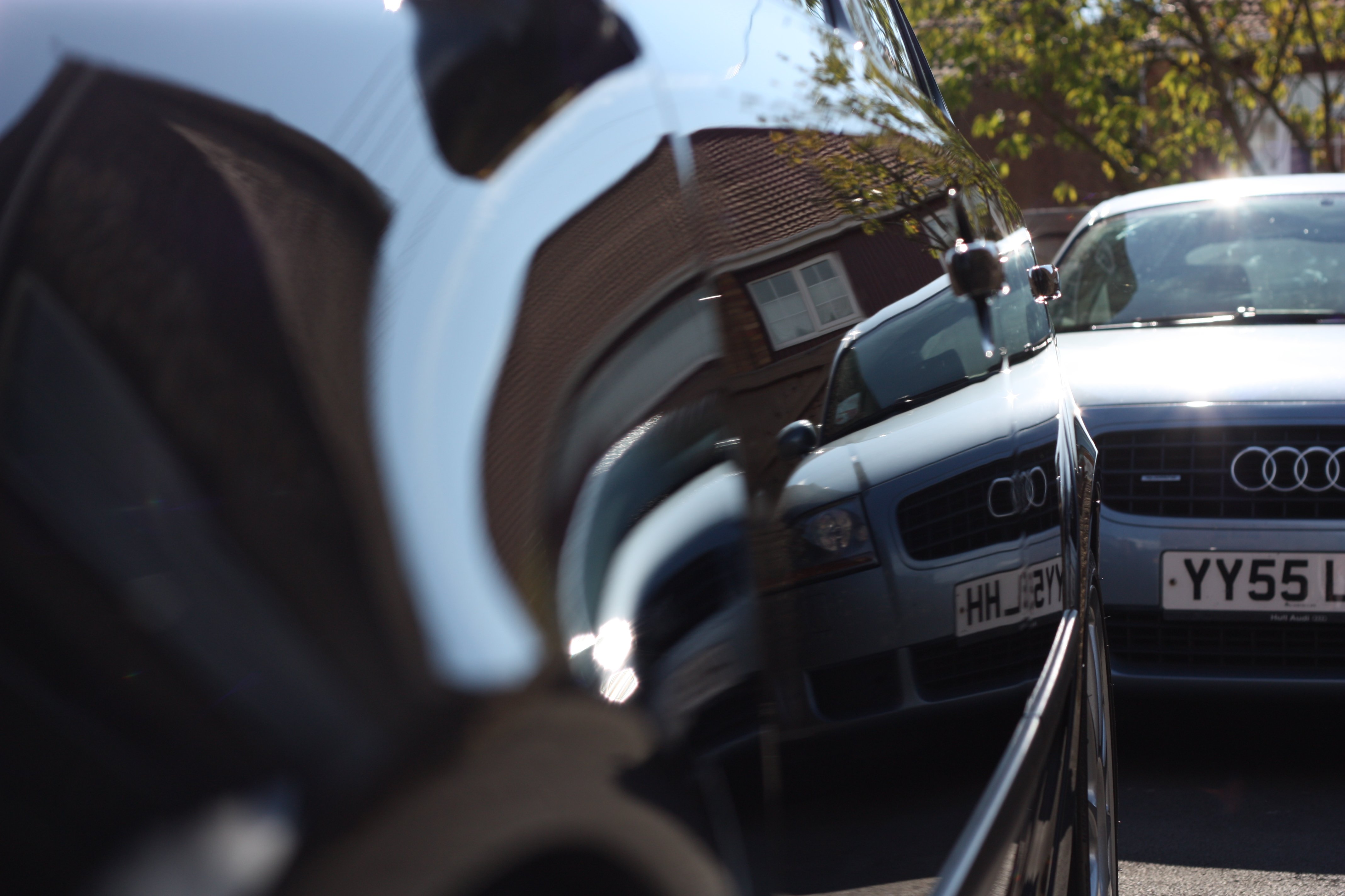

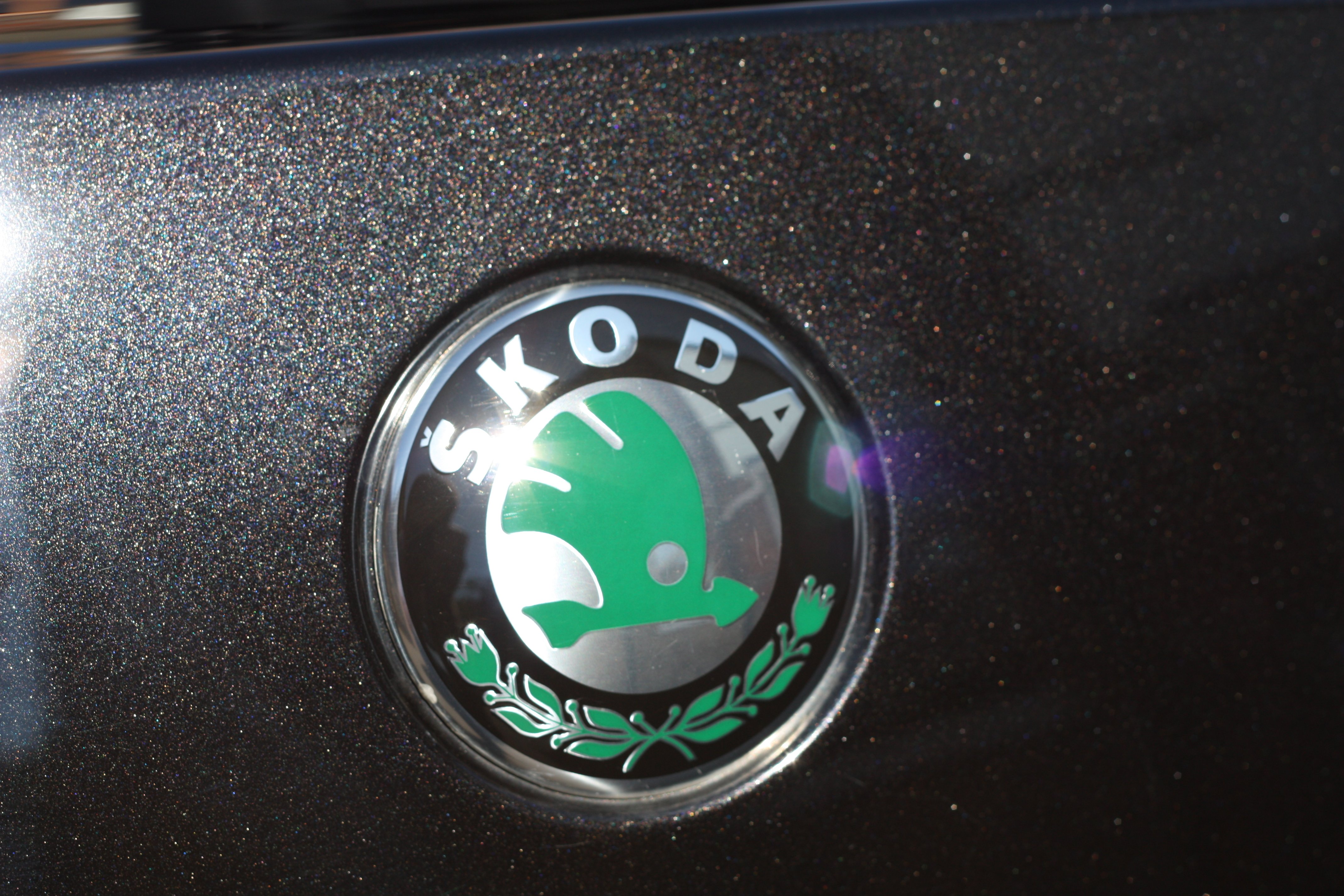

I tend to do it when required; this usually meant an annual machine polish, but to a lesser extent than the initial work to get the paint upto standard. You'll always induce slight scratches during wash and care procedures during the year. So it's about taking the paint back, correcting as necessary then re-applying protection again.
So that would normally mean a one-stage polish with a final finishing level polish, rather than intensive polish.
Would you give you something like this....
For context, this was a 6yr old Octy at the time, with about 85k miles. Two previous owners and 'normal' external care - carwashes, bad/careless handwashes etc.
