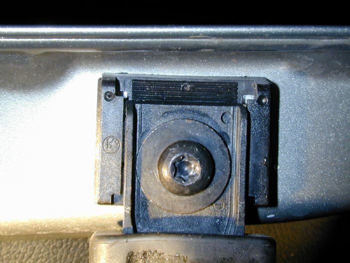

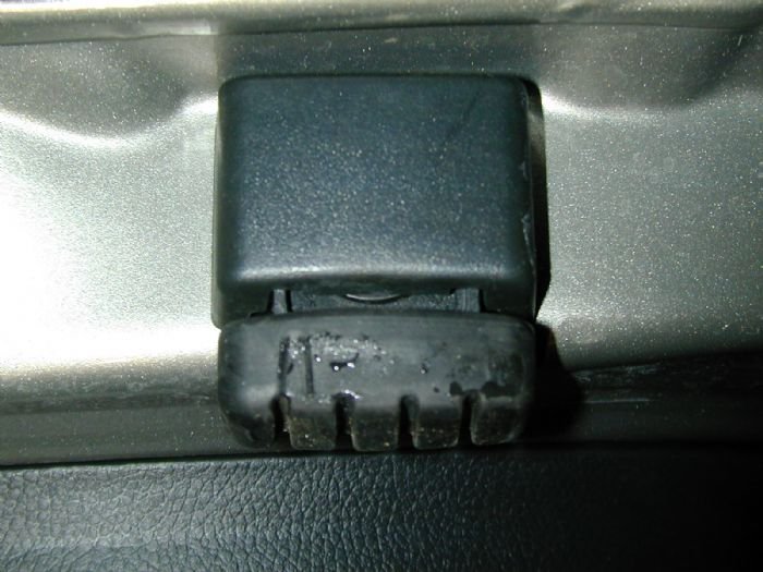

It is easy to adjust the stops on the rear door. Just clip off the side plastic trim at the stops and adjust them. They have ridged plates so adjust one ridge at a time to tighten the rear door. This may stop the knock. If you go too far the door will be hard to slam closed, bouncing back instead of latching completely shut.

Same problem I had. Rubber stops need to go in slightly, or catch moved out. Try the stops first as easy. I didn't have the correct spline key size to adjust the catch, but moving the stops solved the problem.

It does sound like the door stops need adjusting it to make the boot door easier to close.
Pop off the covers, one each side towards the bottom of the door.
They only want moving a notch or two.
