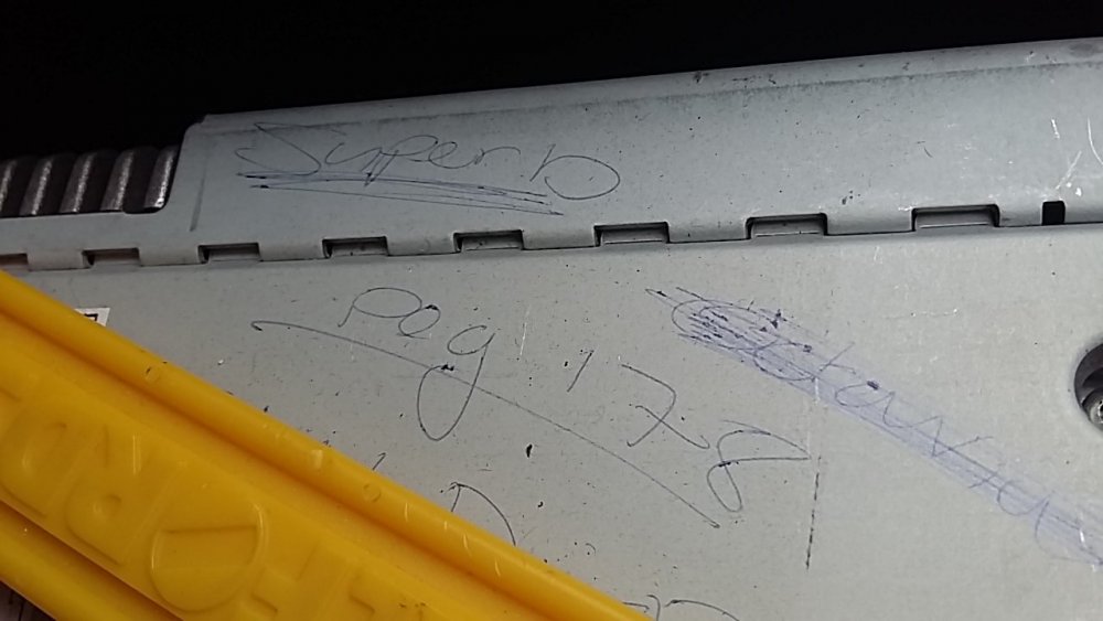

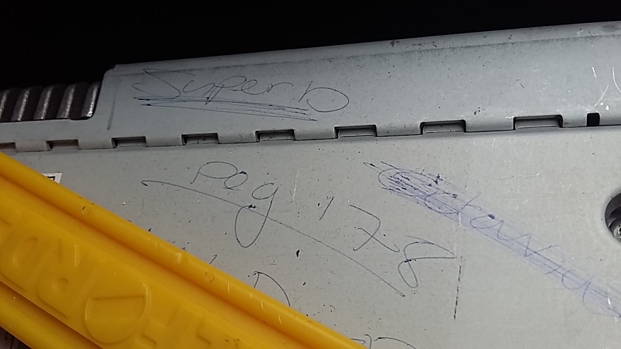

That was until I took my Columbus unit out to get some photos of the manufacturer’s labels. Someone has written on the top of my unit in ball point pen, see picture, including the registration number. (Which I’ve carefully hidden with a Halfords Ice Scraper!) So I’m guessing my unit has been removed in the past for some reason…

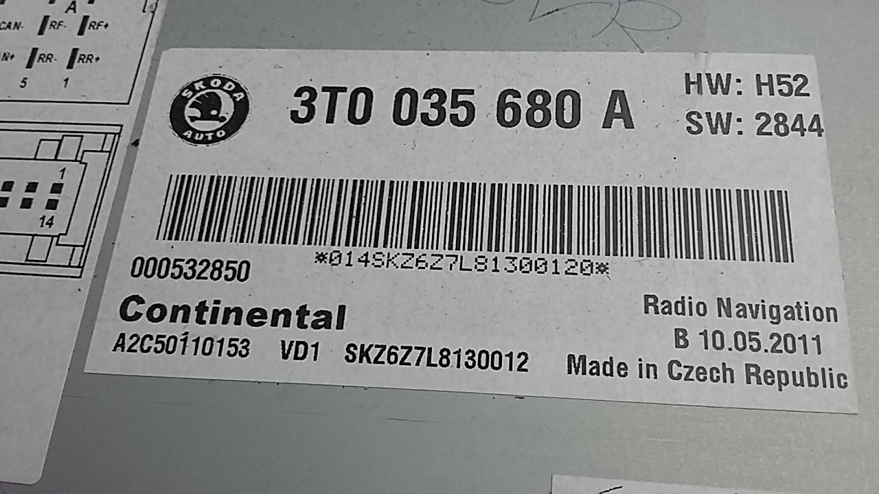

But I’m going to ignore this fact for now. So let’s assume it is still on the original firmware as shown on the label in the other photograph. What additional features, bug fixes and general improvements am I likely to see if I upgrade the firmware?

If you have the original firmware then you'd be advised to update it before loading newer maps on, then you'll have access to all the later functions. Things like Custom Points Of Interest (speed cameras), radio text (tells you what radio station and artist/track is playing), and quicker boot up etc.

Secondly, based on the details shown on my label what version of firmware should I be aiming to reach?

Well, before you go throwing money at discs etc. it'd be worthwhile knowing what you're already at. Might be different to the label for a start. I see you're in North East, if you''re close to me then pop in and I'll check it over and see what you have, then we can sort out a viable upgrade path.
