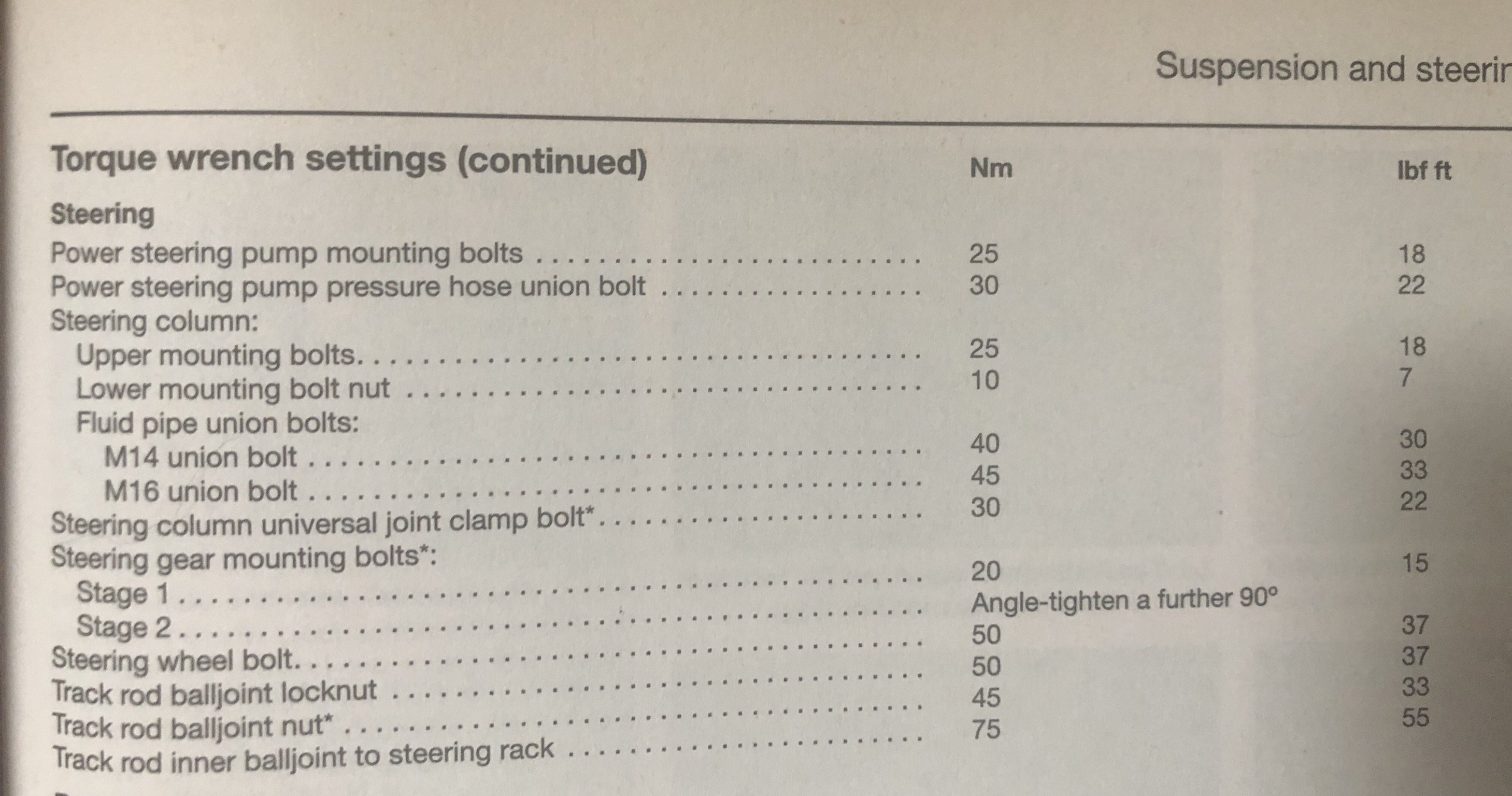

Just replaced power steering rack on 2002 skoda Octavia vrs
Anyone know what the torque settings are for the 19mm banjo bolts that connect the fluid lines to the rack?
Hope this helps. All that’s available in the Haynes manual. 72409D4B-A073-498F-8B02-F5C876FAB565.thumb.jpeg.670273c43fd44a7d38020a4ebe844702.jpeg
That's amazing thank you !! :)
