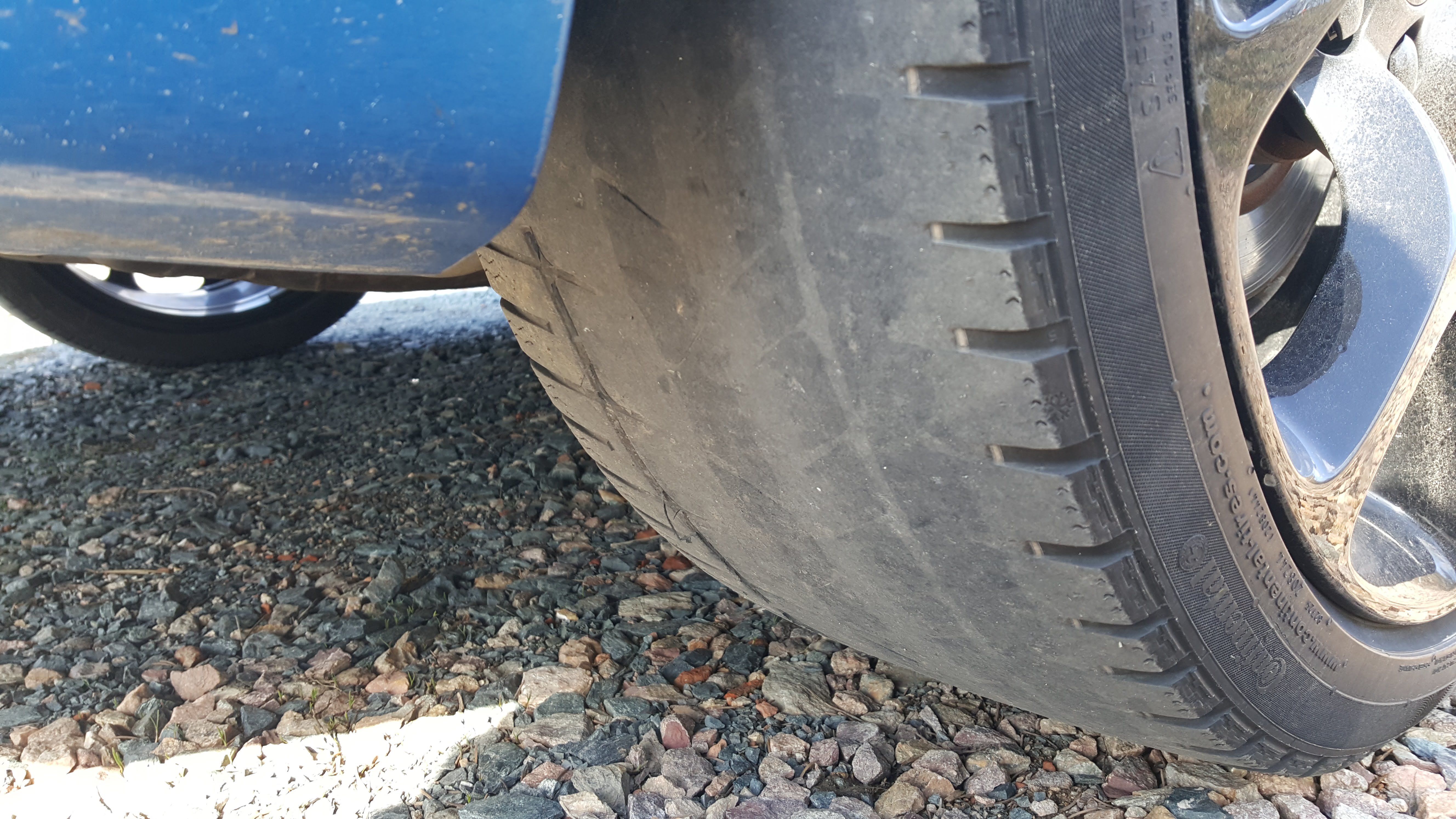

One of  the Scouts I had suffered with rear tyre wear issues on the inner - I had 4 wheel full geo and stuck new tyres on and the issue was resolved.  Suggest getting it checked again and having a full 4 wheel geo before you do anything else.
If the geo is out then that will give you the effect you feel of backend feeling like its pulling sideways.    From your picture its as if that tyre is pointing outwards judging by the wear.
Once the tyres have worn like that then the car will feel strange even if the geo has then been corrected.

Guys this was done 2times. Once before winter, second time before summer and results are same. Even when i have rear tires as i mentioned on the picture after winter so i place there a new summer tires and made a new geo in original servis and they told me that geo is fine no need to adjust, so there is no any problem with geo. I suppose that bad geo can cause tyre wear on some location like inside and outside or one tire will be worst than other but not bot tires absolutely same wear on whole tire.
The geometry being out on mine cause both tyres to wear normally across the whole tyre only very quickly.

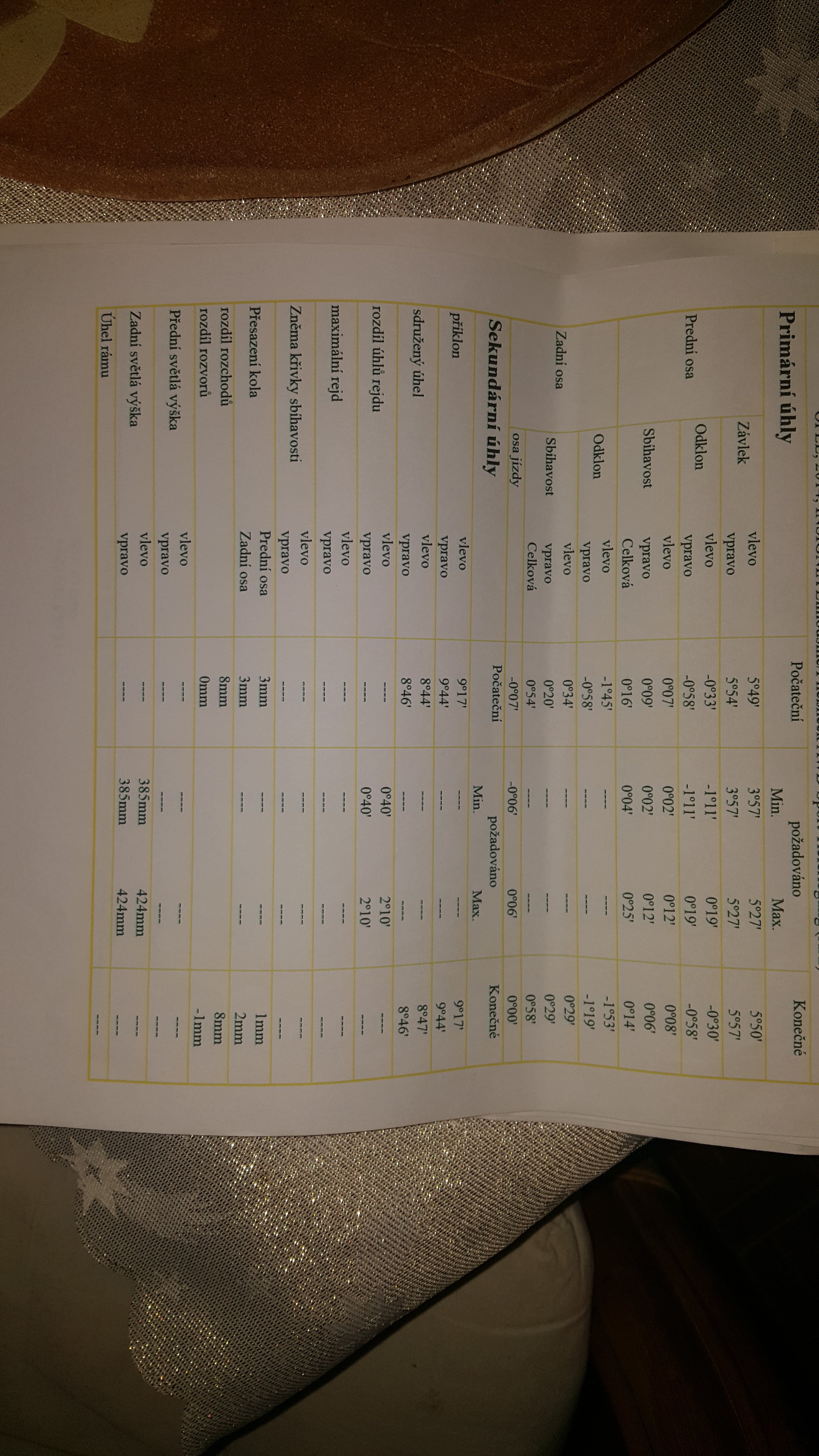

Can you post a picture of the geo print out from your checks so we can see what the rear wheels are set to. It may be the garage didn't use the "rough road package" settings or something similar.
This is from original service on the new summer tyres. Geometry measured before was without any tunes same as on completelly wear winter tires.

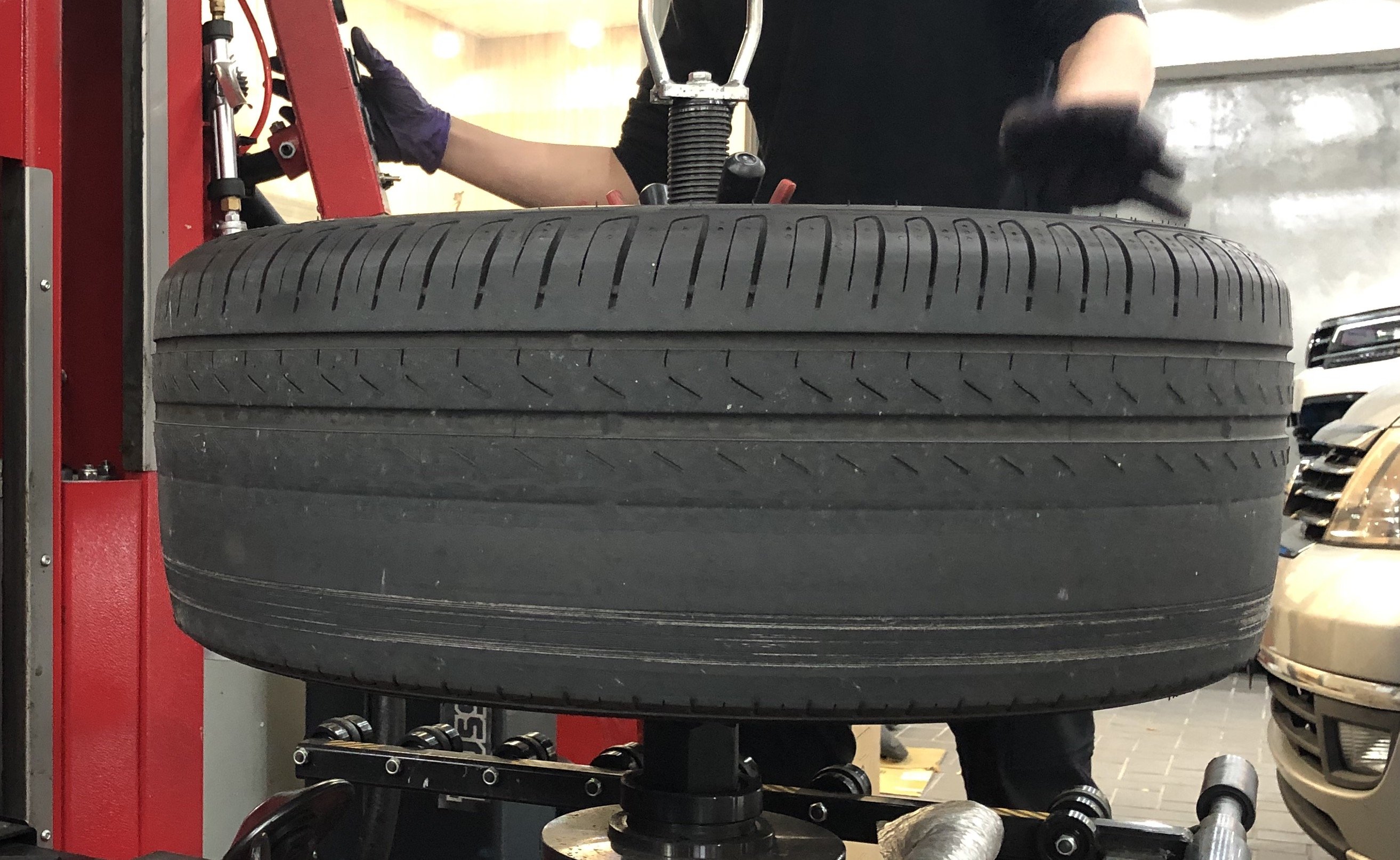

My Tiguan MKII w/ 4Motion also using a Haldex system, and I got a dead rear tyres just after 5800KM (about half year). But the front tyres remaining very much tread.
Most of the driving with 2 people in front seat, no heavy loading. So I'm wondering if it is a traction issue from Haldex system...
