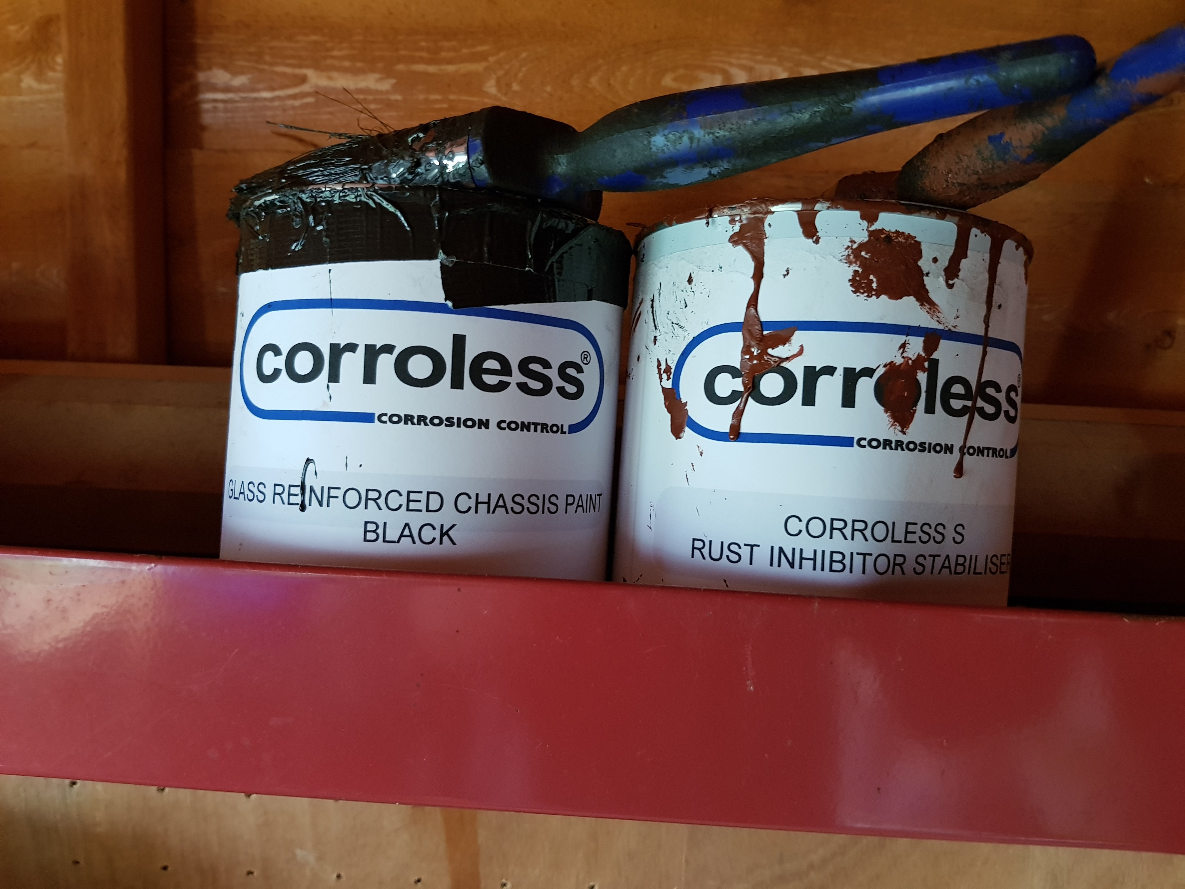

With winter approaching and the dreaded salt grit looming,  I decided yesterday to get the Octy on the ramps and treat the surface rust.
Starting with the rear (front to be done next week after had bushes changed) I wire brushed the flakes away then I gave it a coat of the below rust inhibitor, left to dry overnight then a coat of the top coat.
Never used this stuff before, always tended to use waxoil, but they state this will be good for 10 years.. apparently they use it for off shore applications so fingers crossed it will last..
Has anyone else used this stuff?
Nope, not come across that one. I'm a user of Bilt Hamber products for this sort of work.
I use hammertite with waxoy spray l on an older car 9 year old honda
The Mazda this year and the Skoda last year I didn't bother it's too new.and a lease car
Dried very quickly
To be fair this stuff went on really easily and dried quickly.
Would recommend as an alternative and always worth doing before winter ;)
