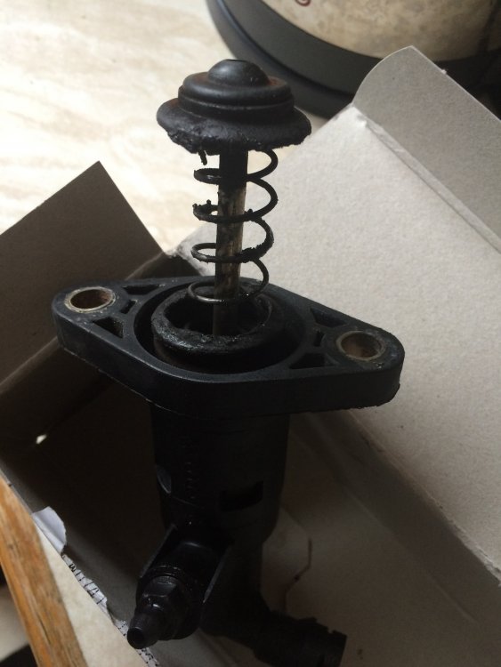

If it's like the 2005 1.9, the master is in the back of the pedal and slave on the gearbox. Unless I got them the wrong way around again. I never did either with my own hands. Garage had to bleed when I had pedal one swapped. Used to get low/dropped pedal, turned out the one on gearbox had split, the spring inside was visible.

This is what my slave looked like
That spring should be shorter and held in by a rubber cover.
