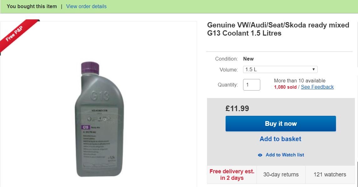

Yes, G13.
I ordered from here, delivery was very quick, £11.99 delivered to my door...
https://www.ebay.co.uk/itm/Genuine-VW-Audi-Seat-Skoda-ready-mixed-G13-Coolant-1-5-Litres/152234335270?ssPageName=STRK%3AMEBIDX%3AIT&var=451424724313&_trksid=p2057872.m2749.l2649
Always buy genuine. It's pre-mixed so you literally open the cap and pour it in to the MAX line.
Thanks for the tip- came next day and I used about a half litre to fill back to the Max line. Will keep an eye on it now to see if it drops again.
