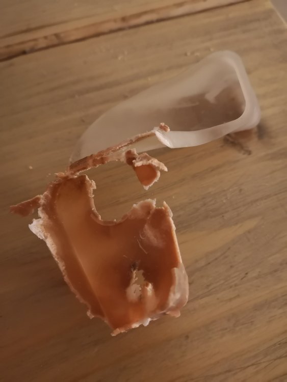

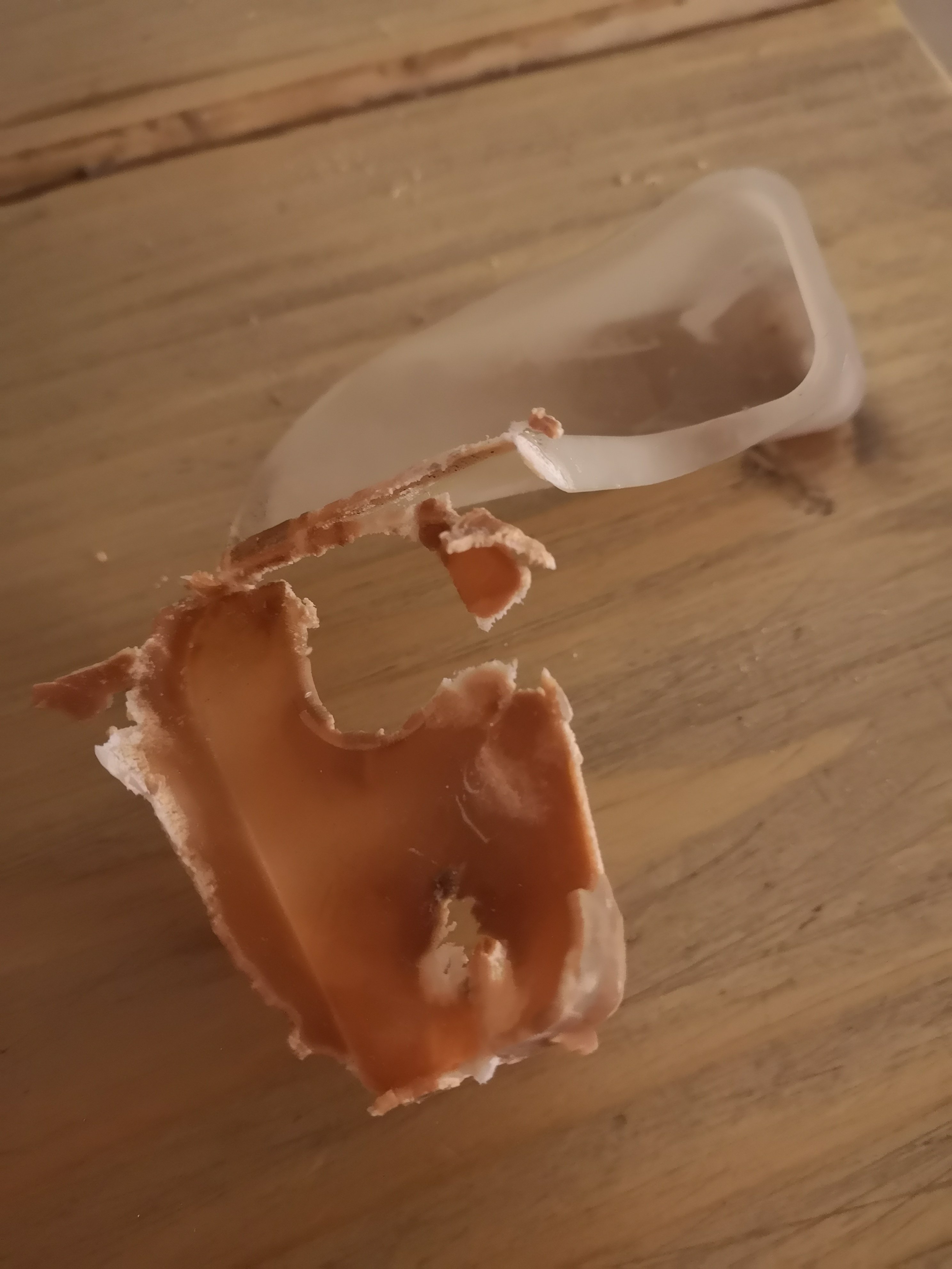

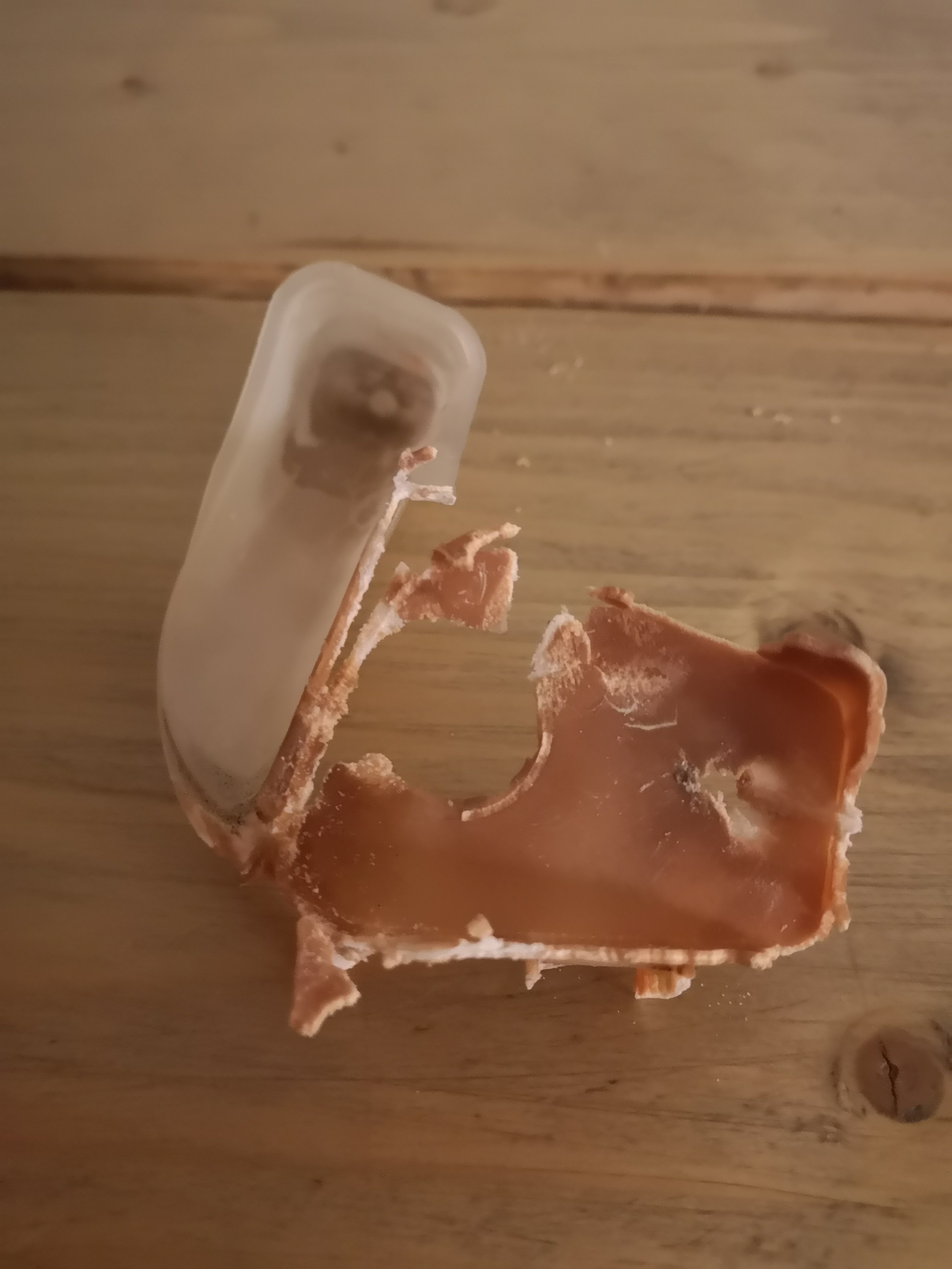

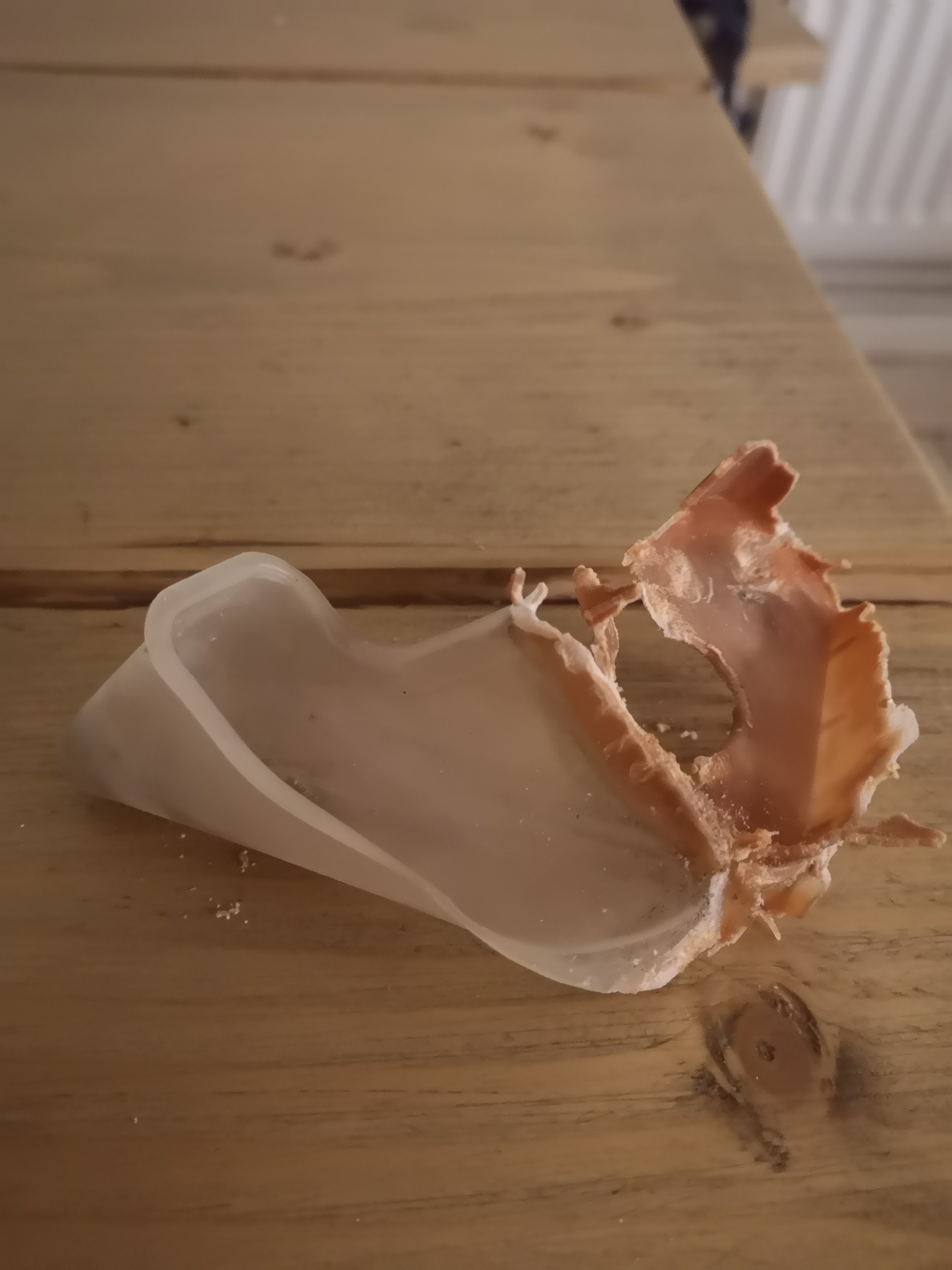

What the hell is this? And is my car going to survive without it?
I've had my car for 3 years skoda octavia 1.8t 4x4 from 2004 and I've just had to fill the coolant up a bit. However, when I went to fill it up I found this plastic part disintegrated. Pulled it out with scissors but have no idea what it's purpose is or whether I need to replace it or the expansion tank? Any help would be great!
Edited by Woodsypaul
Part of the reservoir internals.
I've seen a few posts and YouTube videos on this.
Seems to be a VAG thing where the plastic used discolours and disintegrates.
I'd check the reservoir thoroughly and expect to replace it in case of failure at some inopportune moment.
