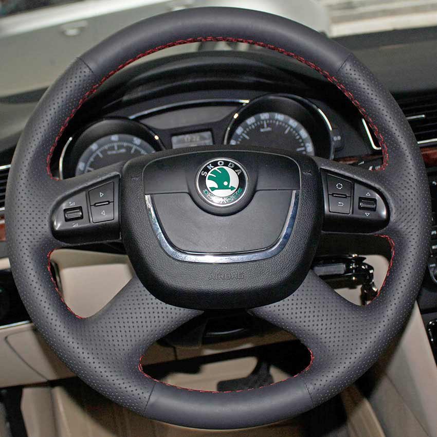

Vcds says error communicate radio and steering wheel, i know i must change steering wheel buttons but what us correct buttons?
No if want to answer must push phone answerr button.
No that buttons what picture.

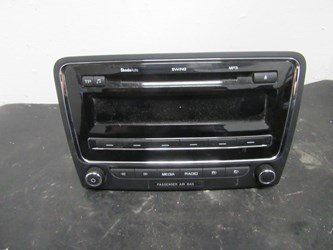

What did the car had before if it wasn't a Bolero unit? What is the part no of the BT module?
Before is this radio and bluetooth module is 1k8035730d

I pair it samsung s8 and it pair okey, but radio dont show any information calls only that tiny phone icon top of screen. do you know what is correct wheel buttons if i change buttons? Is this correct https://www.ebay.com/itm/Skoda-Octavia-2-Superb-2-Yeti-Schaltwippen-Multifunktion-Tasten-DSG-5E0919719G/401618004024?epid=1942197603&hash=item5d824c6838:g:khYAAOSw8d9U1oLz&redirect=mobile
Your current buttons will work just fine with that generation module, but first check whether or not you have it configured as DDP or BAP protocol?
