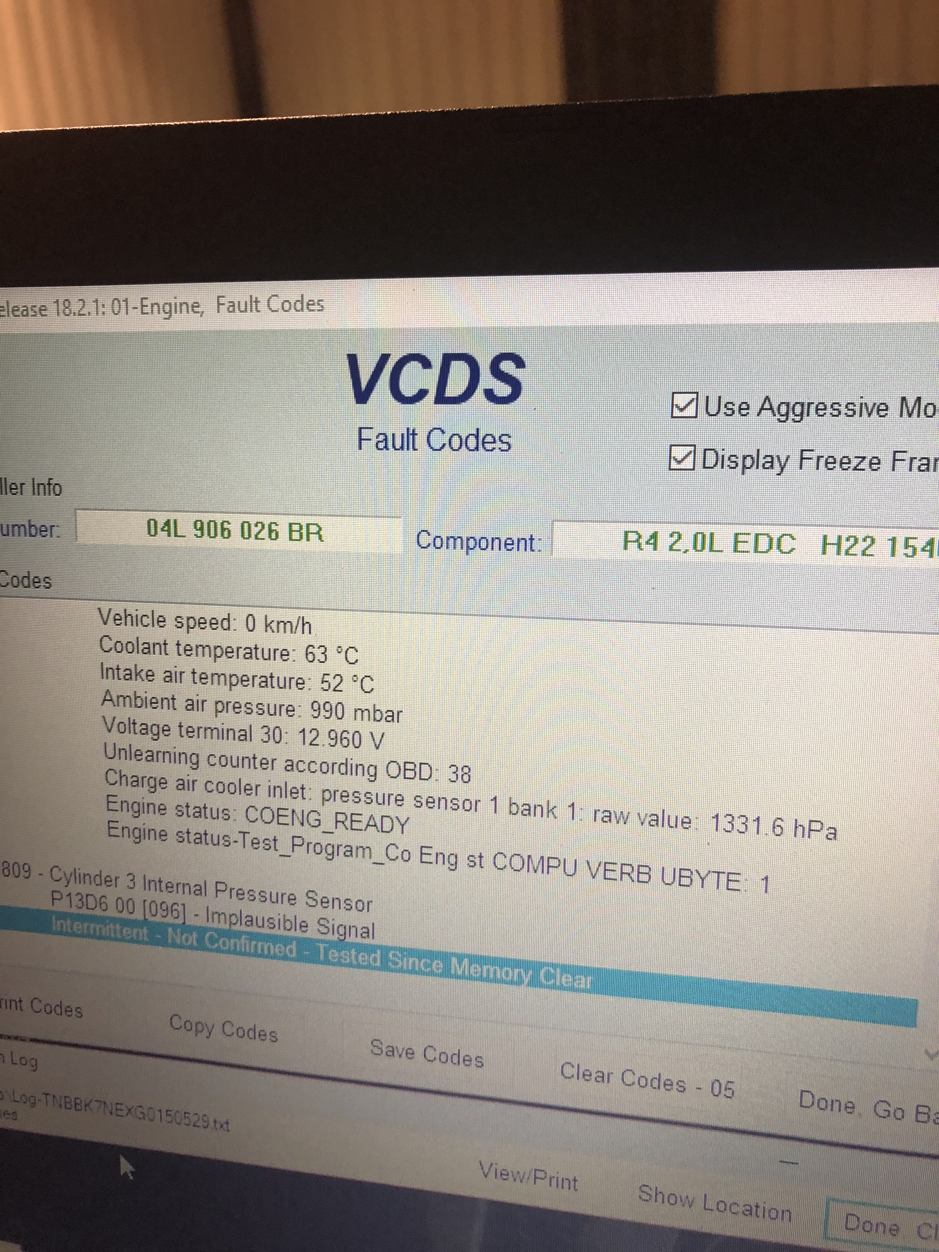

So this morning my vrs started flashing the glow plug light the second I started it.  It has gone into the stealers on a tow truck thanks to Skoda service. I got my friend to plug it into his vag com before I did anything and the boos pressure sensor cane up and this other one for an internal combustion sensor on cylinder 3.

I think it's a faulty glow plug and/or wiring to the glow plug. Swapping glow plugs with another cylinder would help diagnose the problem. Hopefully a quick and easy fix for the dealer.
So I got it back today. Turned out there was a glow plug in cylinder 3 failed and the boost problem I was experiencing from day one was a split vacuum pipe.
