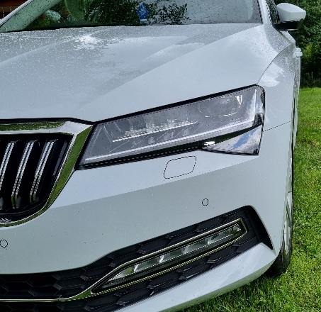

  13. It's a pain in... Main issue is that it should work as designed but it doesn't. Tbh now, when it's "fixed" I still don't really use headlights in Auto on motorway. There is to many cars and lights are going crazy. It works much more efficient on smaller roads where I can see them going on and off and nicely cutting out oncoming traffic. But it would be expected from Skoda to fix it, unfortunately its not going to happen...
