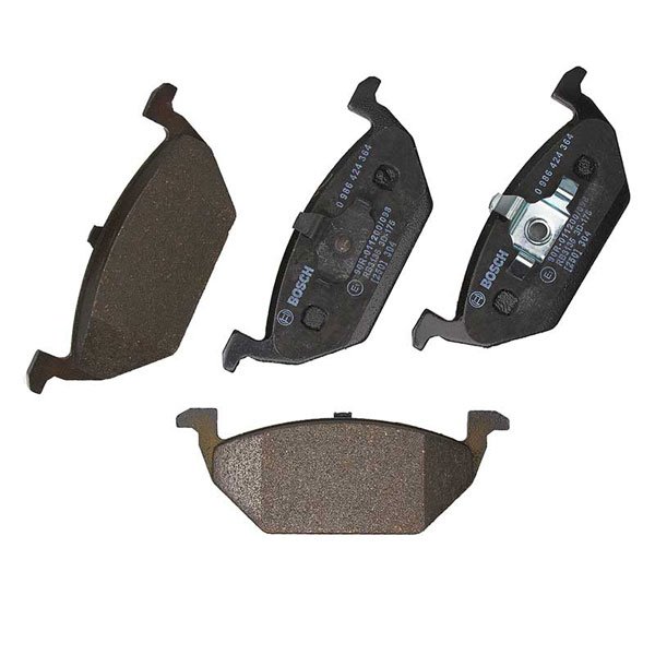

Standard disc setup is FSIII caliper (the letters FSIII are cast into the caliper), 256 mm discs. The pads look like this
Important 2 points!
1. Check on the passenger side (UK) of your car is fitted with a wear sensor, it will have a wire coming out of the front of the inner pad and connected to a socket on the top of the hub. If it has, you need the pad version with the wear sensor. If the set you bought came with a wear sensor (sometimes sold as universal) but your car doesn't need it, you can simply snip it off.
2. On the picture you will notice one pad (actually 2) has a silver clip, the other pair have a black clip. The silver clips are slightly larger than the black ones. The larger clips are the inner pads that clip into the pistons. The slightly smaller ones are the outer pads and clip into the caliper. Other brands may not have different coloured clips, but the clip sizes/shape will still be slightly different inner/ outer.
