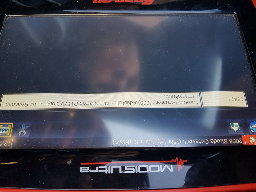

The issue is I've lost my accelerator and my ECU lights flashing.
My mate run a diagnostic, see attached photo, there's a signal coming from the pedal so he advised me to clean the throttle body. It was clean but i replaced the unit and still no change?
He's saying it might need programming and aligning but if that doesn't solve it to talk to a bloke about the ECU...?
Have you heard of this before? Maybe throw some light on the subject?

If you replaced it for a new parts the adaptation need to be done.
The throttle body was brand new?
Yes, brand new unit fitted....
