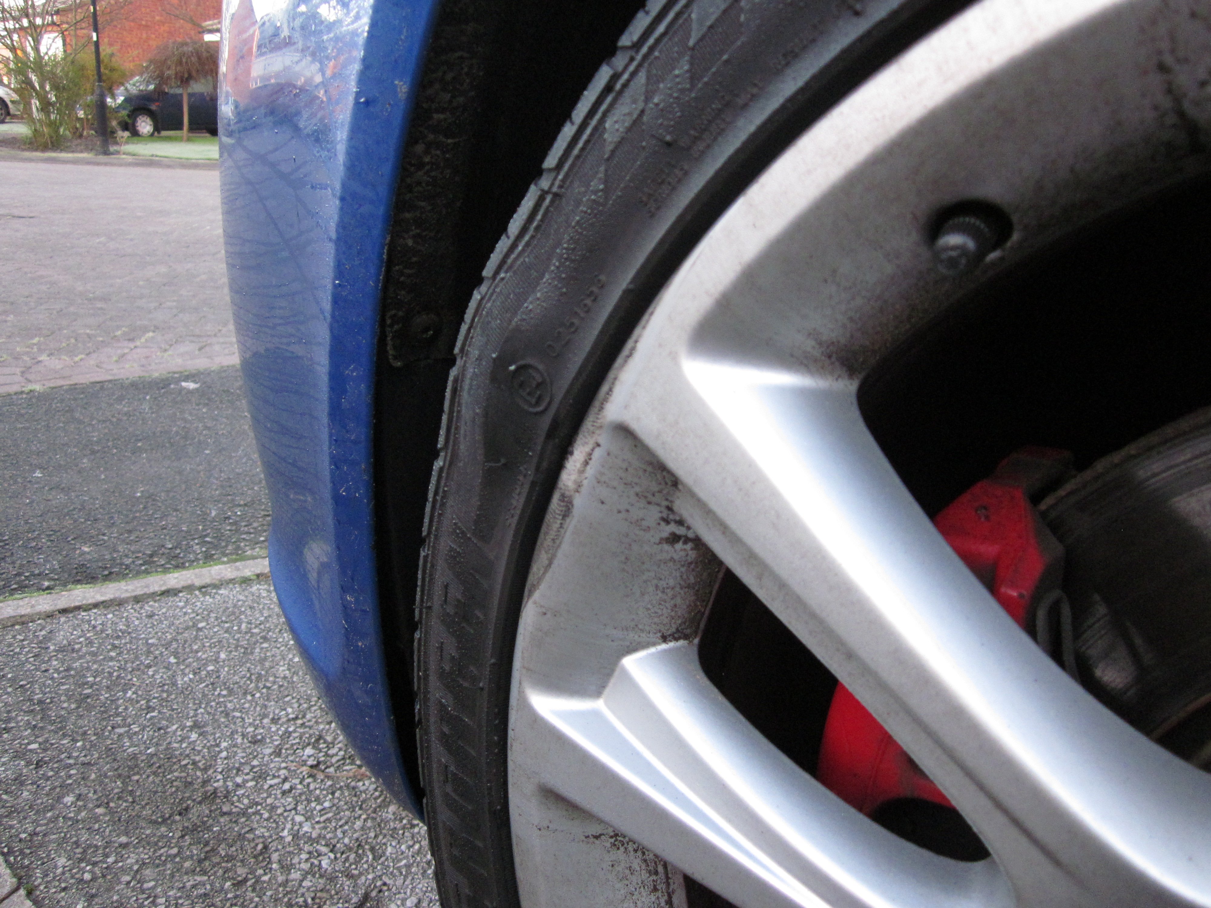

Check for bulges on the side wall of the tyres.
If the tyres look OK it's likely to be a bent alloy wheel.

You should always be checking the inside tyre walls because the damage can easily be there and no visible damage to rim or tyre on the outside as you look at a car, or jack up and spin wheels.
Good advice. I've had 3 tyres damaged by potholes. One was visibly damaged on the  sidewall. The other two looked absolutely perfect - until you felt the inner sidewall. They were dangerously bad.
I was worried about my alloys being OK. They were. It was the tyres that were gonna kill me.

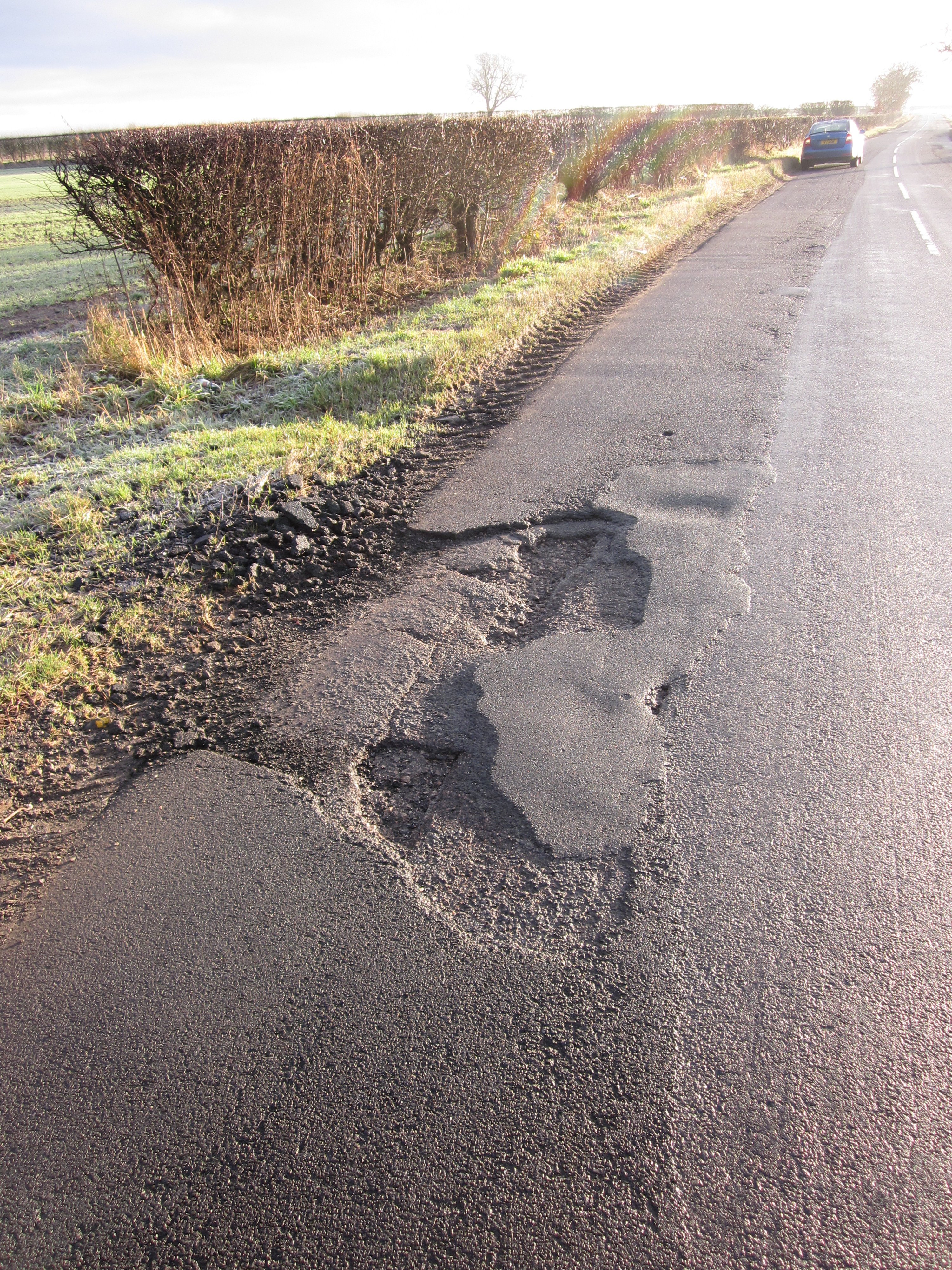

Bit of an update, managed to get back to the location a couple of hours after it happened to take pics to find the road crew on site with traffic management all up and running and the hole literally being filled !  :dry:  Just my luck but I got some pics of the patches/work in progress and spoke to the foreman so at least that's something - in the daylight there were two whacking great patches applied about 2inch deep apparently.   I expect these will be dug back out in a few weeks given the poor quality of the repair once the rain/frost get into them but that's a gripe for another day.
