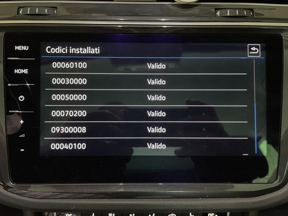

  • New MHI2 P470 (2027) maps were released by VW. The content.pkg contains the following FECs/FSCs: 02300040 (Audi), 09300002 (VW), 08300002 (Skoda), 07300040 (Seat), 06300040 (Porsche), 03300040 (Bentle
  • Same here with a Seat Mib2 high running on the Seat FeC this time.... so Xmas comes early.
  • The link was posted on August 12th by viper42
The P450 version is not compatible with VW and SEAT (FEC not supported)!
With 'More-Incredible-Bash (M.I.B.)' you can integrate an 'Audi(Skoda)_Lifetime_FEC with ExceptionList'!
Then the installation will continue to work with 'SEAT or VW'!

On the post on the other board where it's taking about the txt file of the part number not being there, it's a red herring (British expression as a false story) the txt looks fine to me that doesn't reflect the FeCs. Final test when I'm up. I know when the engine is running and I go into an information screen where it's using Škoda FeCs only, it shows a blank line for the infotainment part when it isn't using the host one.
What you need to make your unit work like a Skoda is to have 08300008 in your addFeC list in addition. 5 years ago now since I did this. Those using AIO software would need to find where the FeCs go in and edit and re-install or use the link above. If they do the dirty again we may need this 023000EE (the Audi life long navigation Fec if it becomes Audi only).

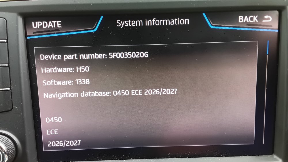

The gap above the 450 means its running with navigation FeC but not of the brand. Runs fine though. Means @MartiniB the compatibility list is true but may need a navigation FeC edit for other than a Skoda.
Edited by Tell

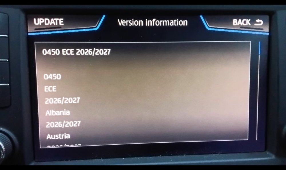

Updated perfectly on my Audi A4 B9
Top work lads.
Yes 330 supported all the brands navigation FeCs but by 350 they reduced it to just the two 08300008 and 023000EE . I did have a moment where I thought it had been changed in 330 but no 350. The wonder of how the navigation FeCs work you can throw them all in and it runs through them till it finds one that works. I was told by the person that helped me set it up previously in 2022. "You can remove it now" once they reverted. Decided no, I'd keep it how it was just in case it happened again. It did, three or so years later.
