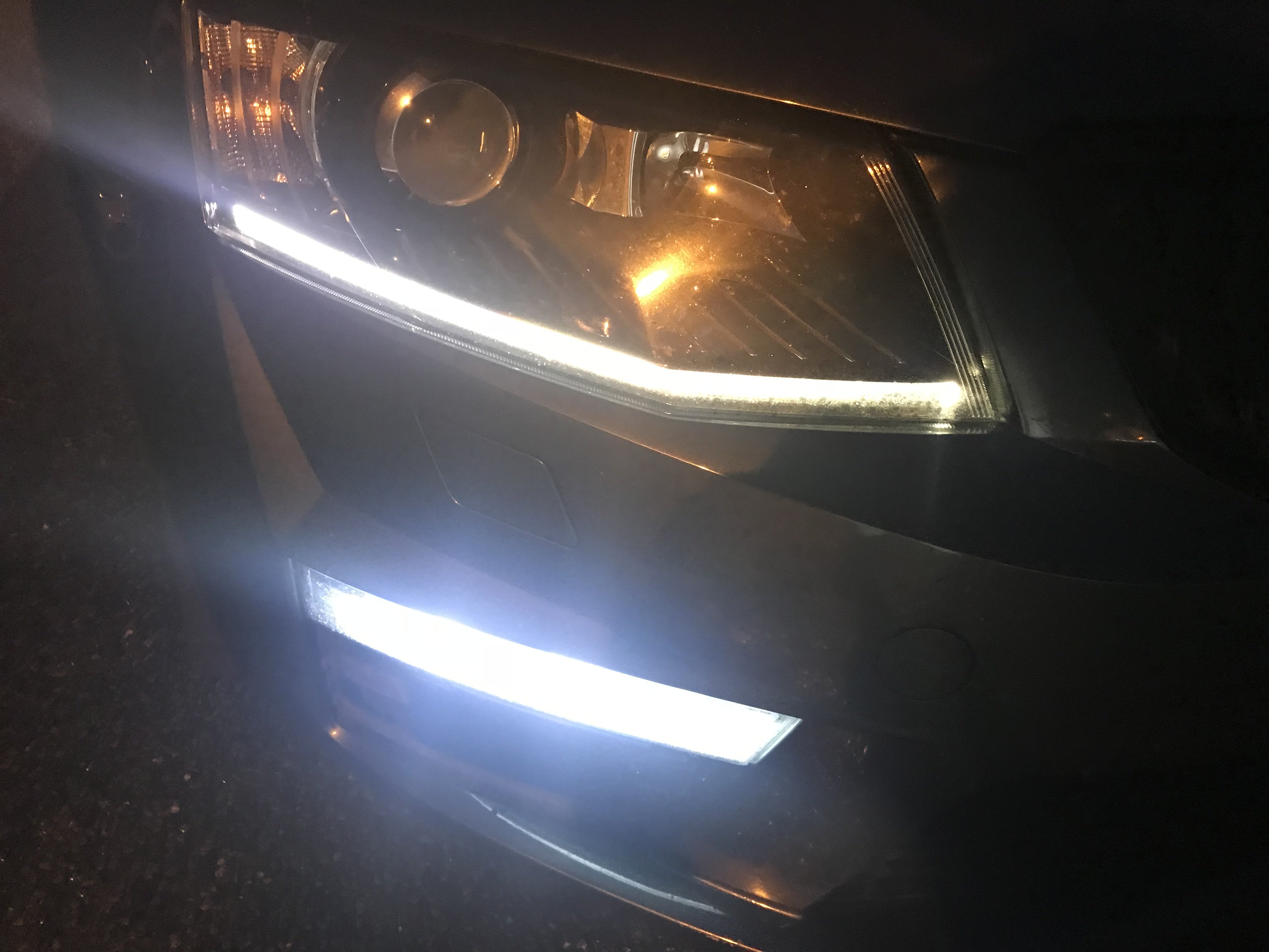

AliExpress will cater for your bulb needs :) I paid £1.37 each for these :D
After A LOT of scrolling I found & read your fog light post. Like you ideally I would really like them to match the DRL's. Have you got a link for the same pair of H8's you bought? If it's a quick snip of the bulb fitting then fine.

That’s just how much they were on AliExpress. I did leave a link in my build thread but that particular outlet has them listed as unavailable. I got both, H16 is not the fitting you need! Go for H11 which is allegedly the correct fitting. You could also modify the H8 to fit. Whichever ones I have, and tbh I don’t really remember now because it’s been a while, fit and work lovely now but it’s a bit of a bulb minefield with these fog light bulbs :)
