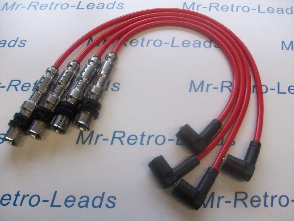

They come with 8mm or 8.5mm option, here is the item description and picture:
"A premium brand ignition cable for use where high performance is essential. The core uses a fiberglass and Kevlar® base onto which is extruded a Wire wound conductor cable which is tightly wound with a stainless steel resistance wire bound with a conductive lacquer. This design ensures maximum spark quality with virtually zero voltage loss while still maintaining an excellent level of EMI & RSI suppression. With a resistance range of 5.6kOhm per meter (nom). They provide superior reliability and ultimate performance at all times, even under the most severe conditions."

Not sure I would touch these unless they were from a reputable tuning company however to answer your question above you can get performance leads/Upgrades yes, I've seen performance cars from the 90's  that now require retro fitted coil/plugs as the originals aren't available.
They are made by Mr retro leads don't know if he is known in the uk but the price and "performance" aspect of it seemed like something worth taking a look.
