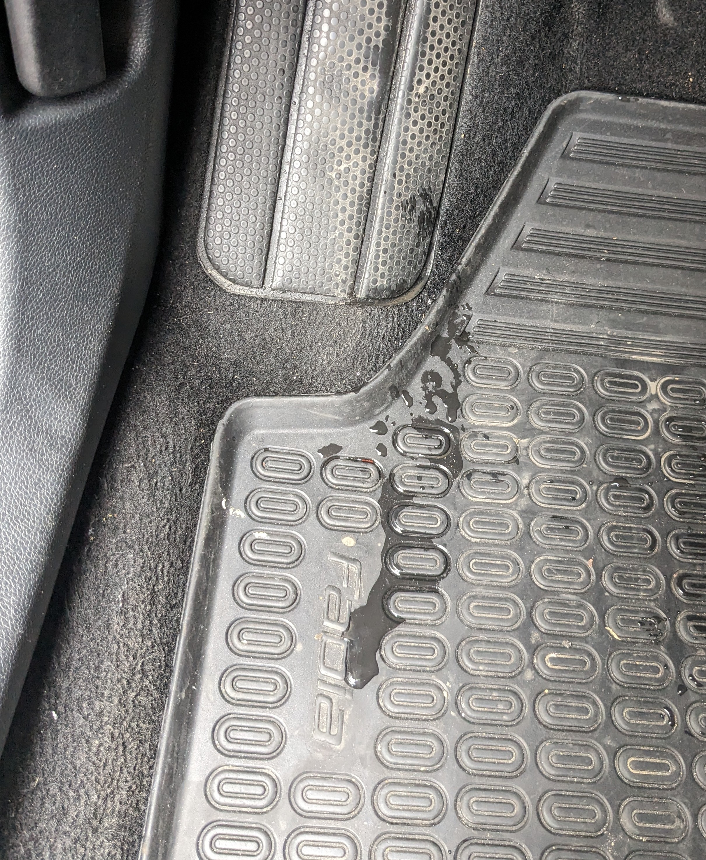

  1. Hi, I've been having some water ingress lately and I assumed to be the driver door that is a little misaligned, the car started to smell a little like mildew and so did the carpet, so I switched back to rubber mat, but today to my surprise I found out It wasn't comming from the door seals or drains, but from under the footwell itself, could this be a blocked scuttle drain ?

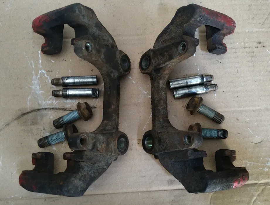

  2. Thank you for the insight, but they also came on audi a4's and other models. I already have new knuckles for both sides and two later model ATE calipers, so I'm just missing the brake lines and the caliper bracket, would the brackets I showed above fit?
  3. Hey guys, I am upgrading to 288 brakes on the front, already have the knuckles and the calipers and now I'm hunting for the adaptors. I came across some from a audi a4 b5 and was wondering if they are compatible part nº is 3B0615125

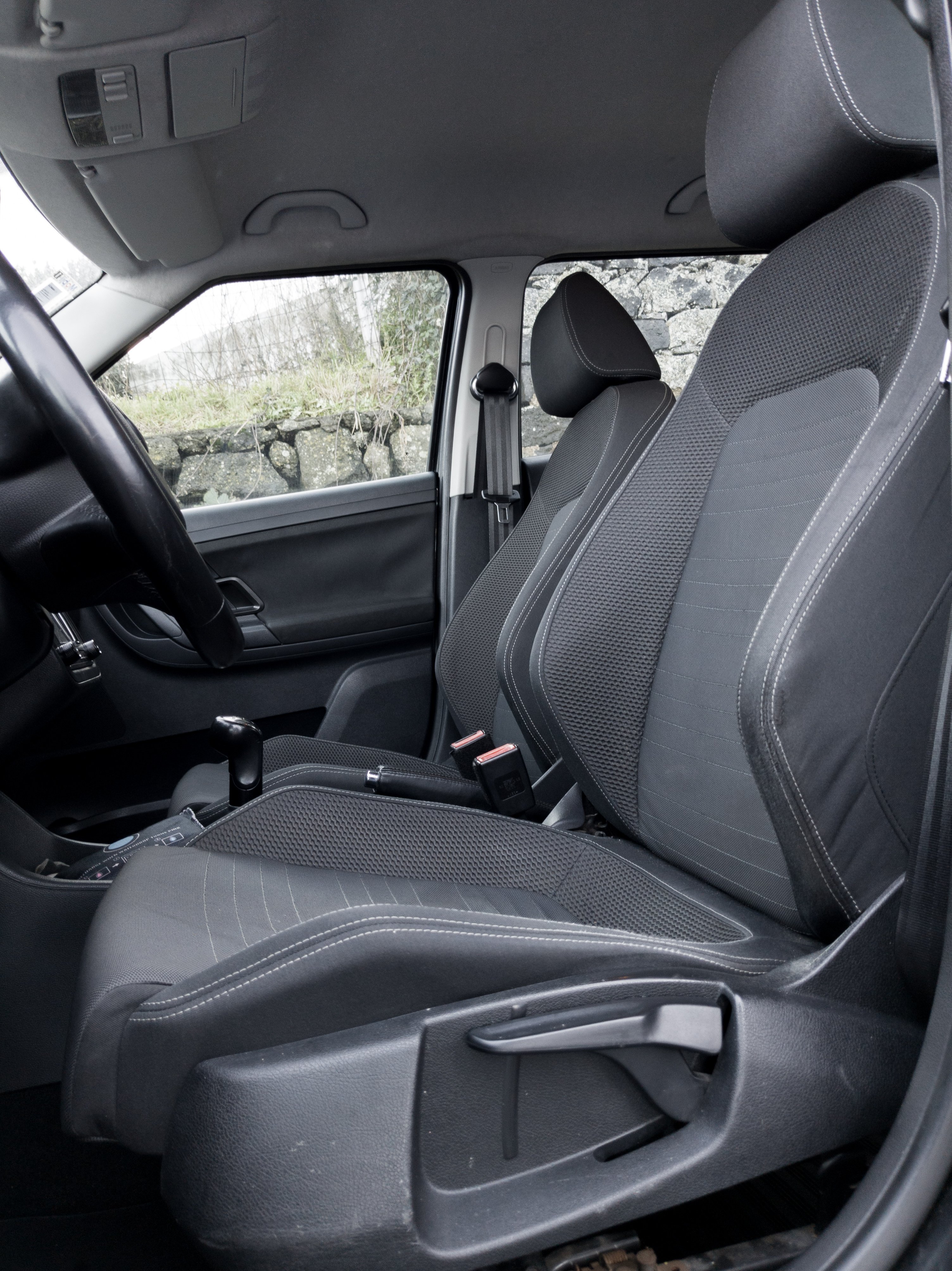

  4. It can sound like a lot of things, once I get the seats out I can add pictures for discussion
  5. I'm not from the UK, we don't disclose modifications to insurance, but what part did you deem unsafe ? The washers are for spacing, it is still fastened with everything original, also the rail has holes from one end to the other, did an extra hole on top of the 10 existing ones ruined the integrity of the rail ? I wouldn't of done the swap if I thought I was putting myself or others at risk, but thank you for your concern.
  6. Well they don`t, I drilled 2 holes on the rails, and after that they are still about 1cm too spread apart, so I had to put some washers on the rail mounting to put them closer together, after that they pretty much line up, I needed to push a little with my foot on the rail when I was tightening the bolts but after all wasn't that bad, if anyone is interested I can post a few pictures of what I did once I get the seats out, the rails came a little rusty so I'm planning on sorting that out in a near future
  7. Your right, I'm just trying to see if anyone has actually tried it or managed to fit back seats from another platform

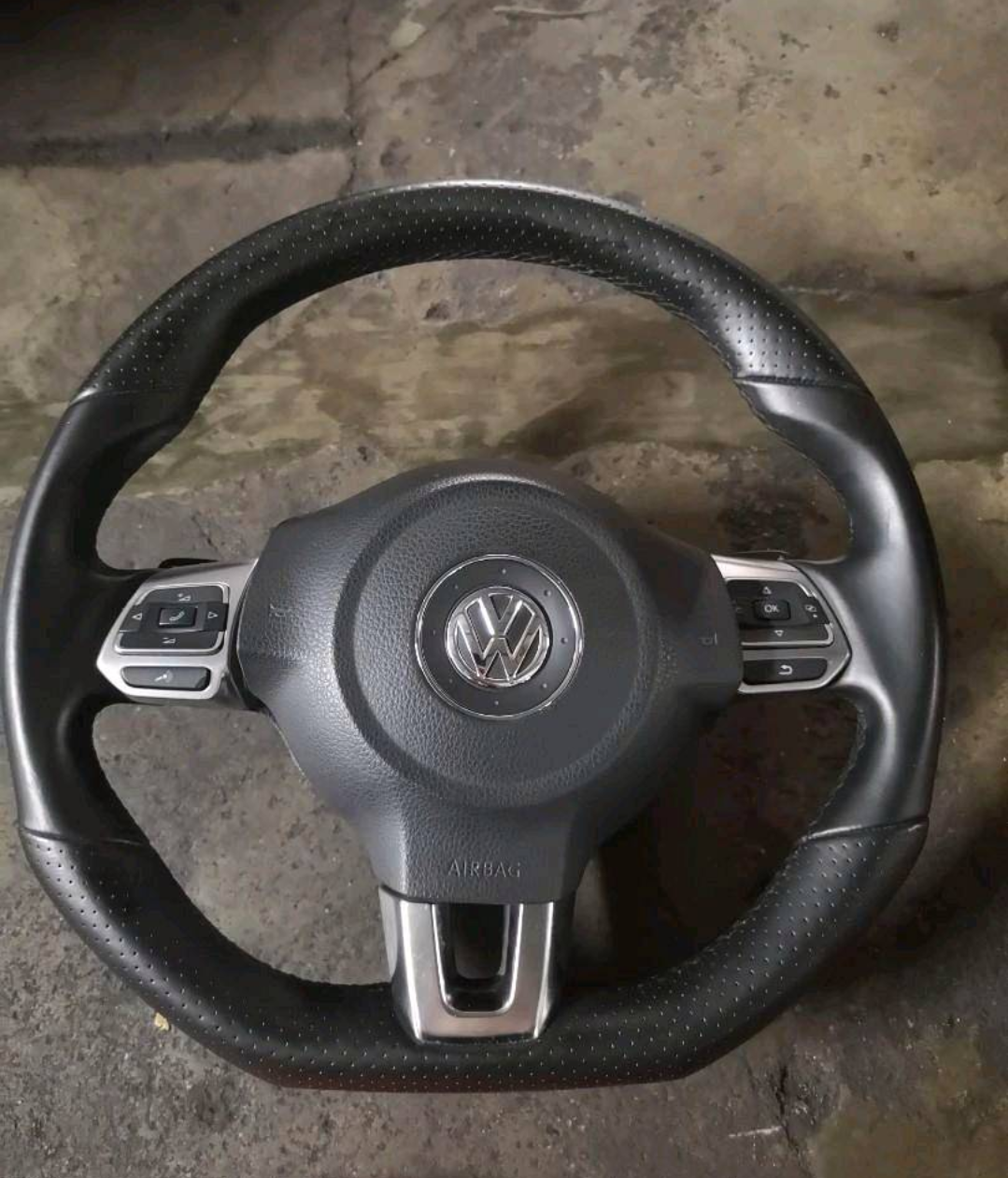

  12. I'm okay with the paddles, could also look for a octavia vrs steering wheel, it's the same but some don't have paddles
  13. I have the one exactly like the picture, I would of been more than pleased with just the left side buttons from the scirocco wheel but my main consern was the airbag
  14. Thanks for the answers guys, definitely won't try the swap then, will keep an eye on a vrs one
