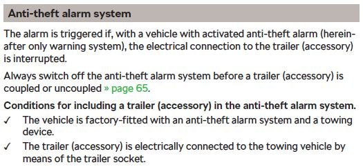

Hi all I had a aftermarket towbar fit and electrics now my question is why doesn't my alarm go off when I disconnected the electrics off the car I heard that it is meant to?
If your alarm doesn’t go off when you unplug the caravan or trailer, then the towbar hasn’t been coded properly or at all, meaning safety systems will be bypassed. Take it back to the installer and ask for it to be coded correctly. Copied from another post.

As Kenny has said, it hasn’t been coded correctly... if at all, it may even have been wired with  universal kit scotch locked onto your wiring loom :o
I paid for the proper wiring and I get the trailor showing on the screen it disables the parking sensors front assist and blind spot I just tested to see if the alarm went off and it didn't how do I know the trailer stability program is working?

Does the trailer have LED lights (which won’t allow the alarm to detect the trailer)?

It's got to be a coding issue then?
