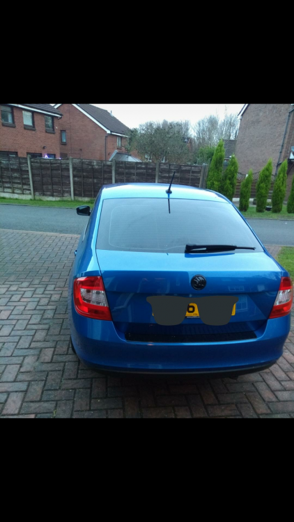

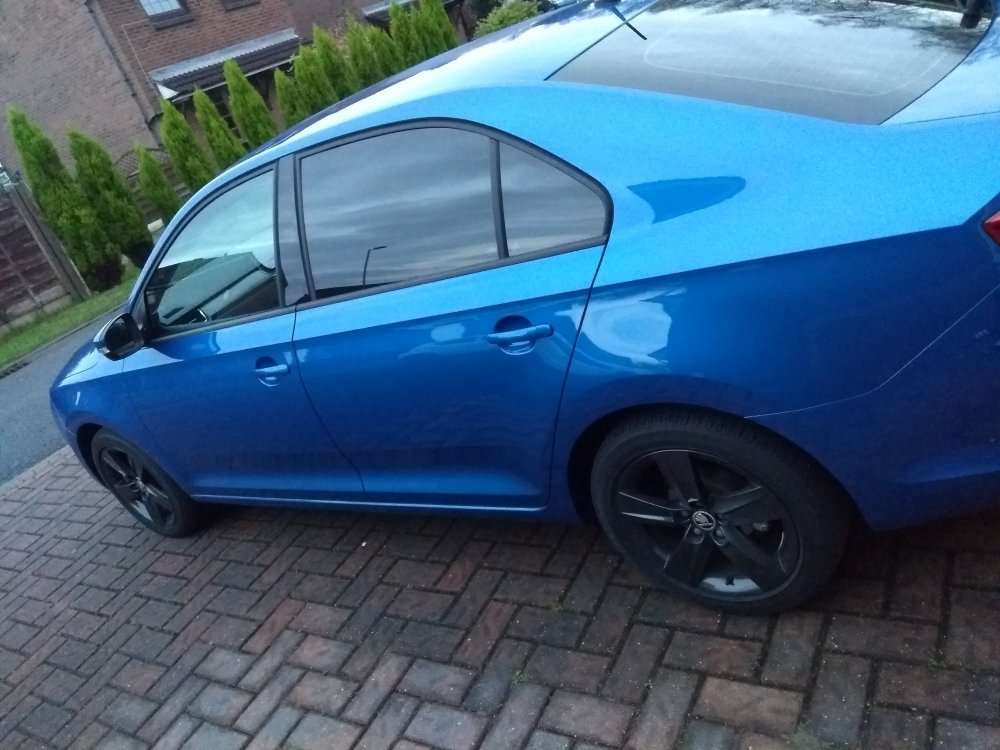

Hi all, new to the forum i own a rapid 1.2 tsi SeL, great car, finally getting round to putting my touches to it. Encountered a problem today trying to replace the chrome grille surround for the black version.... Anyone had any experience with this or tips? I took off the 4 screws to lift the plastic back but couldnt get the clips off the grill. Help?!
