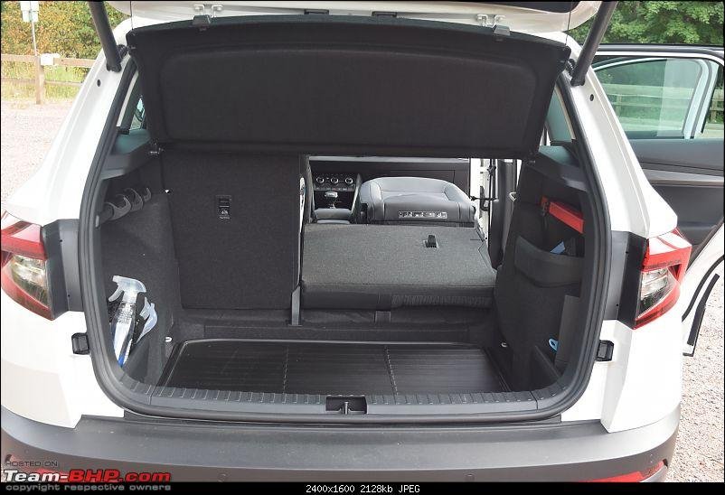

- How does the highest-raised boot floor on Karoq look like?
I would prefer the flattest possible cargo surface with all the passenger seats folded down, and the lowest possible boot-lip for loading.
Is this the maximum flatness Škoda Karoq can achieve across all available configurations?

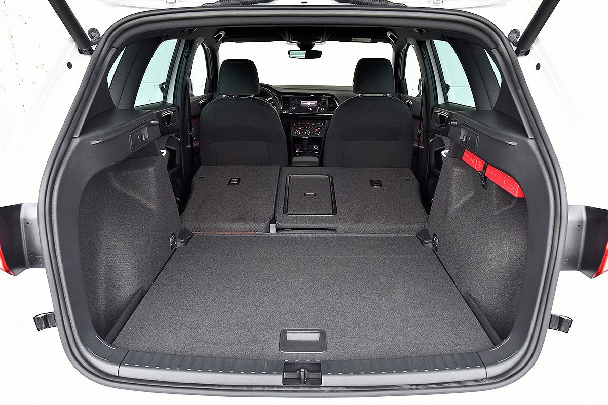

Seat Ateca looks better in this regard:

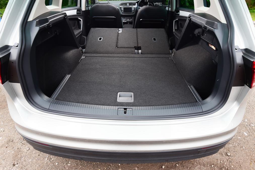

Volkswagen Tiguan even more so:

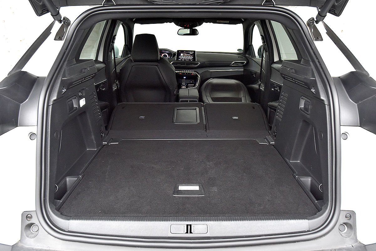

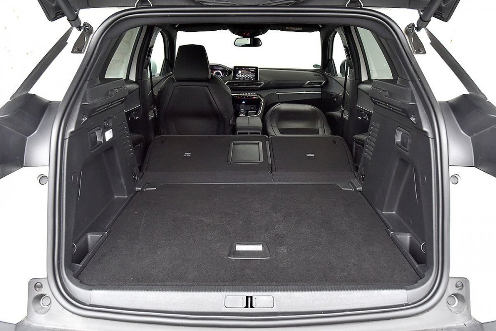

And Peugeot 3008 looks the best:

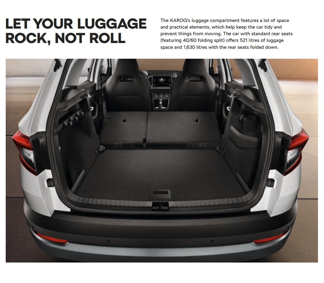

To put it simply: I would like to keep a 17" Ratikon / Triton wheel under the boot floor of Karoq 4x4 with fixed rear seats, to eliminate the boot lip and the need for a variable boot floor.
Is that technically possible?
It's almost impossible to find any pictures or reviews of Škoda Karoq in this configuration:

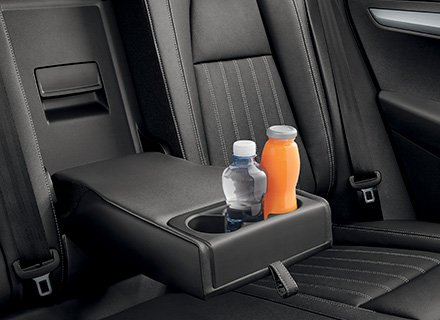

It wasn't attractive in the beginning, because the fixed seats didn't include the ski hatch / arm rest.
But now they do (or has it always been an optional extra?):
And it's a real arm rest, not just some kind of a hole in the luggage department one has to lean on with his entire body.
Also, a hard boot cover provides an additional storage space and a complete isolation of the boot, no matter how old-school it looks like.
But most importantly, the boot is bigger (521 vs 479 litres) without varioflex seats – not only the rear passenger space.
So, just like 19" alloy wheels and a sunroof, I think varioflex seats can often take away more than they actually provide.
For this reason, I would love to see Karoq with a fully flat cargo space without any seats being taken out.

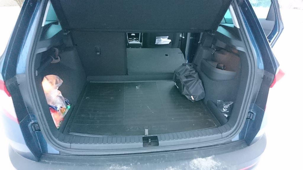

For 4x4 Karoq there is only space saver type of spare wheel available from factory. Here is the picture of 4x4 with narrow spare wheel, 2-side boot floor cover, no varioflex seat, no Canton.
In such case boot lip is 4-5 cm and I like it, asi t helps to keep some type of cargo fixed. With higher boot floor you would loose too much space also. Don´t forget to pull out headrests of backseats for few centimeters, it helps to get slightly more paralleel boot floor.
Edited by erikiri
