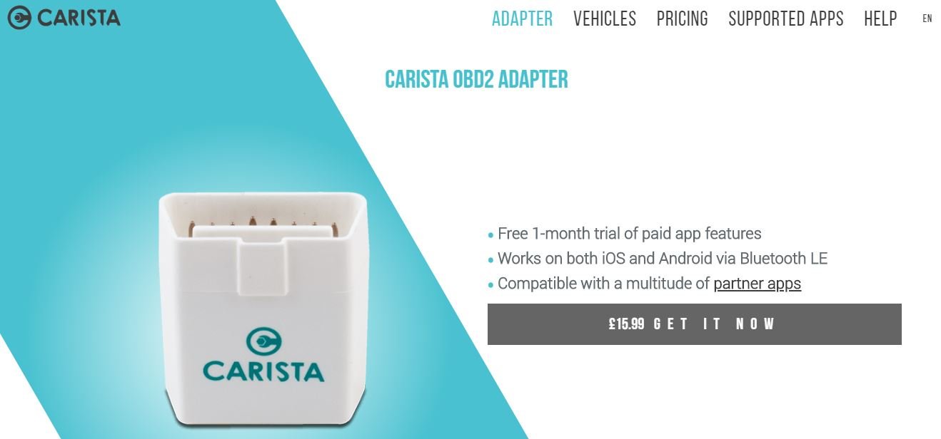

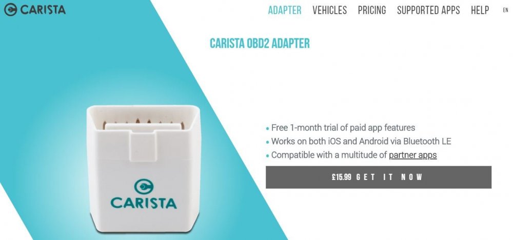

Just buy Carista and do it yourself. The genuine adaptor is a little more than the cheaper eBay options, but you get a 1 month free trial of the Carista app with it...
https://caristaapp.com/pricing
