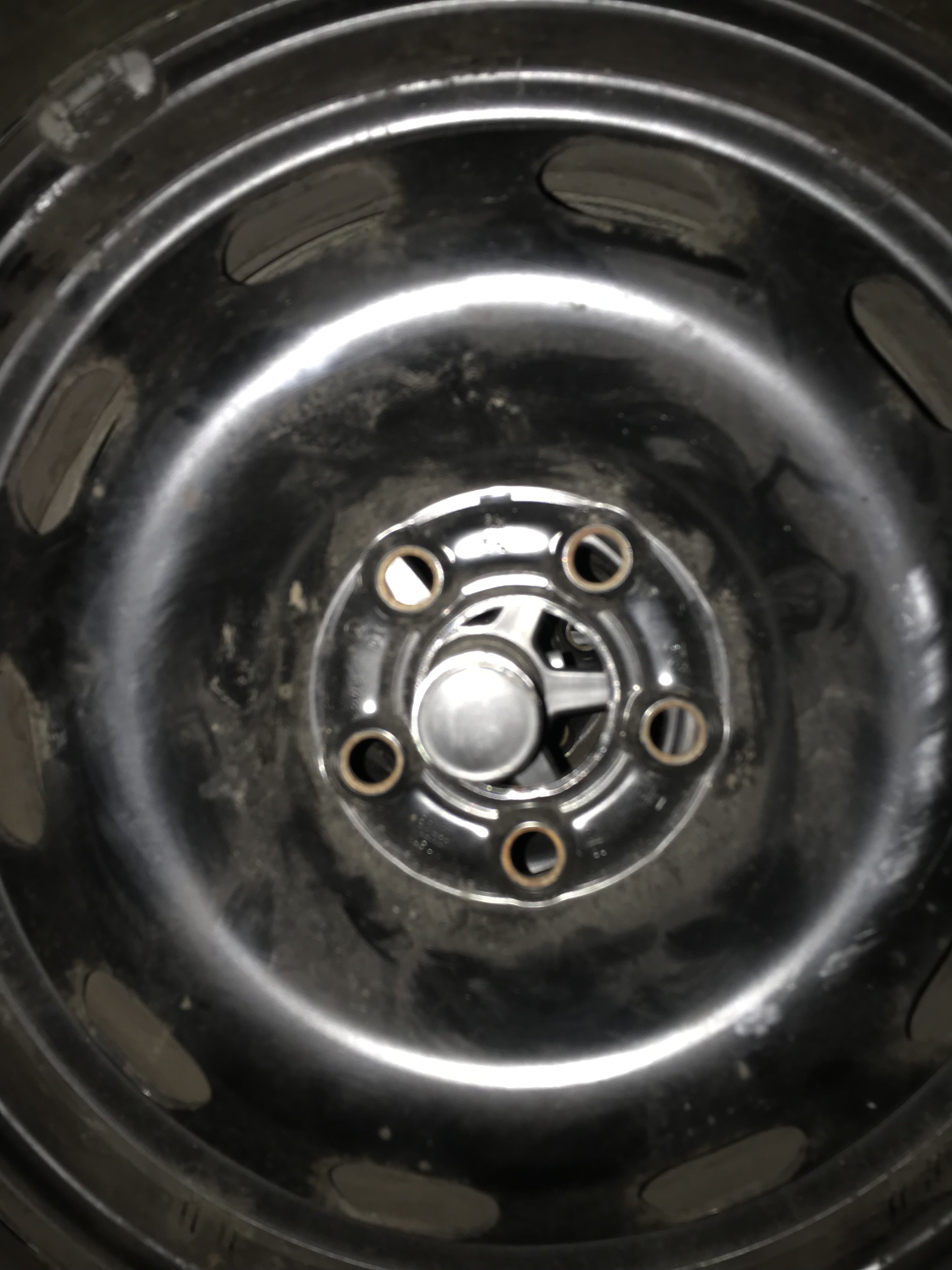

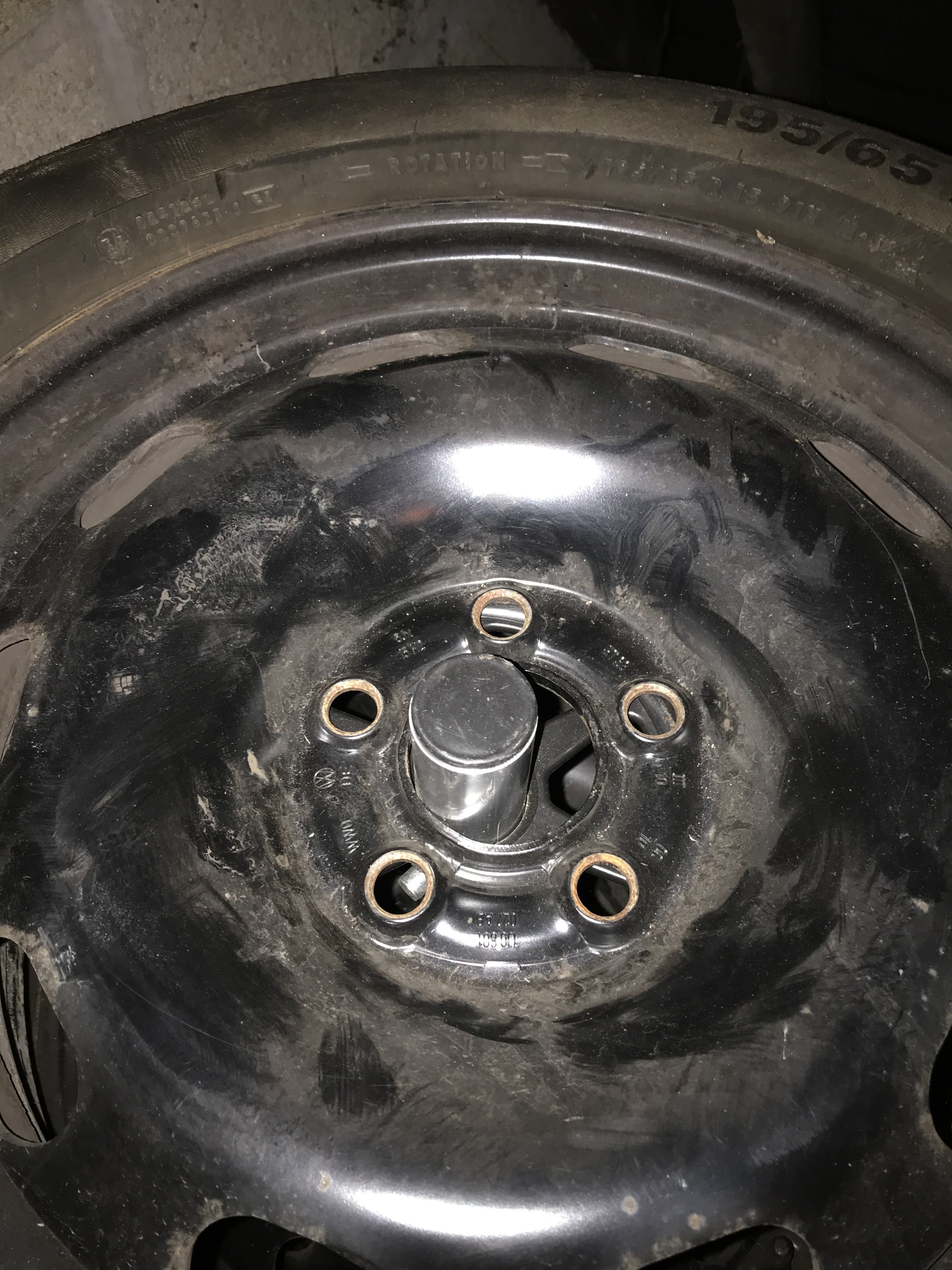

The Golf is a 2002 1.9TDI 100. Winter tyres 195/65/15 and the ET on the steel rims is ET38. Also written is 6Jx 15H2 and some more. See photo.

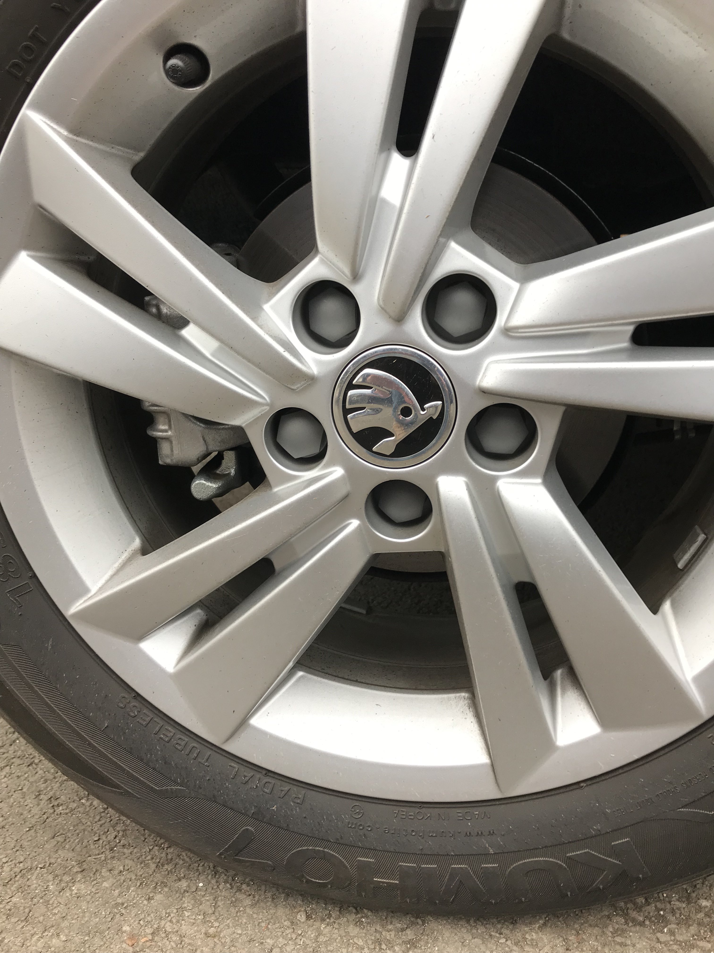

The Fabia is brand new with 215/45/16. It’s a Colour Edition. The standard wheels are 185/60/15. See photo below.

Here’s a better photo - sorry.
The wheels themselves are actually fine, as they are the same PCD and ET as the Skoda 15" standard wheels, so they will fit. However the tyres ,as said before, are too tall and will cause problems with the speedo reading and possible insurance problems as they are not a recommended fit.

The wheels are fine for the Fabia, the tyres are Octavia 2007-12 and Golf size. Get a set of 185/60/15 winter tyres, fit them to the rims and then flog the 195s.
