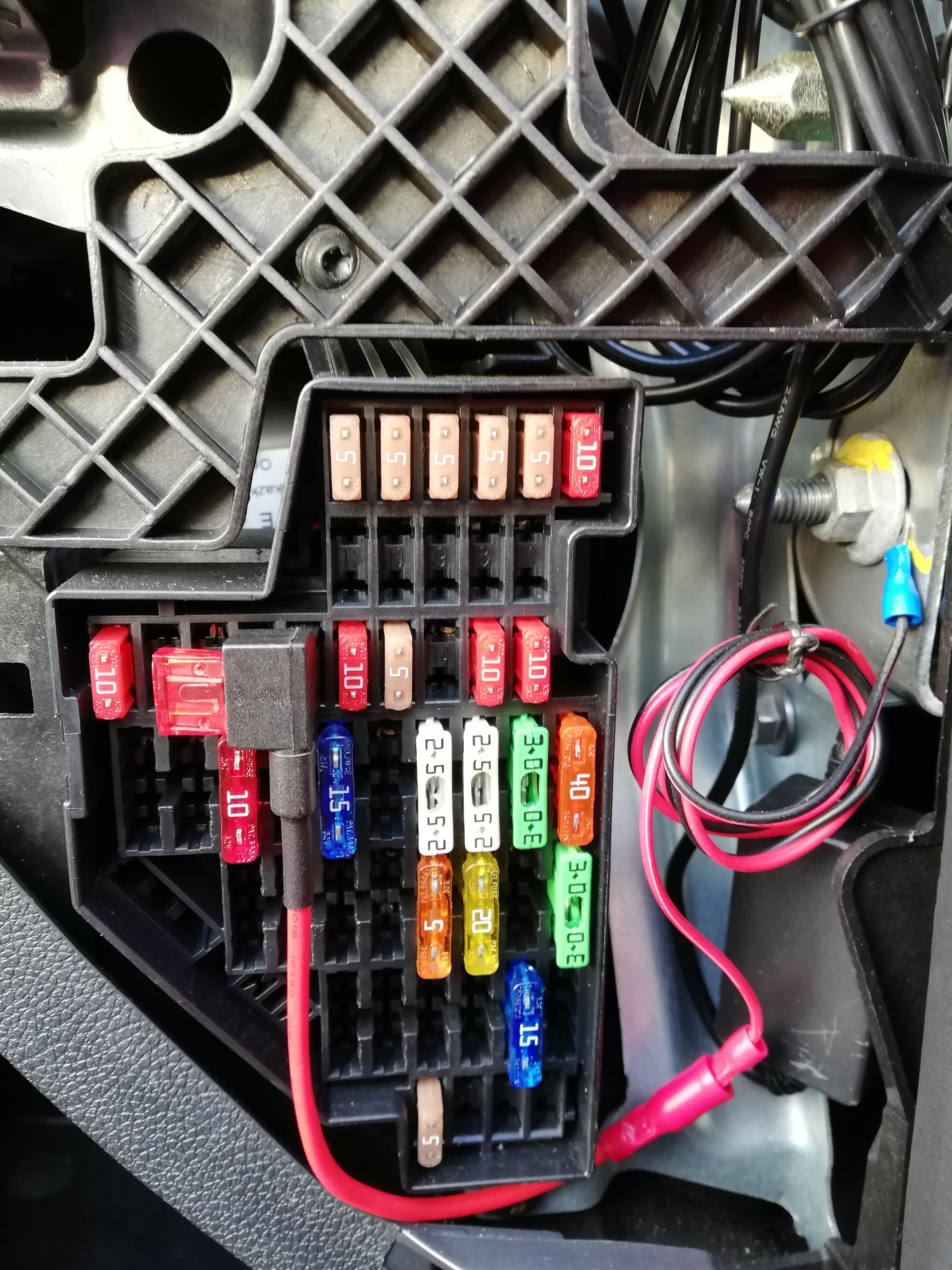

Out of interest do you have a pic showing which slot you used? Planning out putting one in mine very soon and I would like it wired the same way
There you go Pods. Number 17 on the fuse layout card. Though not sure if the layout will be exactly the same across all cars.
Watch out for the layout card as mine seems to be back to front. Scratched my head over that one for a bit.
Added bonus was I located the fuse for the headlight cleaning and pulled it so now when I spray the windscreen, my bonnet, wing mirrors and side windows stay soap free :biggrin:

Cheers Paddy
