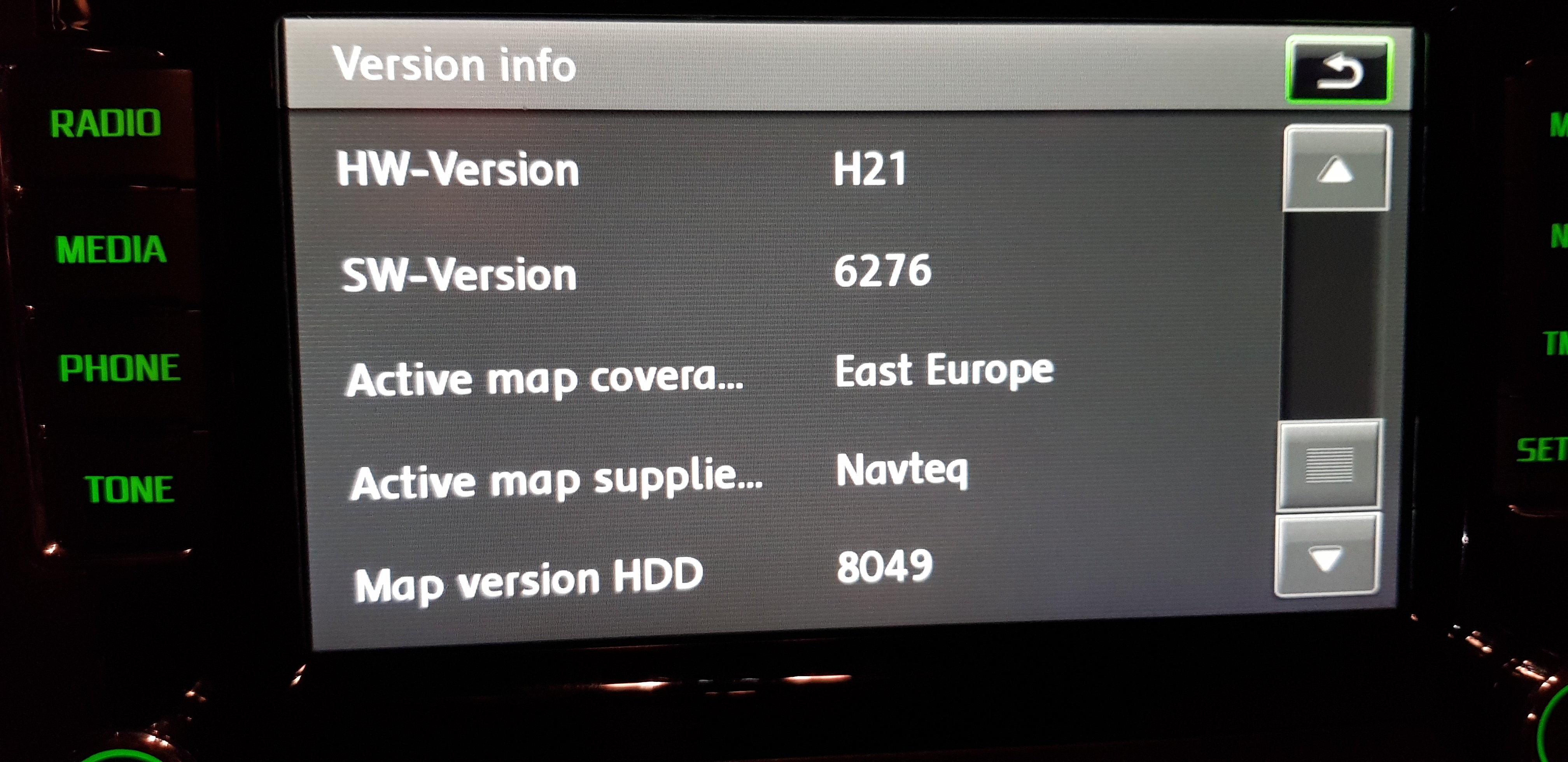

It just started and I got the version.
Where to find the software and how to reinstall it?
Please help
That's a similar unit to the one I had problems with. You might need to find software 6270 to install first which is a factory version (overwrites everything and deletes any errors etc. and starts again from fresh) because 6276 might just reinstall and keep ome or all of the error you have. You might also need service tools to wipe the existing software completely so it'll work.
