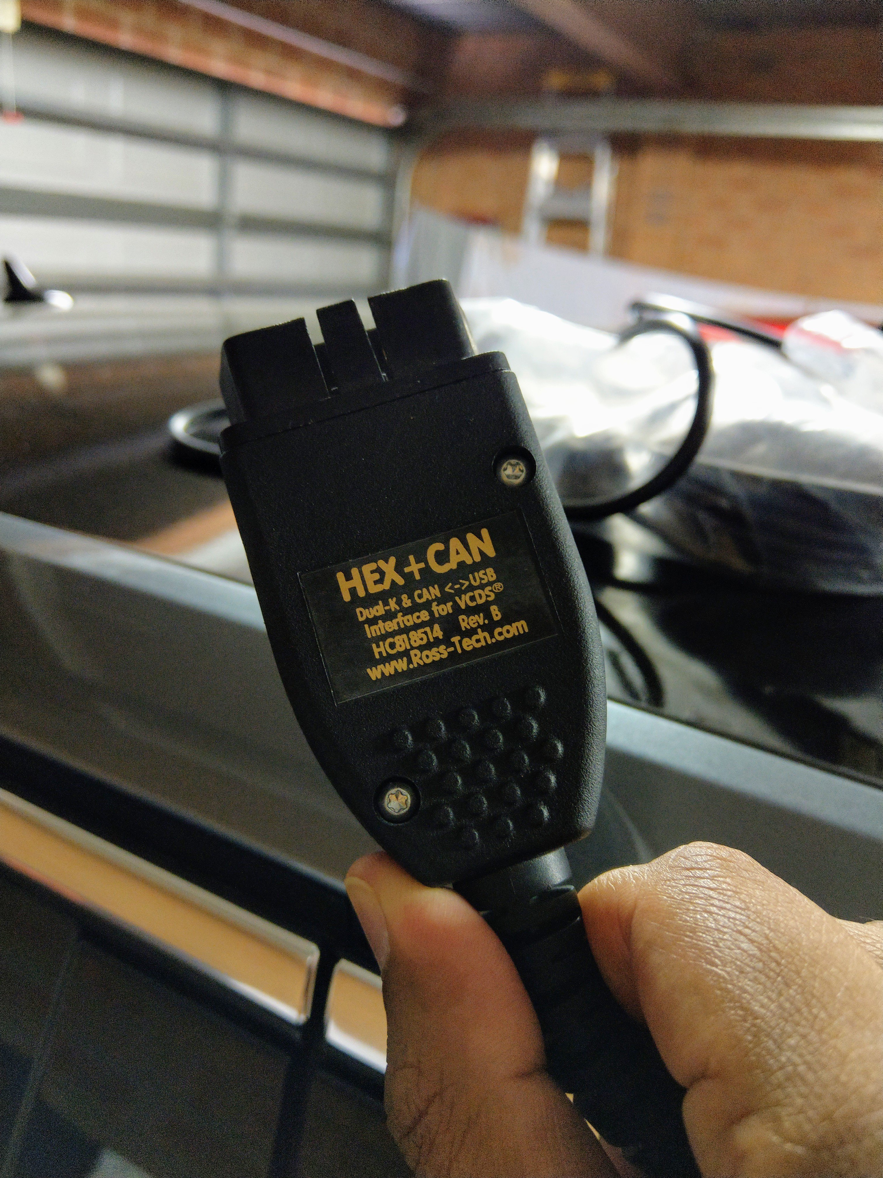

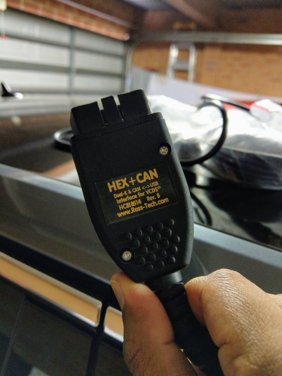

i'm using a Hex-Can cable.

Could it be that you need the newer cable for the newer modules?
I think that might b the case.
Might need either a HEX+NET or HEX v2 cable.
I'm using the HEX+CAN cable now.....
