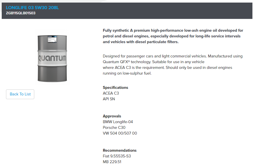

Who says dealers use Quantum Longlife oil?
I'm pretty certain mine doesn't. And I find they are reluctant to divulge beyond "long life" and I wouldn't trust them to tell me the truth anyway. I suspect only a couple of people actually know exactly what goes into their bulk tanks.
They will source the cheapest oil possible (that meets the required specs).
They do use Quantum and they also sell it at the service centres, Quantum is now made by Fusch so it's decent oil, I really can't see a VAG dealer throwing in some cheap TripleQX from ECP can you?
Cos' it's heavily subsidised.
My local dealer has huge 208 litre drums of the stuff in the workshop, I saw it through the MOT viewing window...

Yep that's the ones I have seen in the workshop on a trolley with pump, i really can't see them filling those back up with cheap oil.
Edit: In fact I know a guy that works in there I'll ask him now.
Edited by T2000
So great that for cheap servicing at not cheap prices Dealers use Quantum to VW 504/507,  5w 30 Full Synthetic Long Life.   Still nothing special.
