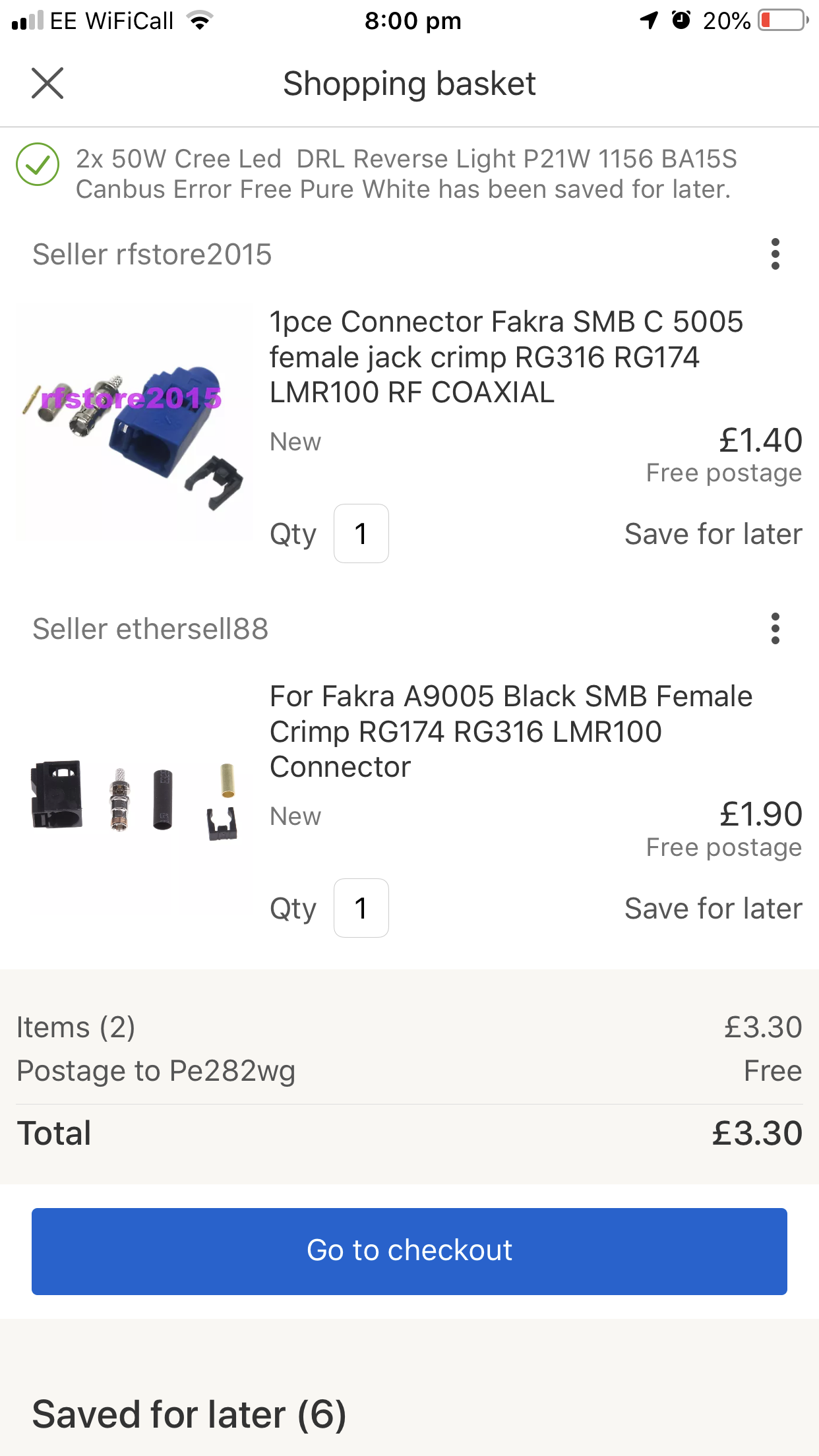

Ok. Thank you. Very helpful. So. Could I buy 2 each of these cable ends ( see photo )
and buy my own cable and make my own extenders ? If so. What’s the best cable to use for each. Anything to help with interference or signal loss ?
You might want to use 90 degree connectors for the headunit side as I'm not sure how much space is there.
Personally, I'd grab some from eBay or aliexpress unless you already have the right crimp tool. I think I used China-RF when I needed an rSAP extension.
They certainly have a 5m GPS one, you might need to ask about a DAB version: https://www.ebay.co.uk/itm/303031337865
Yes I have access to the correct tool so if I could save some pennies but getting diy to make my own. I won’t be complaining lol
i will ask them how much to make me up 2 cables I need with 90 deg ends.
