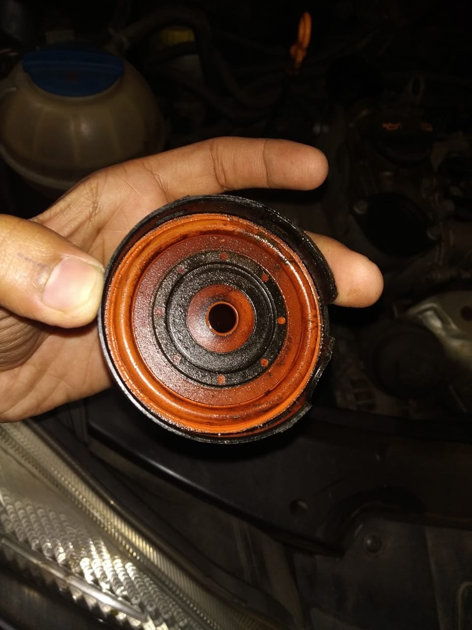

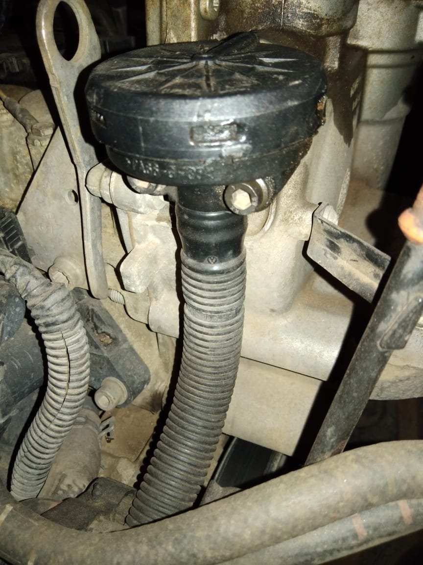

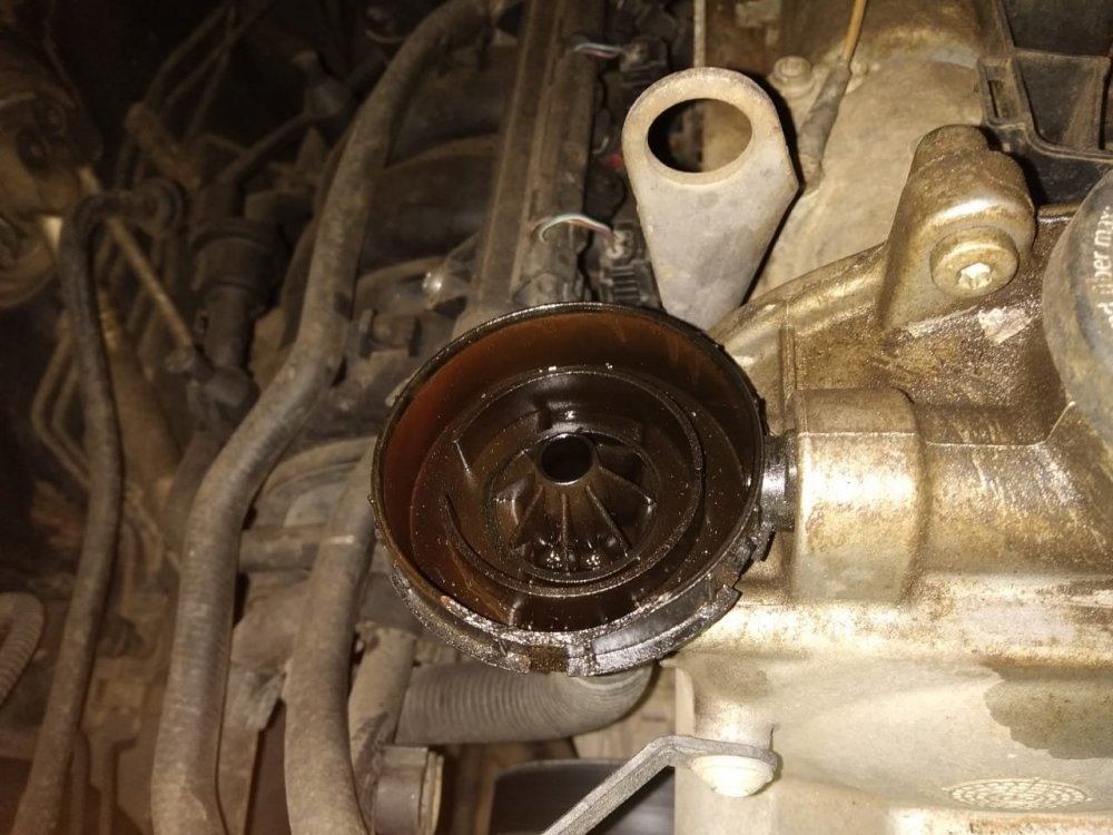

Crankcase breather broken cap
I have Skoda Fabia petrol 1.2 2009 model, my crankcase breather cap is broken and finding hard to find the replacement. I am wrapping up with aluminium tap for awhile and otherwise it will come out and my engine performance will go down and start shaking vigorously. I have trying few local stores but couldn't find it so far.
