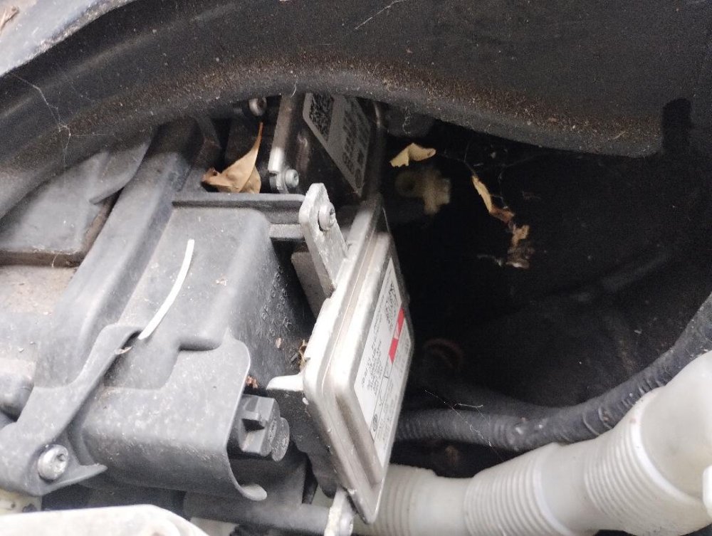

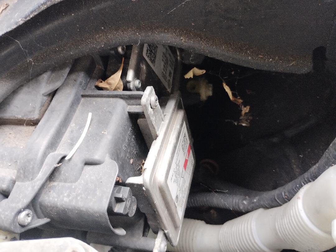

Hi there, it appears that on this forum, instructions around how to replace bi-xenon headlight bulbs range from a simple DIY to needing a garage. Much of what I have read refers to a round rubber cap that needs removing to access the bulb compartment. What if there are no visible round rubber caps and instead you see a metal plate lining at the back of the lamps (which appear to be ballasts - I understand that these bi-xenon bulbs need to have). How would you go about replacing the xenon bulb and is that an easy DIY job that can be done just by lifting the hood and working on the lamp unit or is there more to this (e.g. needing to remove the front bumper to remove the whole lamp unit or as I have also seen in some cases, removing the front wheels and the fender to access the lamp unit from underneath the wheel). I attach a picture of what my headlight back unit under the hood looks like - scratching my head to understand how to open it to access the bulb unit.
Any advice with this much appreciated.
Thank you.
If yours is a 2015 car, that makes it a facelift model. As I understand, replacing xenon bulbs on the mk2 facelift does involve bumper removal, and you need a D3S bulb instead of D1S.
I’m about to have a go replacing mine, but this is on a 2012 pre-facelift so should be easy.
@Dr_Mike_Oxgreen thank you for confirming this. The dealer has also confirmed my vehicle needs D3S bulbs. I am still pondering a DIY job on this if the bumper removal process is straightforward. I have a lot of tools so want to put them to good use. I am considering buying a workshop manual for this and other basic low risk DIY things I want to perform myself (all other bulb changes, air filter changes, cabin air filter changes, etc). I have been quoted £50 for such a manual (pdf form). Will probably give that a go.
