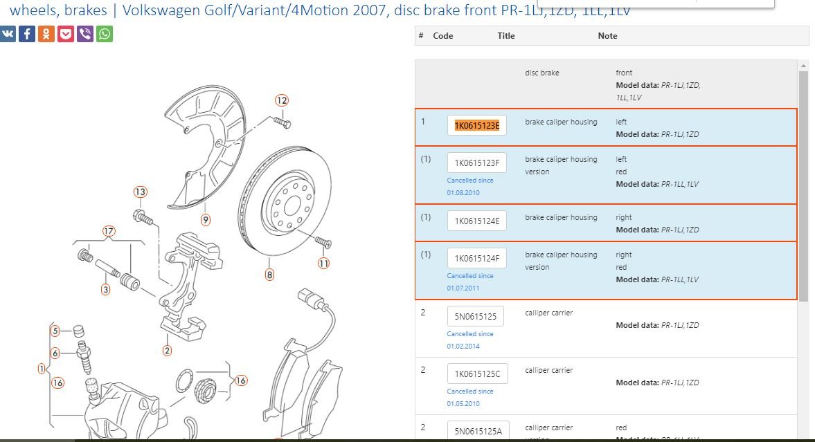

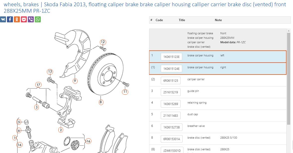

Allright guys!, i own a Fabia Combi 1.2 TSI 105 Combi 2013.
I want to do a front disc upgrade and have been googling around, but havent found a definent answer.
My car is born with the same calibers as a golf mk4, see the pictures.
So in my mind, i could just go and buy carriers off a golf (1K0615125C or 5N0615125) and get the disc off it as well, NO CALIBER.
But am i wrong in this?.
Just put decent fluid and pads in. Something like yellowstuff or pagid rs19s with Castrol SRF.
Im on the 288s and they are fine.
