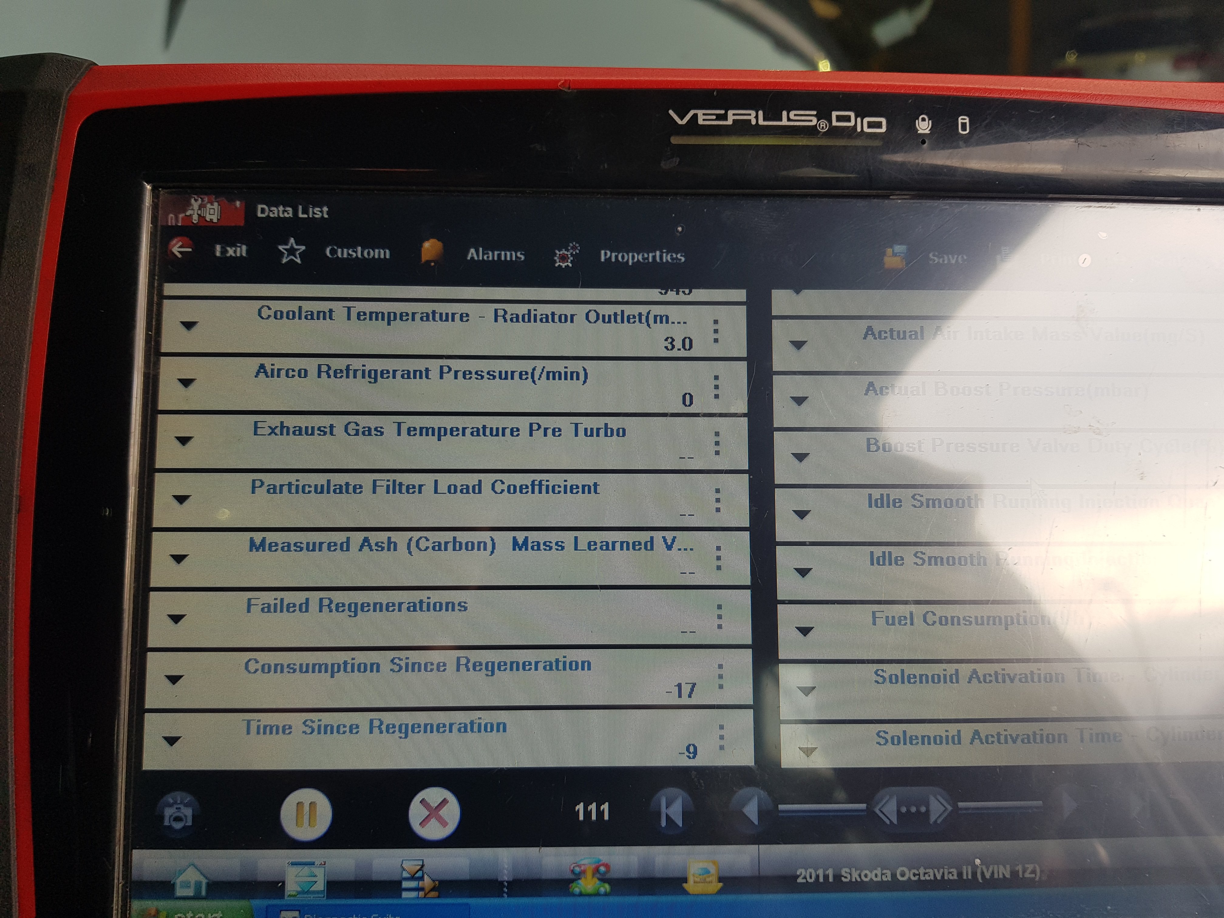

So guys i plugd it in and basicaly the cars not gettig any reading at all on some points around the dpf. The following is a pic i took of the ones that arnt getti g a reading at all. Just 2 dots. Mechanic said need an auto eleccy to have a look at ecu and fi d out why there is no reading coming at all even tho all sensors are plugged in.
I'd be tempted to say that whoever has cleaned your DPF hasn't reset everything accordingly so the ECU doesn't know what is going on.
So do we need to go inside the ecu and reset everything? Or will the auto mec know this when he pkugs it in

You've already identified the issue, the DPF sensors aren't reading or reporting any values. The likely affect of this is that the DPF isn't operating correctly.
Your high RPM at idle and smoke out of the exhaust are all pointing to the DPF.
