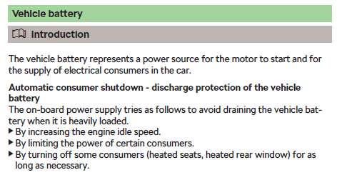

It seems that even with the engine running, if the car deems the state of the battery insufficient for certain electrical operations, they will in fact become inoperative...
