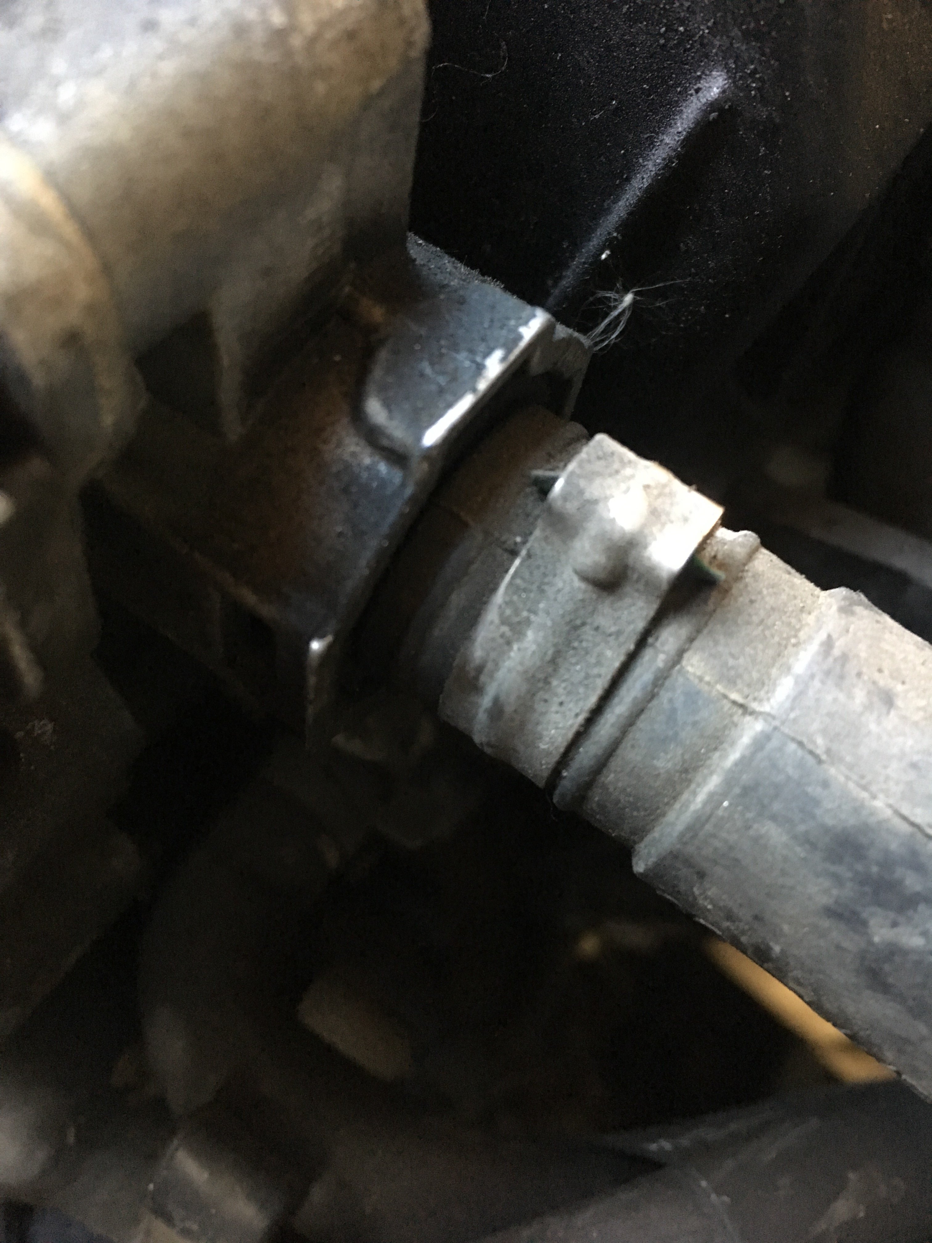

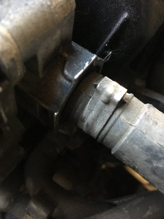

Bit of movement on the nipple on the tandem pump but does not appear to be leaking vacuum. Put a vacuum gauge on one of the smaller rubber hoses and reading good + feel strong vacuum by putting thumb on it.

I don't know what the picture is...

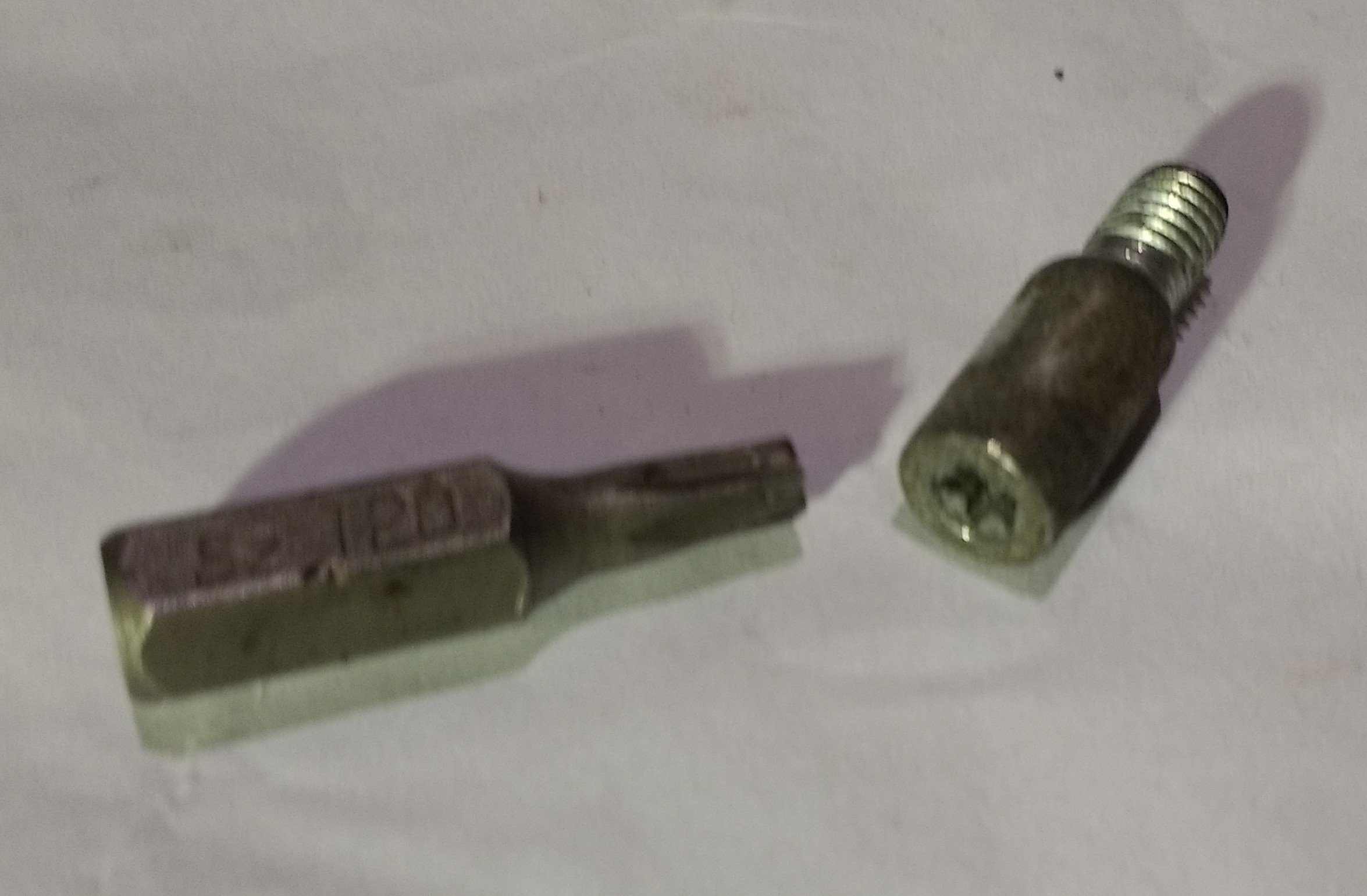

Here's what came off my Ate reservoir, completely redundant given the hold the rubber grommets have.
Torx 20.
IIRC I used a T20 bit secured in a ¼" ring spanner with masking tape to get access.
Torx 20.
Thats exactly what I was looking for, MicMac!
