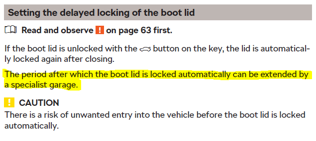

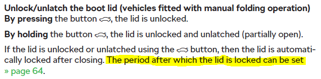

If you lock the car when leaving the car the boot is locked have never experienced or read about any boot lock delay.
Sounds like your dealer has already been fiddling with the settings prior to you collecting the vehicle?
The original settings should see the boot lock at the same time as the other doors, unless adjusted by a specialist garage i.e. a Skoda main dealer, or a previous owner with VCDS or similar.
The idea behind this feature is to prevent you from locking your keys in the boot/car. If the car is locked, and you open the boot using the central button on the keyfob, only the boot unlocks, all other doors remain locked, then when you shut the boot again, it automatically locks... and if you've put the keys down in the boot and forget to retrieve them, the boot automatically locks when you shut it. The delay is designed to give you time to remember your mistake and open the boot before it locks.
