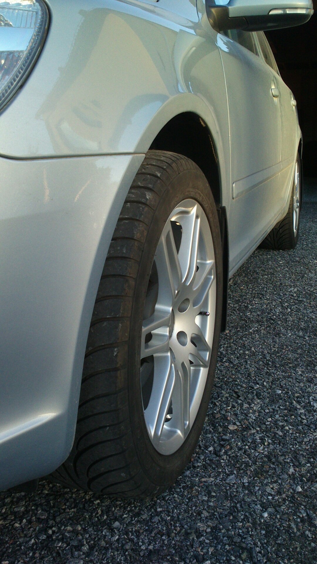

I had these for a period, Audi RS4 (I think) replica rims on my 2010 Octavia. Not the best quality, but I like the look. These are 7.5x17 with little wider tyres: 235/45-17. Sorry, the picture isn't the best.

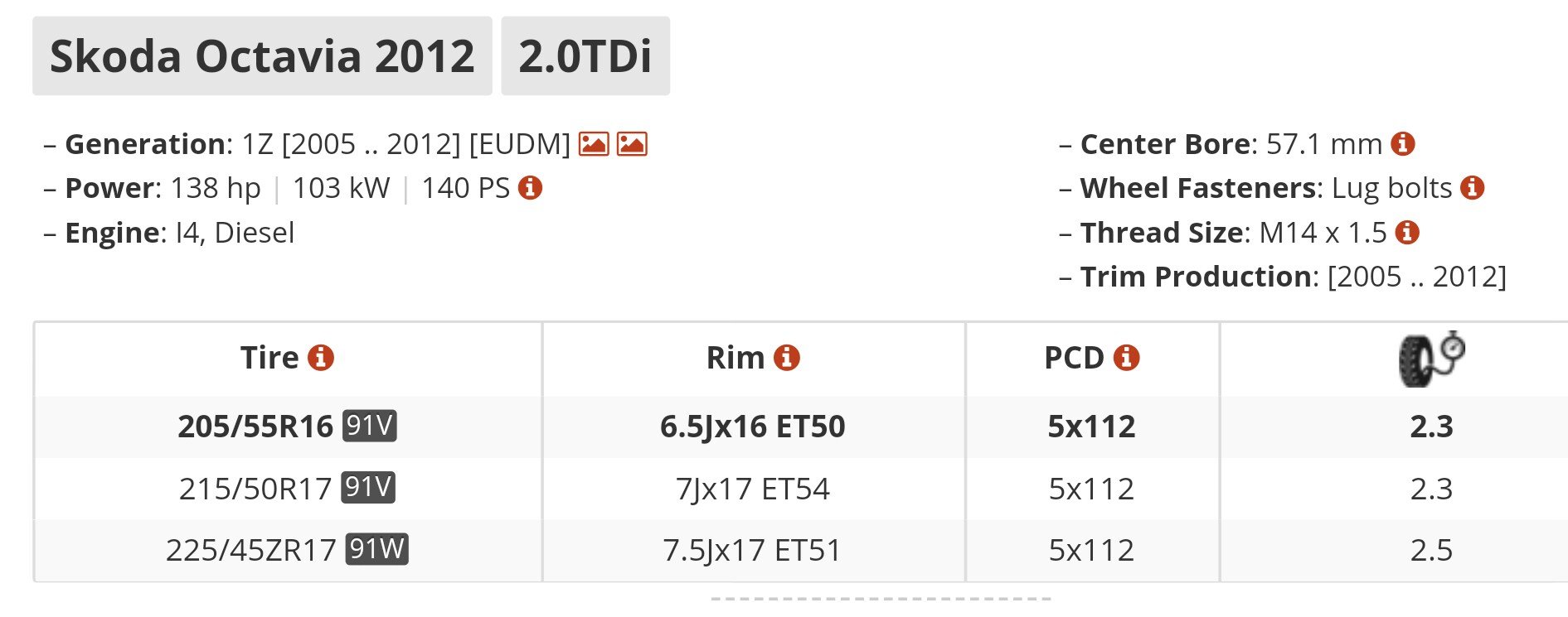

Should an ET 35-38 become a problem? Most of the wheels I've looked at are around those numbers..Willitfit shows that the setup with 225/45/17 tyres and  7" wide wheels with an ET 35 the outer rim would poke out about 24.7mm..according to this it should be alright? Or am I missing something else..
There isn't a clear answer to that. A extra poke of almost 25 mm is a lot, and you increase the track width with 50 mm. They will probably fit on the car, and at the rear it will be a nice fit.  But it's a little too deviation from original setup. You will strain the suspension, wheel bearings and steering more, and you will get more dirt on the sides. And then comes what is legal in your country, in Norway there are regulations which say how much you can change the original dimensions. You also tamper with the steering geometry, like the scrub radius (it gets really getting technical now but it has impact on driveability of the car). And that is not good.

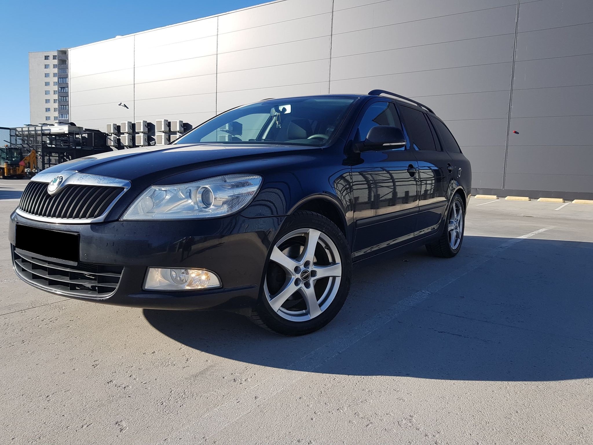

This is what I ended up with..17" rims with an ET 48. While the fronts are kind of perfectly aligned with the arches, the rear ones are tucked by a few cm. Would be trouble if the fronts were in the 30 range..
Tyres are 225/50/17 though. Speedo reading is much better. When I used to have a 10 kph difference at 100 kph, now it's only 2-3 kph, meaning if the speedo reads 100, then the actual is 97-98. So far I'm pleased.
