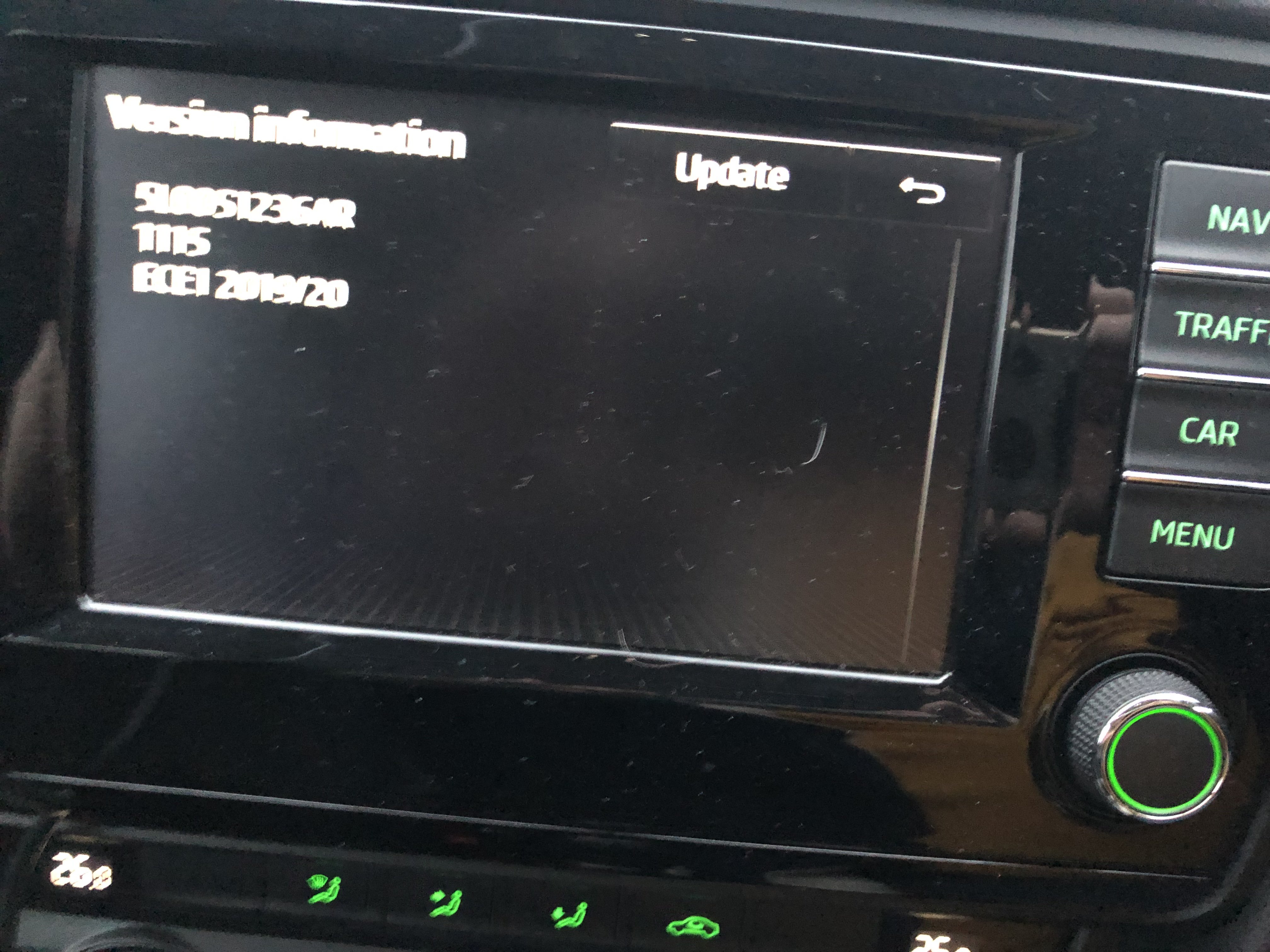

What software are you running? It’ll say when you go into system settings. They shipped with 0241 then 0245. Unless you have a problem with the nav unit I wouldn’t bother updating the firmware. You won’t gain any features on 0252 but the parking sensors are apparently more accurate.

I don’t know if that’s the right screenshot or not for the version??

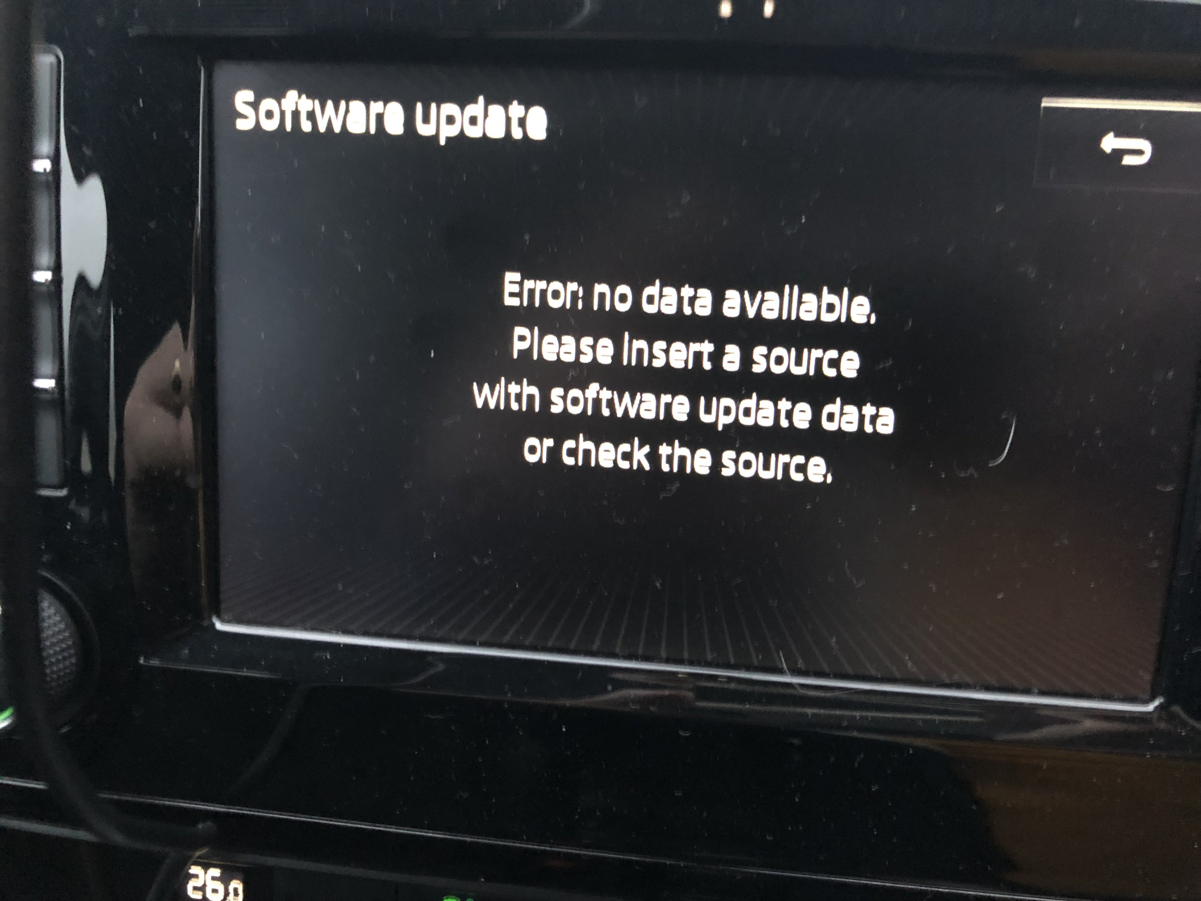

Btw if I press ‘update’ I get this:
Have you put the update files on a flash drive or SD?
You need the MIB1, MIB2 folders and metadata file in the root of the SD/flash drive for the system to pick it up.
