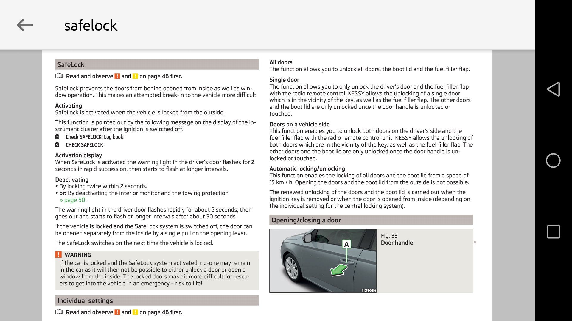

Then yet... See attached picture. The MFD points you to user manual... Try to read it and disable SafeLock if you can to see if problem persists.
