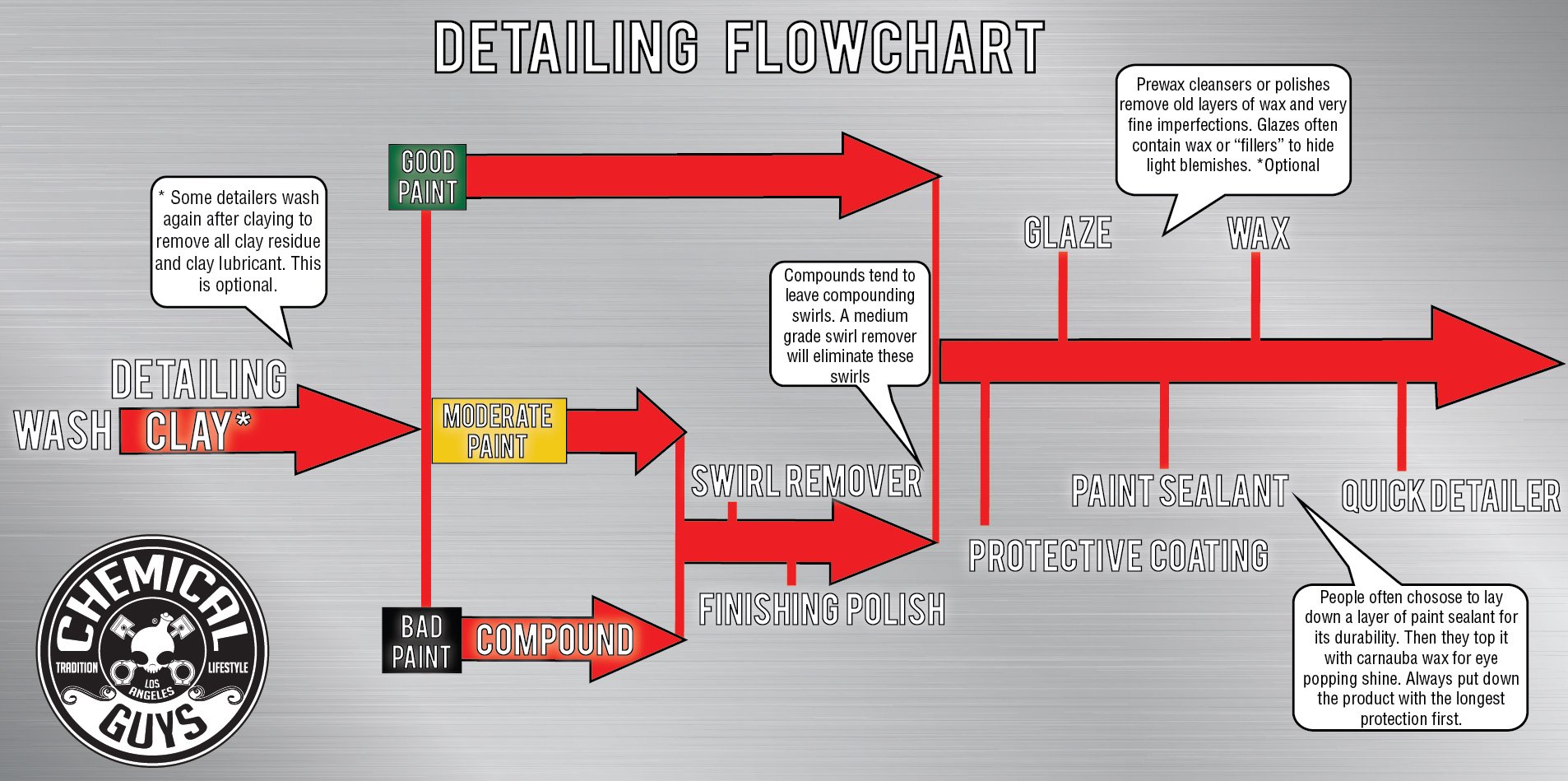

The wash flowchart is quite complex given the thread started on washing up liquid...!
The idea is that following polish, the longest lasting protection is applied first, finishing on wax.

This is more complex than I imagined! So wash then polish then wax then post wash sealant?
“Post wash” normally come under drying aids, and are spray on compounds that make the water bead up on contact and make drying easier.
Wax is always last - it lasts the shortest amount of time, and typically, anything on top of wax doesn’t stick to the paint.
