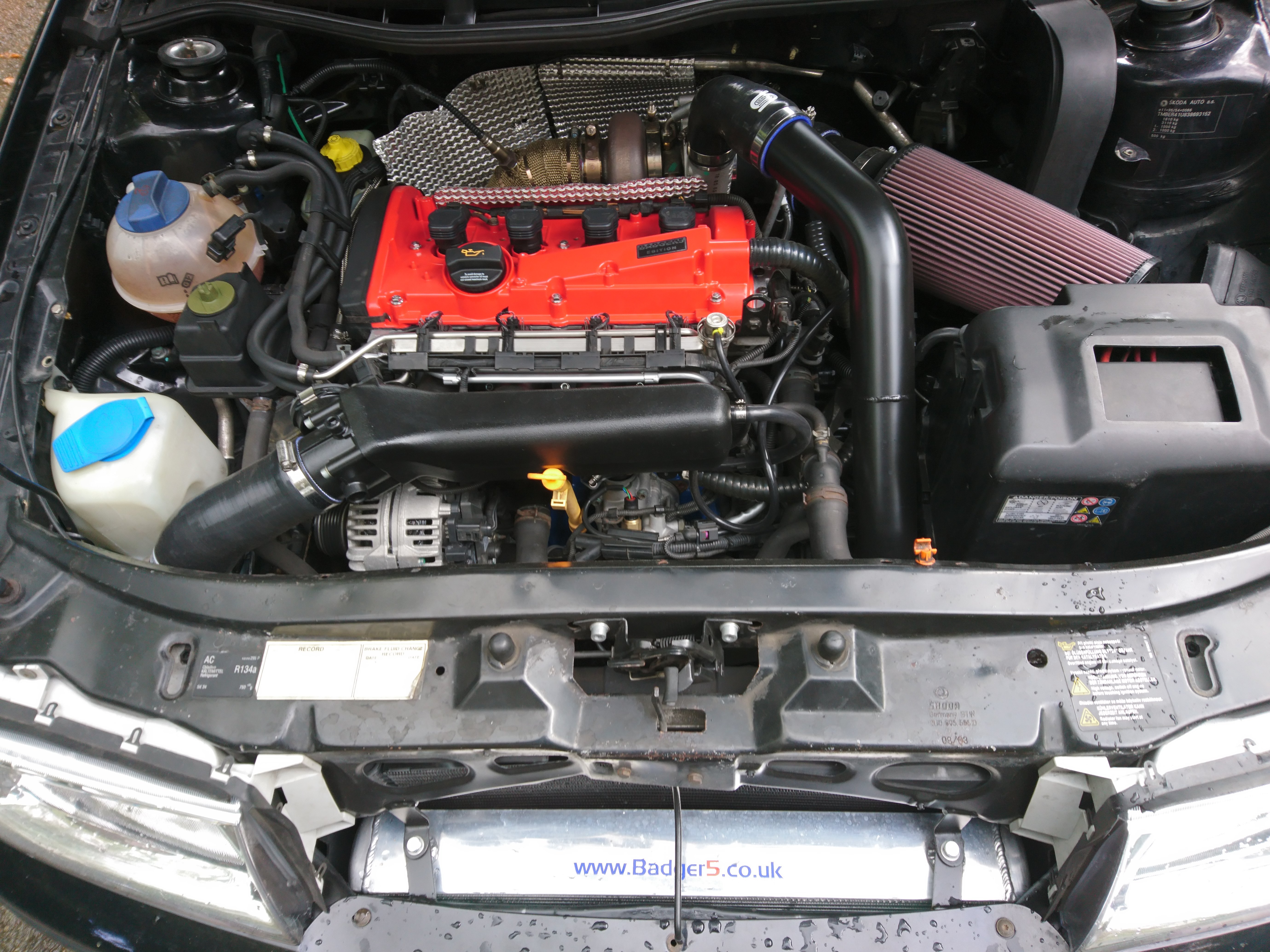

Hi Paul, Mine was to total strip down and reboar to a 2 Lt stroker, so just about everything has been replaced from front to  back, exhaust, gear box with a LSD etc. Most of the front end is off a Audi TT. It runs at around 530-550 bhp and has 4 changeable maps with the lowest at 380 bhp. The picture below is an old'ish one. I'm in the process of replacing the expansion tank, some of the plastic coolant fittings with ally ones, pipes, jubilee clips etc.. I wanted to do a few bits myself.
