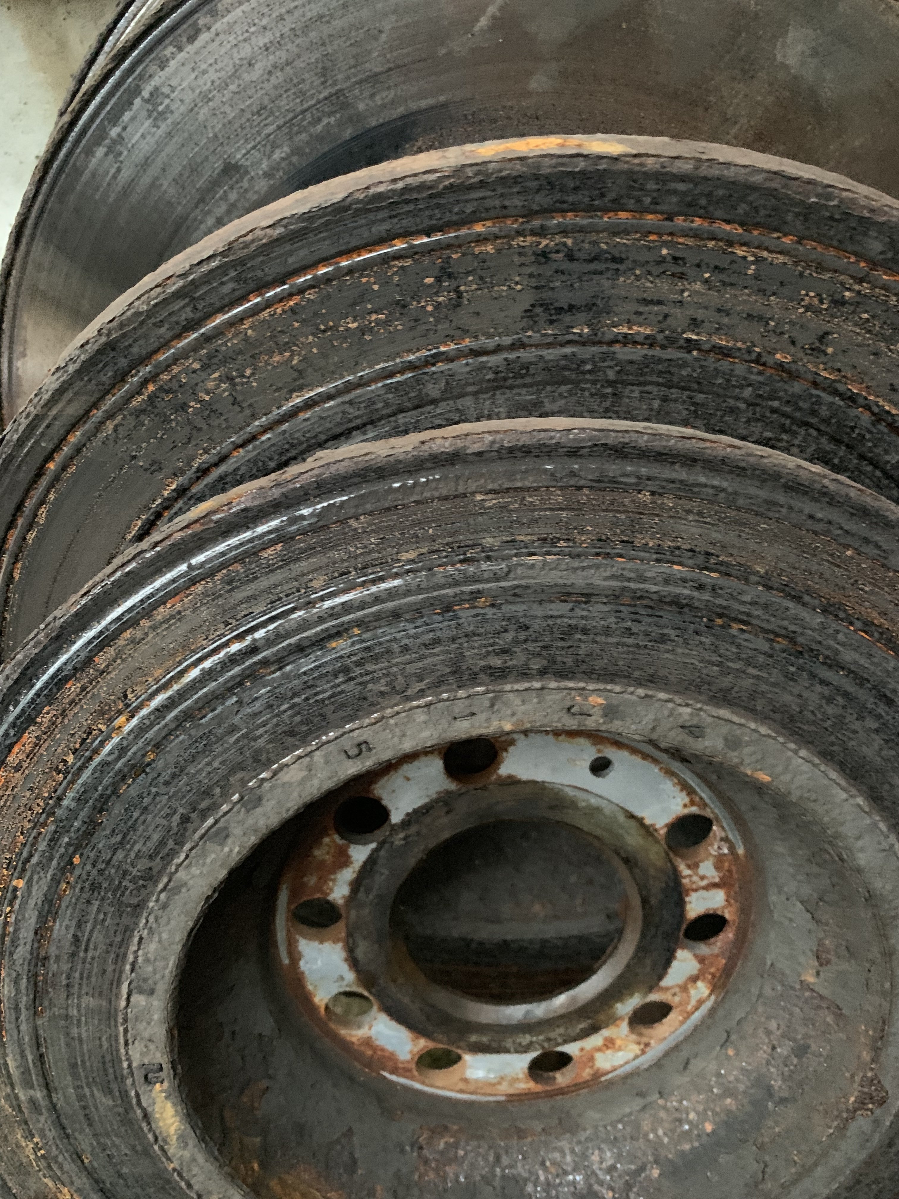

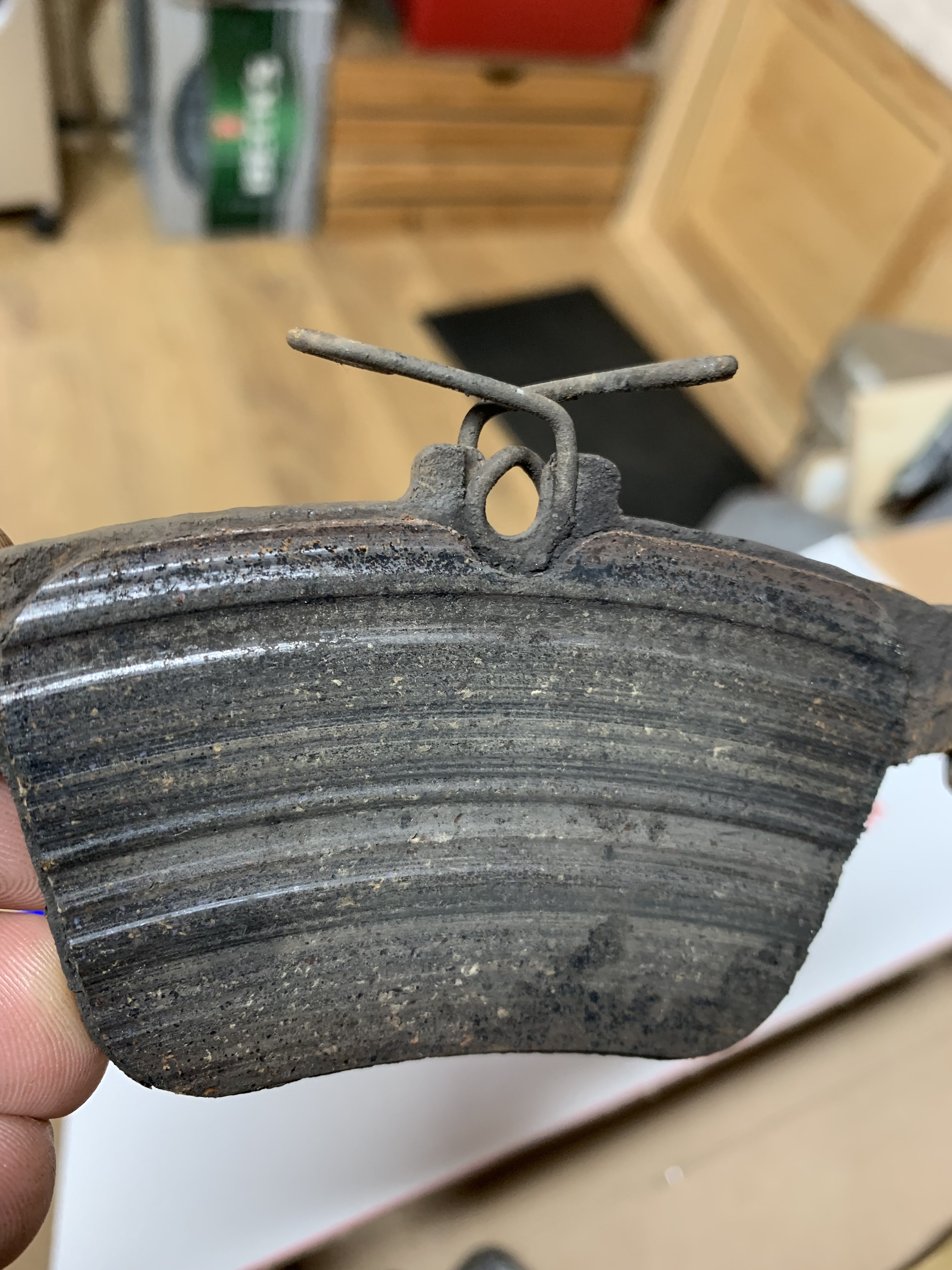

I changed mine over today (Brembo UV coated discs and pads)
The rears looked bad enough on the outside, the inside was even worse!
Not a great deal left on the rear pads:
These are 39 months and 52K miles old! (I usually get over 100k out of a set of discs)
The fronts (you can just see one of them in the top photo) was good enough to leave, but I changed them as well for piece of mind.
I used VCDS for the EPB, and a wind back tool for the rear pistons (you don’t need to remove the rear caliper carriers to change the discs)

Those rear discs and pads are truly grotesque.
Skoda must buy them from Poundland.
Keep us updated on the Brembos after you've racked up a decent mileage....
